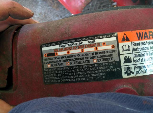

meadowfield 1,901 #4 Posted August 15, 2015 if the float sticks on them it fills the sump with petrol mark I think you might be onto something Nigel... Does anyone know if you can get the bits? I'm struggling to find anything, engine model 274826 doesn't show on the Briggs site... Share this post Link to post Share on other sites
Wristpin 400 #5 Posted August 16, 2015 Nigel's diagnosis is almost certainly correct - a common problem with gravity fed fuel systems. That Briggs number looks a bit suspect, can you post the full Model, Type and Code numbers?. Also, there should be an MTD model sticker either on the underside of the seat or on the chassis below the seat. Shouldn't be a problem with either the Briggs parts or the MTD / Lawnflite parts. Share this post Link to post Share on other sites

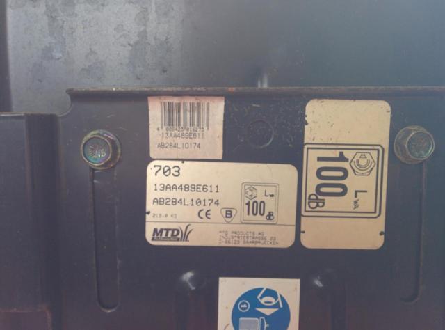

meadowfield 1,901 #10 Posted August 17, 2015 heres what i have if it's any help plus engine cowl sticker cheers Share this post Link to post Share on other sites
nigel 1,881 #11 Posted August 17, 2015 bits should be easy to get for that mark, what are you looking for, is it a 12hp have you a pict of the top of the cowling Share this post Link to post Share on other sites
Wristpin 400 #12 Posted August 17, 2015 That cowling sticker with family name numbers is a bit misleading, what is needed is the three sets of numbers under the words Model, Type and Code. On older engines they were stamped into the cowling above the spark plug , then later on a riveted on tag or on some overhead valve engines stamped into the rocker covers. if you should need engine parts they are essential. Share this post Link to post Share on other sites
meadowfield 1,901 #13 Posted August 17, 2015 I got the kids to take the pics, will see if they can find the plate. 272's used to be 11hp, but are now rated at 12hp nigel. It's a walbro carb it that helps? Share this post Link to post Share on other sites
Wristpin 400 #14 Posted August 17, 2015 Should have said, your 13AA number makes it a 2004 model 703. Parts should not be a problem . Lawnflites tend to be very fussy about belts - use genuine. Share this post Link to post Share on other sites
