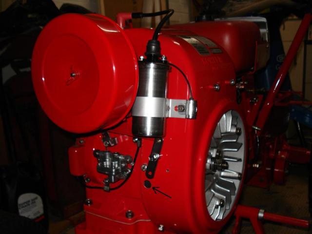

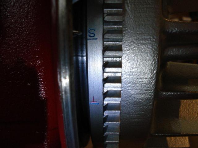

bubbalove 54 #15 Posted October 8, 2015 if someone has had this engine to bits before is it possible that the timing is out on the cam also the book says that the fly wheel should have a "T" and "S" on it for timing I cannot find either but I do find a thick groove/line next to a faint line would that be the timing mark for tdc these grooves are behind the teeth on the flywheel visible through the hole rh side of the carb at the bottom thanks tom Share this post Link to post Share on other sites

meadowfield 1,901 #17 Posted October 8, 2015 the timing is clearly marked on the gears, my pic above shows one of the marks. I have been buying from Kevin at bakt4kids - his stuff is a mix of genuine and copy but very good quality. 1 HeadExam reacted to this Share this post Link to post Share on other sites
