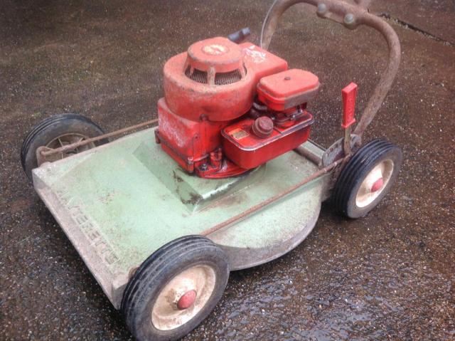

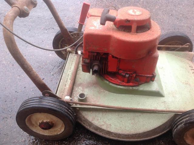

Triumph66 1,256 #1 Posted January 18, 2016 As I was working at home doing some odd jobs, I decided to have a look at this Hayter just a few minutes away from me. The old chap had it for years and until recently he had it at his property in Brittany. His father owned it prior to him. Also came with the original instructions manual. My plan was to use the engine on my Bolens Lawn Keeper but have decided against it as it seem a shame to dismantle it. It's currently has no sparks so I am hoping a clean of the points and armature will sort that out. My plan is to give it a thorough clean, service and treat with Owatrol. I got a small job in mind later this year to mow at a customer's. Anyone know where I can get an exhaust or silencer? Photos of the Hayter as found. I will take some more once it's serviced and cleaned up. 1 wurzel reacted to this Share this post Link to post Share on other sites

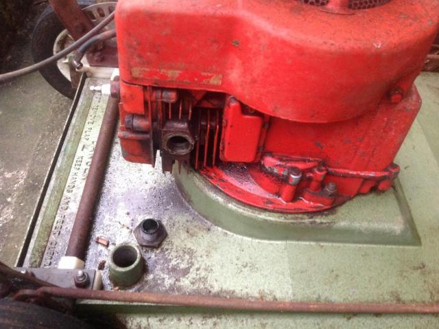

Triumph66 1,256 #11 Posted January 21, 2016 I have been servicing several of my customers' modern lawn mowers today so took the opportunity to loosen the remains of the exhaust/silencer. I sprayed some Loctite freezing agent onto the nut throughout the day. I had to cut off some of the exhaust so I could get my socket onto it. After an audible clicked, it loosened up nicely. I was able to unwind it by hand. Results! Now going to order an exhaust for it. 2 Anglo Traction and nigel reacted to this Share this post Link to post Share on other sites
