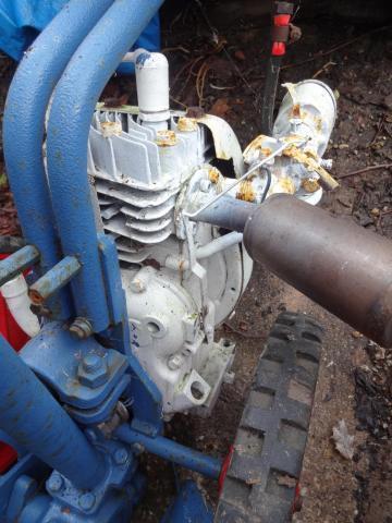

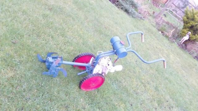

zipfelmuetze 7 #1 Posted January 21, 2016 Hi, my name is Stephan and I am new here. I live in Suffolk (originally from Germany) and recently I bought a Versatiller on ebay (some of you might have seen it). It is in good shape but needs some TLC before it can do it`s job in the garden. I`m about to heat up the shed and was wondering if someone could help me out with repair manuals or spare part lists before I take it apart? I was also wondering what kind of engine it is (can`t find any plates or stickers). Cheers, Stephan 2 Triumph66 and pmackellow reacted to this Share this post Link to post Share on other sites

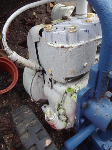

Stormin 4,458 #2 Posted January 21, 2016 'Ow do, Stephan. That looks quite tidy. You've come you the right place. Someone will be along to help you out. A better photo' of the engine would be handy. Share this post Link to post Share on other sites
C-101plowerpower 548 #3 Posted January 21, 2016 welcome aboard, engine looks like a briggs, cant tell for sure, a better photo of the engine would be handy Share this post Link to post Share on other sites
nigel 1,881 #4 Posted January 21, 2016 welcome aboard stephen, it looks like a briggs engine but very hard to see from your photo Share this post Link to post Share on other sites
Wristpin 400 #5 Posted January 21, 2016 Looks like I'm in the minority but I thought Aspera / Tecumseh. Share this post Link to post Share on other sites
meadowfield 1,901 #6 Posted January 21, 2016 Hey Stephan, welcome to mom, someone will no doubt sort you out! Share this post Link to post Share on other sites
nigel 1,881 #7 Posted January 21, 2016 Looks like I'm in the minority but I thought Aspera / Tecumseh. um! you could well be right there Angus Share this post Link to post Share on other sites
zipfelmuetze 7 #8 Posted January 21, 2016 Thank You all for this warm welcome - it is much appreciated! I will post some good pictures of the engine during the weekend when I´m home again. Cheers, Steph Share this post Link to post Share on other sites
Anglo Traction 1,018 #9 Posted January 21, 2016 Welcome Stephan (Like your Username meaning ). Nice Project there, a few parts to obtain I see. I tend to also suspect it is a Techy Engine with an unusual Air Filter?. Carbureter on them can be a challenge to set on some versions, but Engine Manual is available to download and some parts still available. Look forward to seeing it running and working. Share this post Link to post Share on other sites
S1g 579 #10 Posted January 21, 2016 It's definatley an aspera/ Tecumseh Share this post Link to post Share on other sites

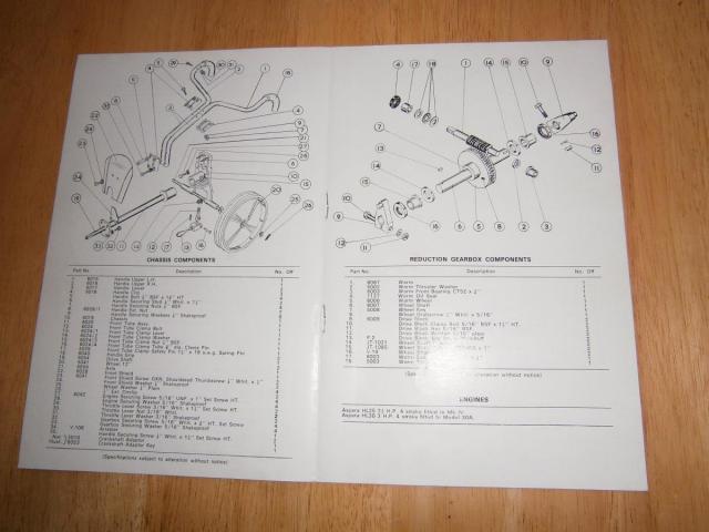

pmackellow 2,738 #11 Posted January 21, 2016 Hello Stephan and welcome to MOM That's a Versatiller Mark 4 and the engine should be an Aspera/Tecumseh I have a small manual for the machine and I might have some engine literature I will have a look Looks like your machine is missing the cowling/guard in front of the engine, looks a tidy machine though Share this post Link to post Share on other sites
Wristpin 400 #12 Posted January 21, 2016 Welcome Stephan (Like your Username meaning ). Nice Project there, a few parts to obtain I see. I tend to also suspect it is a Techy Engine with an unusual Air Filter?. Carbureter on them can be a challenge to set on some versions, but Engine Manual is available to download and some parts still available. Look forward to seeing it running and working. It wasn't so much the carb itself that was the issue but the lack of support in the way it was mounted leading to warped manifold flanges and air leaks etc. The Asperas of the day, had a reputation for poor starting but it was nearly always down to a combination of air leaks and lack of valve maintenance. Correctly maintained they were fine and the vertical shaft models had pressure lubrication while Briggs continued with splash for years. As far as I can see, the unusual air cleaner was the standard one for the day - an oval tin can with a sponge in it; a similar one, turned through ninety degrees was used on all the early two stroke Flymos. Now Stephan will tell us that it's a Clinton! Share this post Link to post Share on other sites

DevonianRedneck 86 #16 Posted January 22, 2016 from experience no compression tend to caused by a stuck exhaust valve on an aspera, every aspera i've worked on had this problem, (cept one) caused by a small piece of metal holding the valve open, which at the time i thought maybe a piece of exhaust baffle, (low quality component?) never been a fan of techy/aspera engine's there fine if well maintained but don't tolerate any abuse well, Share this post Link to post Share on other sites
Wristpin 400 #17 Posted January 22, 2016 Certainly most Asperas of a certain age will repay a proper valve job - refaced valves and skimmed seats, BUT be careful to have the cam correctly positioned when checking / setting the valve clearances . The piston needs to be a quarter of an inch down the bore on the power stroke. Get it wrong and gap the valve when it is still on the decompressor and it will BITE!! 1 S1g reacted to this Share this post Link to post Share on other sites

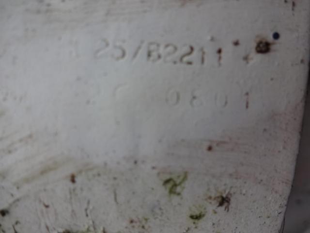

zipfelmuetze 7 #18 Posted January 23, 2016 Here we go - I even found some kind of plate with numbers on it! 1 pmackellow reacted to this Share this post Link to post Share on other sites
C-101plowerpower 548 #19 Posted January 23, 2016 yep that's an aspera Share this post Link to post Share on other sites
zipfelmuetze 7 #20 Posted January 23, 2016 yep that's an aspera Is that good news or bad news ? Share this post Link to post Share on other sites
pmackellow 2,738 #21 Posted January 23, 2016 Here's the manual, not the right engine info but Anglo Traction will hopefully point you to an online download Private Message me with a name & address and I will put a copy in the post for you, scanner u/s on my printer so I will do you a paper copy 1 nigel reacted to this Share this post Link to post Share on other sites

zipfelmuetze 7 #24 Posted January 23, 2016 Here's the manual, not the right engine info but Anglo Traction will hopefully point you to an online download Private Message me with a name & address and I will put a copy in the post for you, scanner u/s on my printer so I will do you a paper copy WOW ! That´s exactly what I was looking for PM is on it´s way! Cheers, Steph Share this post Link to post Share on other sites
