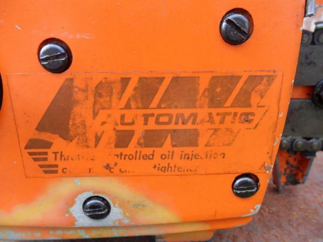

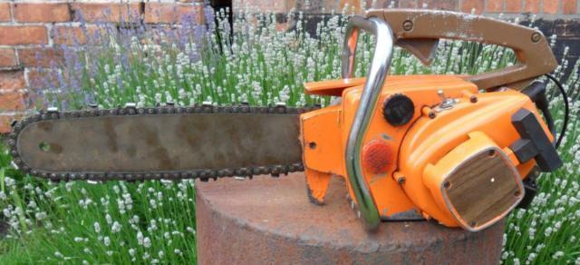

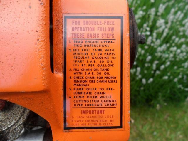

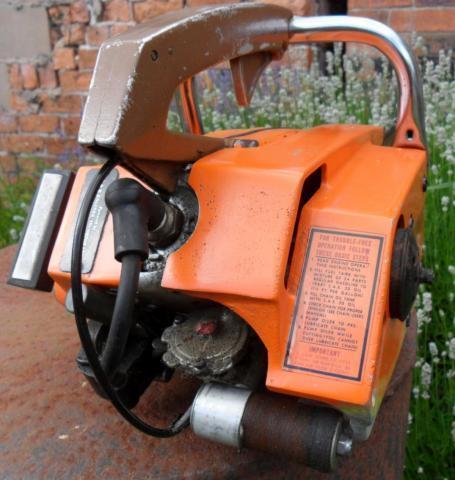

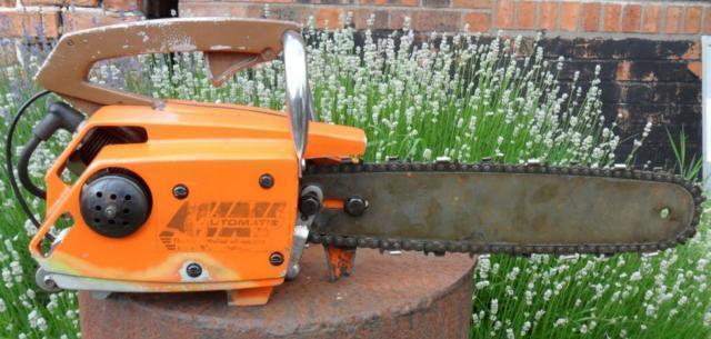

factory 487 #5 Posted February 7, 2016 Here is a advert from 1973 found online that has two O&R powered Lancaster chainsaws, the 20SLA Automatic that Lee has and the 15SLA Mini Automatic that I have. Also attached are some pictures of my smaller Lancaster 15SLA Mini Automatic with the 13B engine. The air filter is different to the standard ones fitted to O&R's, also the instructions aren't quite right as the chain oiler is automatic. David 4 Triumph66, pmackellow, Lee and 1 other reacted to this Share this post Link to post Share on other sites

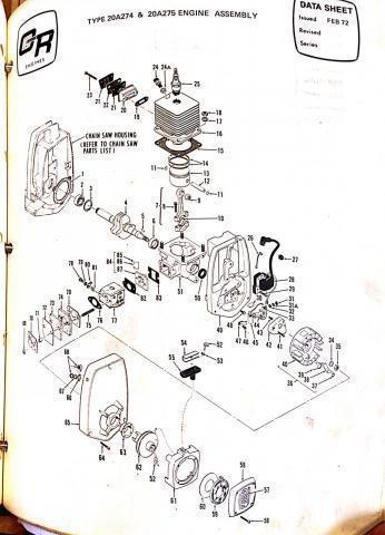

Wallfish 718 #9 Posted February 13, 2016 I'm assuming this is a 20A engine. Here is a diagram of what I have. Let me know if you would like a better copy with a parts list and I can email one to you. 2 pmackellow and Lee reacted to this Share this post Link to post Share on other sites

Lee 3 #12 Posted February 21, 2016 (edited) I'm assuming this is a 20A engine. Here is a diagram of what I have. Let me know if you would like a better copy with a parts list and I can email one to you. Wow thank You , I put it together tonight and just came in from garage to see what the points get set at and seen you diagram and it appears I got everything together wright. Just need to set points which I currently have set at 14 but have not seen a setting for them yet.I did check for spark and it is getting a nice blue spark.To late to run it because my garage is about 20 feet from a neighbors bedroom that is just across the alley. Ill take you up on the email of the parts list at your convenience. Does it say what the points get set at and the setting for the mag to flywheel clearance. Edited February 21, 2016 by Lee Share this post Link to post Share on other sites
