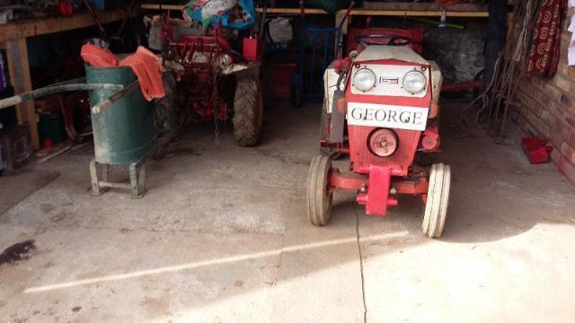

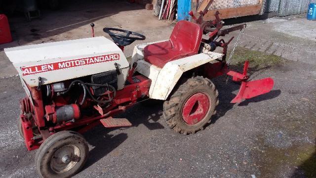

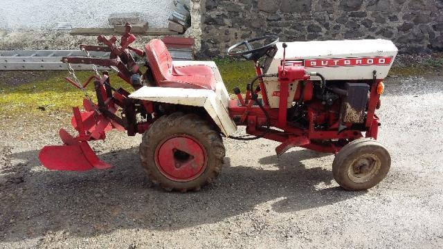

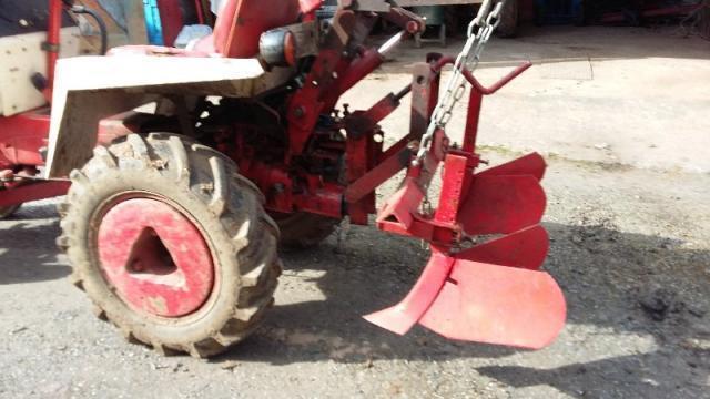

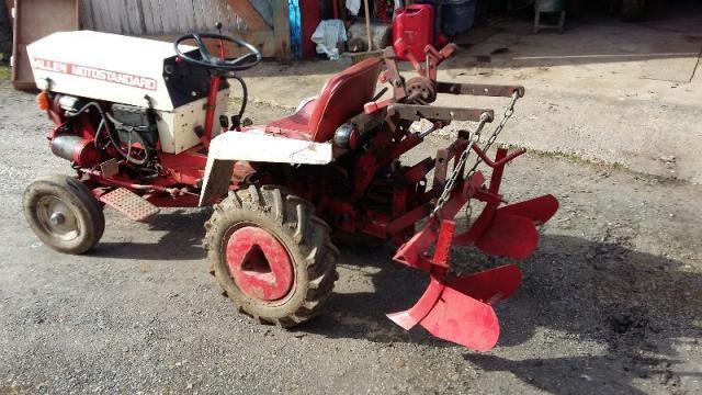

The Fife Plooman 632 #1 Posted March 25, 2016 Hi All One or two pics of my Gutbrod 1032 getting ready for the season the ploughs are set at 24 inches the same as the front tire centres 8 4x4forks, Triumph66, expeatfarmer and 5 others reacted to this Share this post Link to post Share on other sites

nigel 1,881 #3 Posted March 25, 2016 Why has that tractor got motor standard on one side and gutbrod on the other george Share this post Link to post Share on other sites

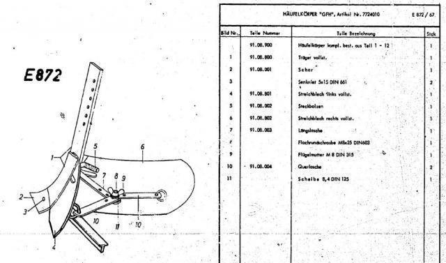

GAV694 23 #6 Posted March 26, 2016 Looking good George, here are the parts drawings showing the linkage etc Share this post Link to post Share on other sites
The Fife Plooman 632 #7 Posted March 26, 2016 Hi Nigel Gutbrod is the name of the tractor and Allan Motostandard was the firm in the UK that sold the tractors hope this helps Share this post Link to post Share on other sites
nigel 1,881 #8 Posted March 26, 2016 Yes I knew that George but I've never seen one with different decals on either side Share this post Link to post Share on other sites
the showman 4,074 #9 Posted March 27, 2016 Hope you don't mind me asking George, I noticed that your ploughs are painted on the face is that not so important as a single furrow plough as i was told not to paint it and leave it shiny Share this post Link to post Share on other sites
Stormin 4,458 #10 Posted March 27, 2016 They don't plough like a single furrow plough, Chris. They cut through already tilled soil and push it up in ridges as the potato plant tops start to show. Being painted wont affect the result. Share this post Link to post Share on other sites
the showman 4,074 #11 Posted March 27, 2016 Thanks Norm, just checking Share this post Link to post Share on other sites
The Fife Plooman 632 #12 Posted March 27, 2016 Hi Showman When I got the drill ploughs they were painted and as at the time I was not going to work them. but before I go to the rally they will be cleaned and oiled George S Share this post Link to post Share on other sites
