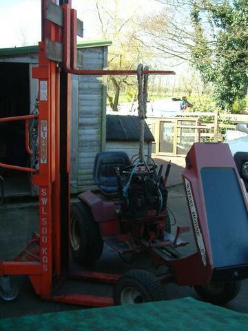

Stormin 4,458 #1 Posted April 9, 2016 Old Faithfull, my C-125 Wheel Horse has taken a turn for the worse. I must have owned it for 5 - 6 years or maybe more. In that time it's got used for cutting the hamlet green and verges every year. Towing trailer loads of logs and rubbish. Though it used a bit of oil, it's never let me down. Until today. When I cut the green last week, it just didn't sound quite right. Seeming to struggle a bit. But I put it down to the grass being longish, (first cut) and a bit wet. Today, though it started straight off, when the deck was engaged the revs dropped a bit and power seemed lacking. As I finished it really started to mess about. Engine dying then speeding up. Fuel? Float bowl off and very little dirt in there. Back together and no difference. Spitting, coughing and backfiring. Maybe dirt in a jet? Hand over the carb throat at high revs. Nope! Getting hold of the engine pulley, I found I could turn the engine easily with one hand. Compression seeming non existent. There is also traces of oil between head and barrel. Time for an engine strip methinks. So I am now in the process of removing the engine. Monday I'll be collecting a rather rough Raider 10. But engine supposedly good. I'll get it running and see. If ok I'll fit it in the C-125 while I do up it's 12hp one. Share this post Link to post Share on other sites

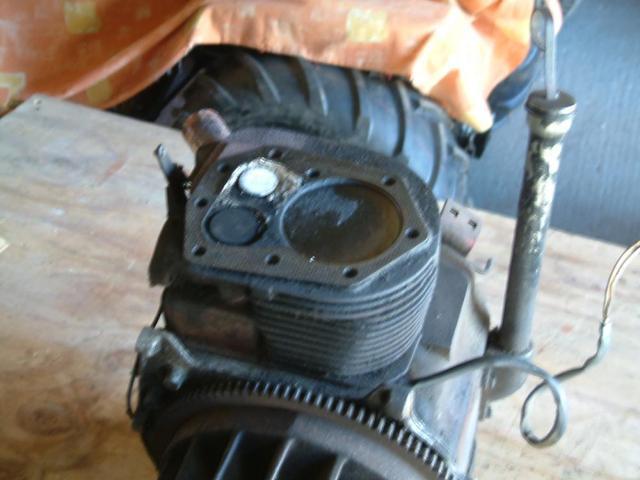

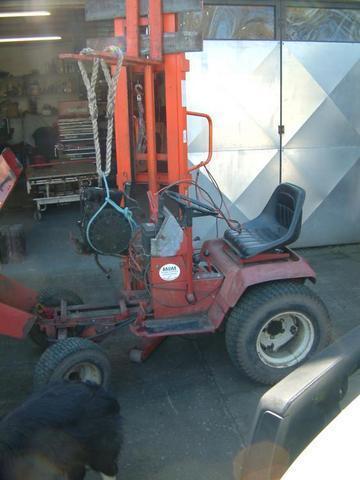

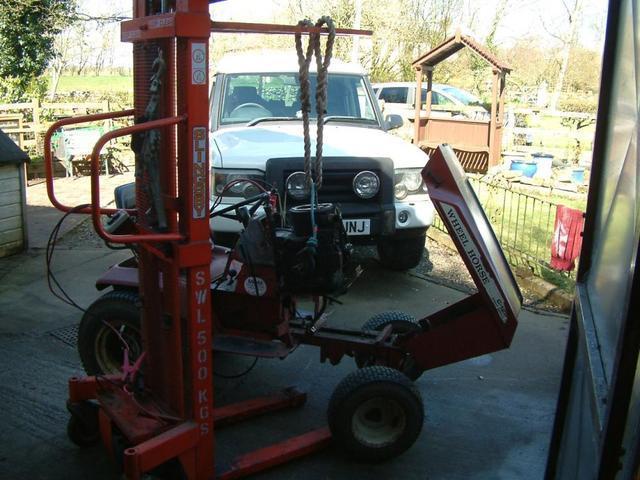

Stormin 4,458 #5 Posted April 10, 2016 Took the engine out today after taking the head off. Bore looks good, but not measured it yet. Bit of wear on the valve side. Exhaust valve looks well past it's sell by date. Inlet is ok, as are both valve seats. Considering the state of the exhaust valve, I would have expected that to be bad as well. Pretty clean in there except round the exhaust valve. Head gasket was leaking oil. As was the other head gasket. Yes! You read that right. Two head gaskets. Head does look a little warped, front to back. Next, tractor off the bench and engine lifted out. Found another use for the ambulance I made for Newby Hall last year. Off for a wash. Nice and clean now. 3 slf-uk, diggerjames and nigel reacted to this Share this post Link to post Share on other sites

meadowfield 1,901 #8 Posted April 11, 2016 A bit of TLC might be all it needs Norm, if it's not knocking then a good clean up - new gasket set and carb service will see if good for another 1000 hours. You can get the full service kits still Share this post Link to post Share on other sites

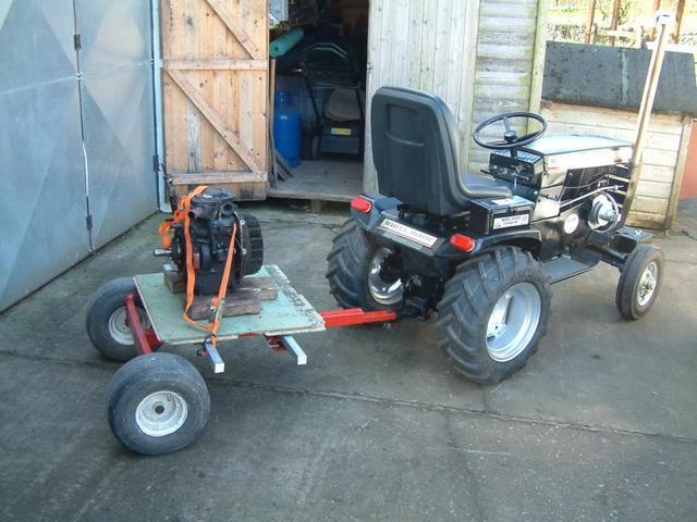

Stormin 4,458 #13 Posted April 11, 2016 I thought I'd need a new exhaust valve, due to the state of it. But while collecting the Raider 10, the chap who I was getting it off, refurbished it for me. That's saved me a couple of bob. Share this post Link to post Share on other sites

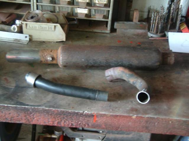

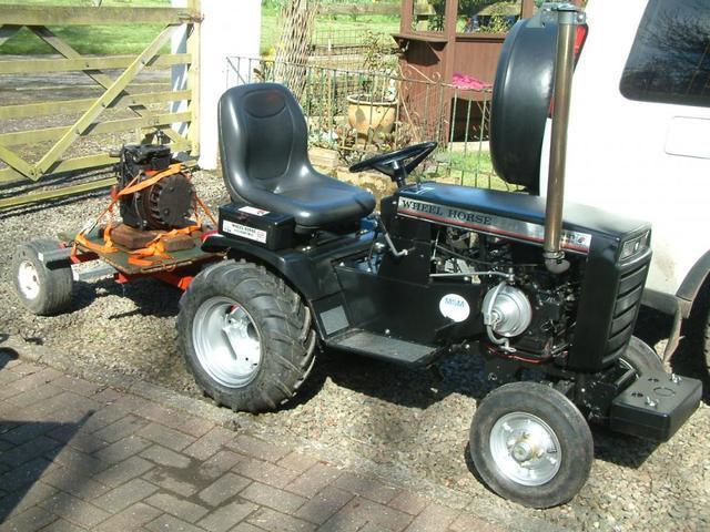

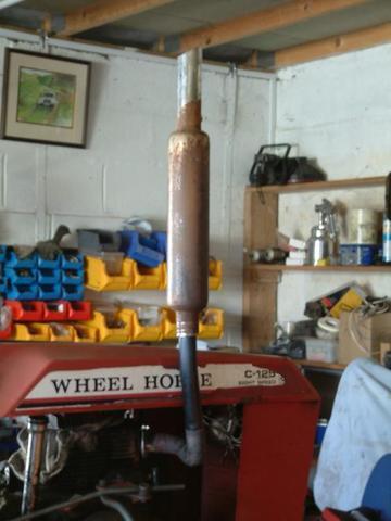

Stormin 4,458 #19 Posted April 18, 2016 Had a bit of a go at a replacement exhaust. Take the manifold end of a kaput exhaust, piece of standard light tubing, machined down trailer eye coupling reducer and an old B.S.A silencer. You then get this. Needs welding and a good clean and painting with BBQ paint. 1 nigel reacted to this Share this post Link to post Share on other sites
nigel 1,881 #20 Posted April 18, 2016 And shortning a bit Share this post Link to post Share on other sites
the showman 4,074 #21 Posted April 18, 2016 That looks good, be careful when you put the lift up Share this post Link to post Share on other sites
Stormin 4,458 #22 Posted April 18, 2016 I may shorten it a bit, Nigel. Depends on clearance for lift the bonnet. It's only be temporary anyway. Lifts up, Chris. 1 nigel reacted to this Share this post Link to post Share on other sites
