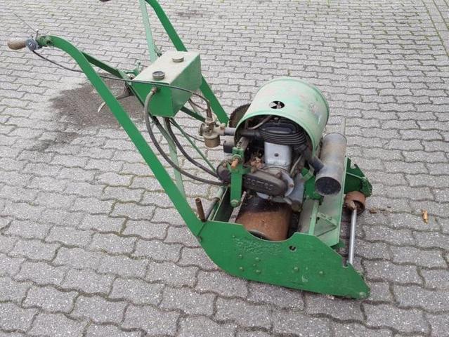

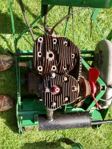

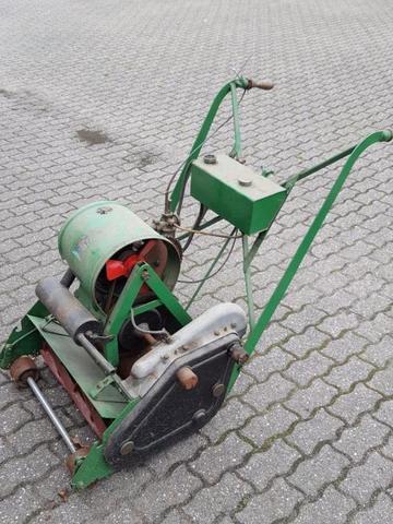

C-101plowerpower 548 #1 Posted June 28, 2016 bought another ransomes today, this time its a mower with roughly the same engine as on my mg2. this one will be used for parts at first, then when i find the proper parts for the mg2 i will rebuild this one. and because you all like pics i will be picking it up saturday 7 the showman, Ian, pmackellow and 4 others reacted to this Share this post Link to post Share on other sites
Stormin 4,458 #2 Posted June 28, 2016 Any idea of it's age, Koen? Share this post Link to post Share on other sites
C-101plowerpower 548 #3 Posted June 28, 2016 Just now, Stormin said: Any idea of it's age, Koen? jonathan said it was an early one with a sturmey archer engine, he said probably around 1938 Share this post Link to post Share on other sites
Stormin 4,458 #4 Posted June 28, 2016 It's in good condition. Share this post Link to post Share on other sites
C-101plowerpower 548 #5 Posted June 28, 2016 Just now, Stormin said: It's in good condition. the ad said it was restored/seen through, so i think i did good for 150 euros/ 115 pounds Share this post Link to post Share on other sites

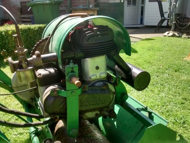

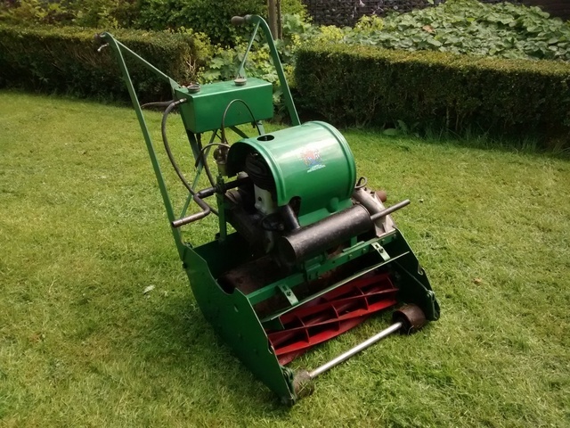

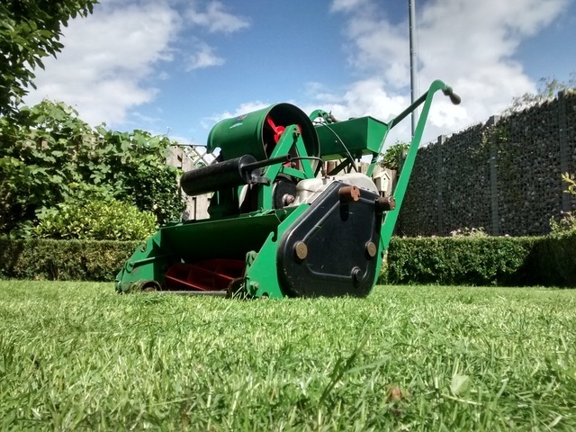

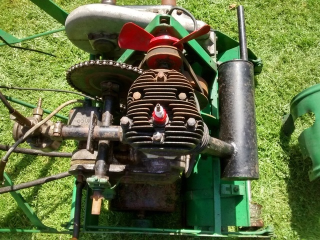

C-101plowerpower 548 #9 Posted July 2, 2016 i've got it home now and after holding the cylinder head of the mg up next to this one its quite clear that the mower is quite a bit smaller so i guess this wont be broken up for spares im trying to get it running, fixed a compression issue, exaust valve was a bit stuck but after a bit of wd40 and some persuation it opperates again and i'm having compression. cleaned the carb and tossed around some bits of the mg carb since that one has more broken bits than this one. carb should be functional again now. now onto the magneto since i can hold the plug wire and ground myself to the machine while spinning the engine without getting zapped after i fix the spark issue i'll have to fit the oil return line, fill it up with oil, some petrol and see if it wants to tick over no pics yet, i'll get some when it stops raining Share this post Link to post Share on other sites
C-101plowerpower 548 #10 Posted July 2, 2016 the weather cleared so its time for some pictures 1 Stormin reacted to this Share this post Link to post Share on other sites

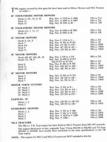

hpearce 40 #11 Posted July 2, 2016 Good find Koen This list from the excitingly titled "List of wearing parts for Ransomes and Sturmey Archer four stroke engines used on Ransomes motor mowers and MG2 Tractors" may help you to identify the engine 2 Triumph66 and C-101plowerpower reacted to this Share this post Link to post Share on other sites

Stormin 4,458 #14 Posted July 3, 2016 Why was compression lost? Share this post Link to post Share on other sites
C-101plowerpower 548 #15 Posted July 3, 2016 Just now, Stormin said: Why was compression lost? valves didn't close propperly, compression came back after letting both valves snap closed two times Share this post Link to post Share on other sites
