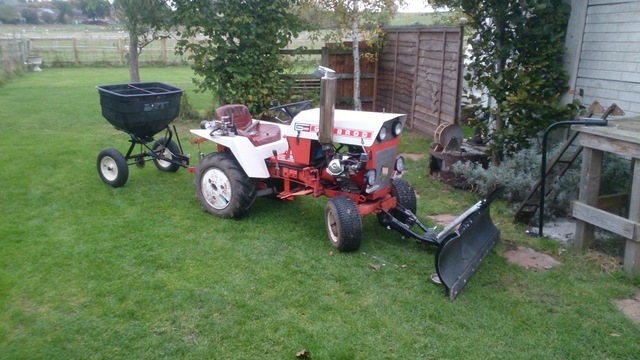

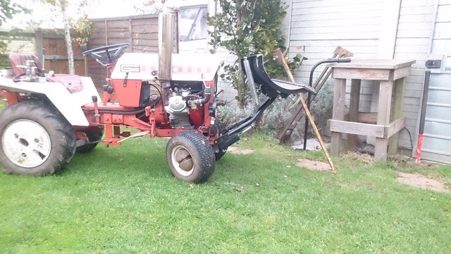

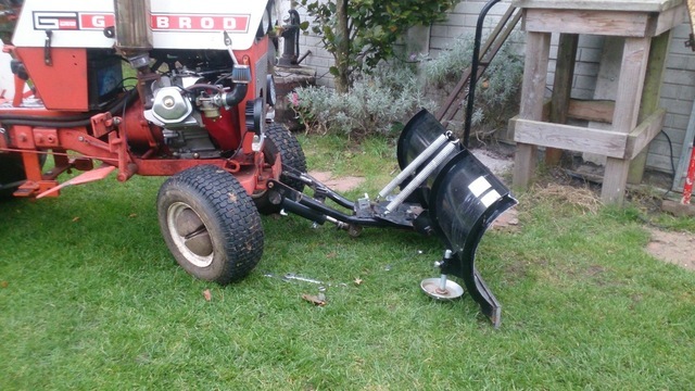

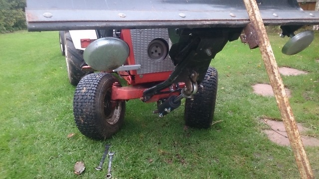

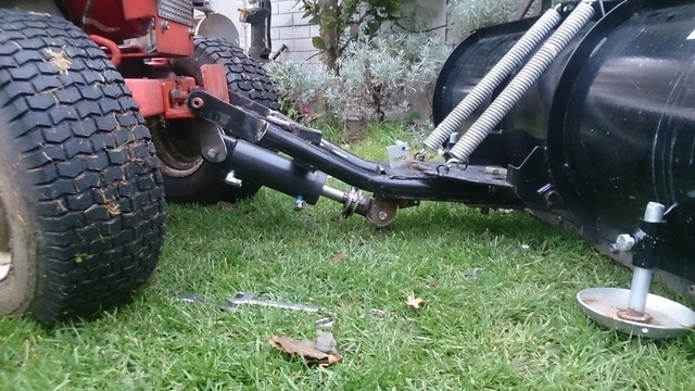

4x4forks 258 #1 Posted October 22, 2016 Spending a few hours making the Husky linkage fit the Gutbrod and made it hydraulic lift. Stripped the ram, Ex forklift tilt ram , And extended the stroke. Took quite a time to figure out the stroke position but very happy with the amount of lift . 7 nigel, Ian, Triumph66 and 4 others reacted to this Share this post Link to post Share on other sites

4x4forks 258 #3 Posted October 22, 2016 It will take longer to get the hose made 2 the showman and Triumph66 reacted to this Share this post Link to post Share on other sites
