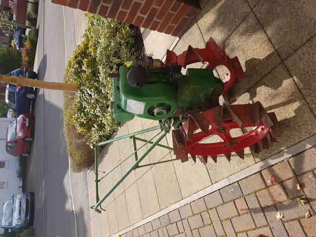

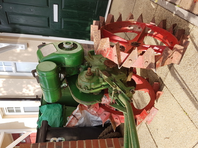

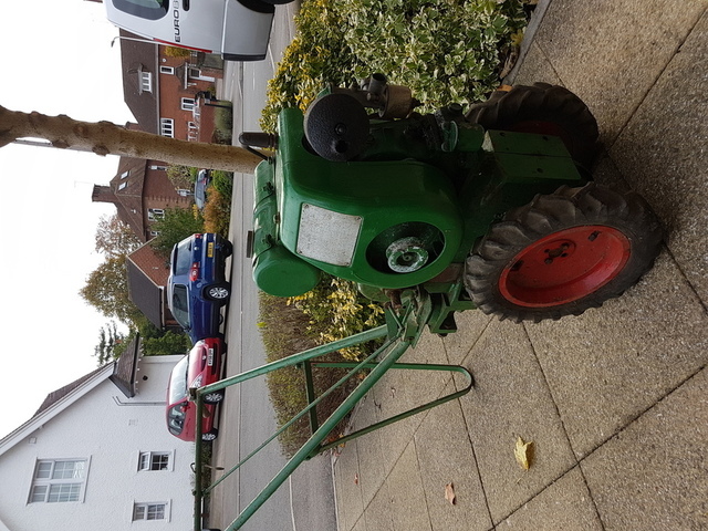

Darmic1 447 #1 Posted November 3, 2016 Whilst at the Autumn Tractor World show Jim Beacon approached me and alerted me to another Farmer's Boy for sale...... The words "with attachments" kinda set my ears on high alert as I have been looking for one of these for some time. Jim was unsure which model it was and I assumed it was another Minor with bits? So I agreed to give it a new home.......... Imagine my delight when Jim messaged me to say it was the earlier Light Tractor model with the cast gearbox! 2 weekends ago it was delivered and I am really pleased with my latest purchase. Here it is as delivered, with the large cast wheels for ploughing fitted....... and its attachments. I have fitted the smaller rubber wheel and tyres to make it somewhat easier to move around! 6 Alan, Stormin, Triumph66 and 3 others reacted to this Share this post Link to post Share on other sites
Stormin 4,458 #2 Posted November 3, 2016 That looks in quite good condition. With all those attachments, no wonder your delighted. 1 Darmic1 reacted to this Share this post Link to post Share on other sites
Darmic1 447 #3 Posted November 3, 2016 My plans for this machine are to strip it all down and get it shot blasted. I will then repaint it using a brush on paint. I'm hoping to use this one to plough with and use the various attachments at working events, a high quality finish would likely get damaged during transit and use...... I have already had the head off the engine, decoked and cleaned the valves. cleaned and reset the points so the engine now runs. The engine needs some attention to the carb, fuel tank and a replacement air filter and throttle/governor cable. The gearbox and the drive axle in particular needs some new bronze bushes fitting as there is about 3mm of play in the shaft! The large cast wheels are missing a couple of ratchet pawls and springs. So some bits will either need to be remade or 2nd hand ones sourced. If anyone knows of a machine breaking which may have some spares, please contact me? Share this post Link to post Share on other sites

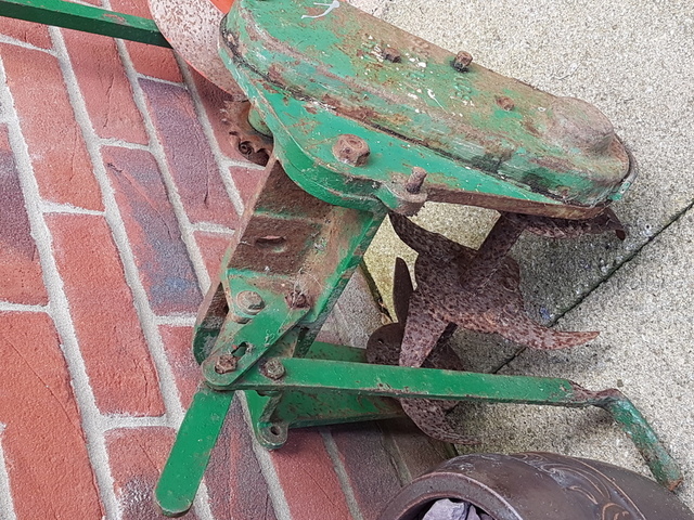

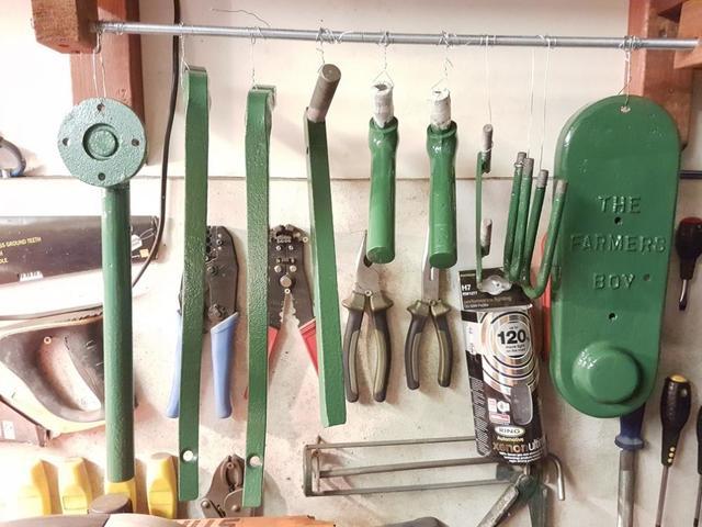

Darmic1 447 #9 Posted November 30, 2016 Haven't really made a lot of progress yet, but have done a few bits 'n' pieces. Decided to start with the attachments on this machine. They were all broken down to component parts, boxed up and sent off to the shot blasters. He is coating all except the mold board with an etch/epoxy primer sealer once blasted. 1 S1g reacted to this Share this post Link to post Share on other sites

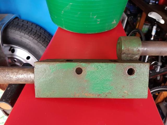

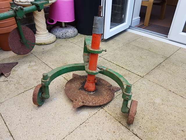

Darmic1 447 #10 Posted November 30, 2016 Then set about looking at the 'wobbly' mower wheels. It was obvious that the spindles had worn quite badly from 19mm(3/4') to about 14mm in places. I spoke to my welder as they are cast, his suggestion was to replace them as welding and then grinding back would significantly weaken the original cast. So a 19mm(3/4') drill bit was sourced along with a short length of 3/4' solid steel bar. Spindles cut off, and some careful measuring to work out the centres, several changes of gradually larger drill bits, the leg of the wheel carriers were eventually ready for the replacement spindles. I heated the casting to allow the cold replacement spindles to virtually drop into the new holes. Once cooled they are a very secure snug fit! A hole was then drilled for the retaining split pin....... 2 S1g and Alan reacted to this Share this post Link to post Share on other sites

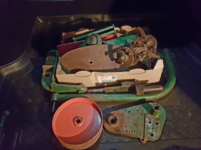

Darmic1 447 #11 Posted November 30, 2016 Have now also sourced some replacement missing parts from the actual tractor..... The fuel tank whilst present is badly damaged around the filler area, causing the cap to not seat and seal. A new tank was kindly donated by Gareth, S1G...... I was also missing 3 of the ratchet pawls on the large cast ploughing wheels. Alan kindly alerted me to possible replacements at John's place. So a trip down to Cranleigh was planned and 4 replacements and a spare engine found their way into the boot of the car. There would have been a lot more too, as Alan and Mr Showman seemed determined that I should leave with my front wheels in the air!!! The ratchet pawls were pretty rusted..... they needed a lot of heat and some persuasion from the hammer to come apart. Once in bits I cleaned them up with a file and the wire wheel....... 2 Alan and S1g reacted to this Share this post Link to post Share on other sites

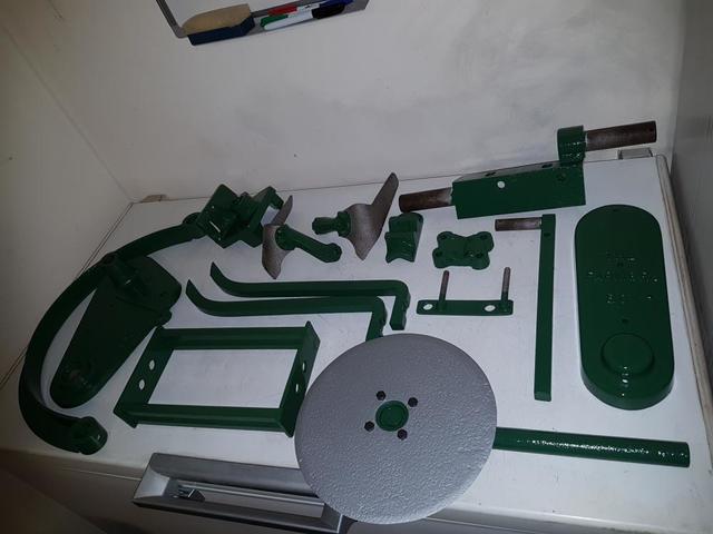

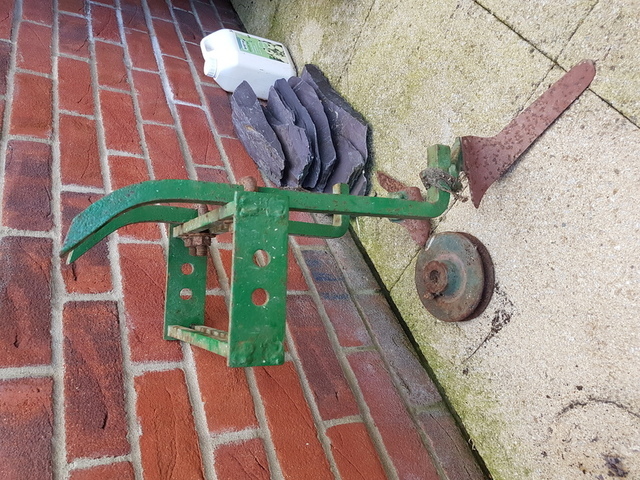

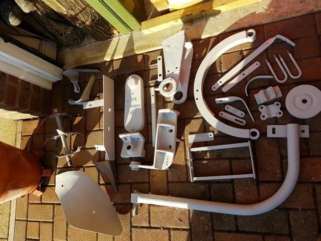

Darmic1 447 #14 Posted December 16, 2016 All the attachment parts are now back from the blasters. So today I made a start on the painting....... This one is being brush painted, and I am most impressed by the paint my supplier has sold me. It covers in one coat. It's quite 'thick' in the tin, once brushed on it seems to thin and flatten really nicely, leaving no visible brush marks. Here are a few pictures of the collected parts, some original paint colour and the start of the painting marathon! 1 Alan reacted to this Share this post Link to post Share on other sites

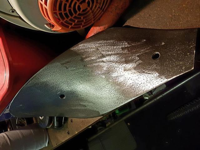

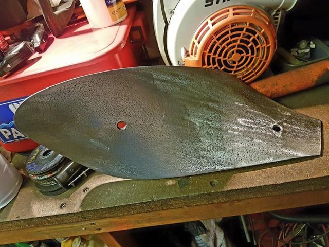

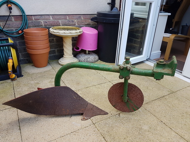

Darmic1 447 #15 Posted December 16, 2016 I'm after a bit of advice on the plough's mold board? It's been shot blasted to remove the rust, however it is more 'pitted' than I first thought. I have attempted to remove some of this pitting with a flap disc, ground in the direction of the ploughs travel. what should I do with it? Fill the pitting with weld/filler/any other suggestion? Help and advice greatly received. Here is the board following the flap disc treatment Share this post Link to post Share on other sites
Stormin 4,458 #16 Posted December 16, 2016 There are products on the market that supposedly replace metal and machinable. See what a local engineering suppliers has to offer. Share this post Link to post Share on other sites
the showman 4,074 #17 Posted December 16, 2016 Mine was like that Darren and i did exactly what you've done and left it as is. it works really well and the more you use it the better it gets, I always give mine a smear with grease after ive used it 1 Darmic1 reacted to this Share this post Link to post Share on other sites
Darmic1 447 #18 Posted December 16, 2016 Thanks Guys! So I think i'll leave it as is and let the 'ground' work its magic! Share this post Link to post Share on other sites

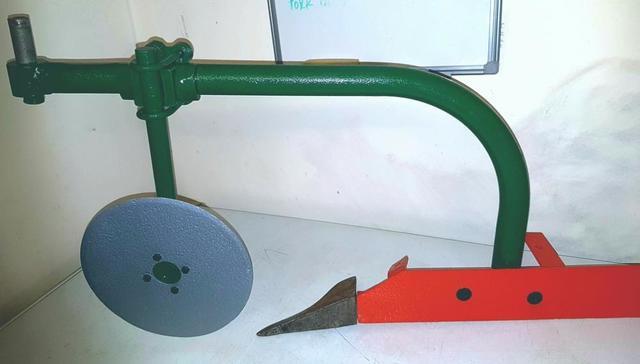

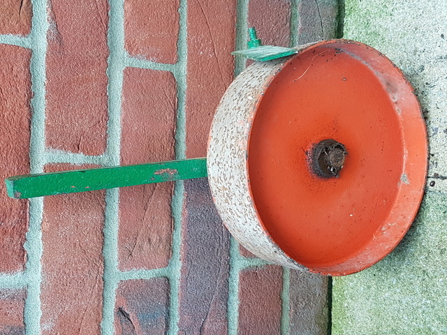

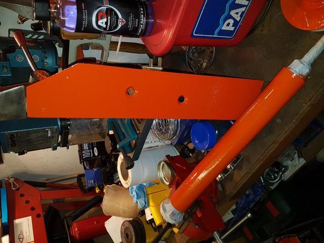

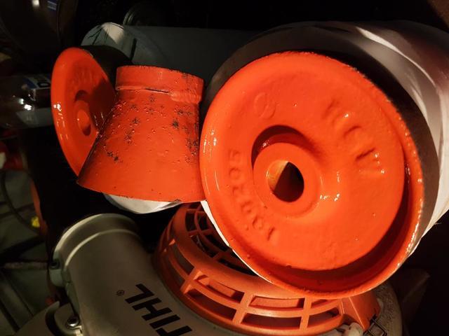

Darmic1 447 #19 Posted December 20, 2016 Gradually making a bit more progress with the attachments........ Most the green bit are now painted and have started on the red/orange parts. I forgot to take the 'sample' to match the colour..... Ooops! However, I took a gamble and chose what I thought was a close match......... Not a bad guess, eh? 3 Stormin, Alan and Anglo Traction reacted to this Share this post Link to post Share on other sites
Darmic1 447 #20 Posted December 20, 2016 Most the green bits are now............. green? 2 Alan and Stormin reacted to this Share this post Link to post Share on other sites

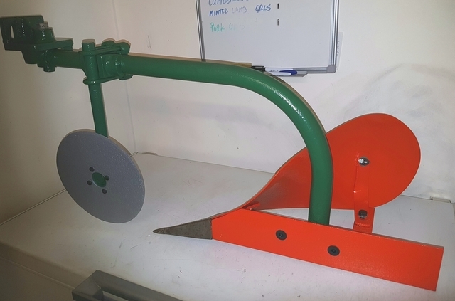

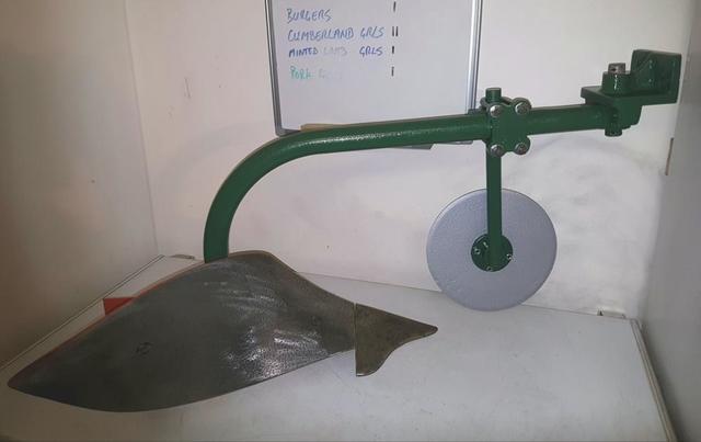

Darmic1 447 #21 Posted December 24, 2016 Made a start putting the plough back together 2 days ago....... I needed some countersunk 'one nib' bolts for the plough shear to be refitted, so whilst waiting for them to arrive I got this far. Share this post Link to post Share on other sites
Darmic1 447 #22 Posted December 24, 2016 'One nib' countersunk bolts arrived today! Didn't have much time this morning before I had to go get ready for work Today was widely reported to be the busiest day of the Christmas period with a supposed 12 million vehicles travelling 20 miles or more! Thankfully my area of responsibility wasn't too bad, and nothing major happened to interrupt Christmas travel! Anyways....... half an hour was spent fitting the plough shear. Plough is just needing the washers and securing pins refitting to the hitch. 4 Anglo Traction, Stormin, Alan and 1 other reacted to this Share this post Link to post Share on other sites
the showman 4,074 #23 Posted December 24, 2016 Good job Darren, the plough looking good, once you start using it you'll be amazed how shiny it gets 1 Darmic1 reacted to this Share this post Link to post Share on other sites
Stormin 4,458 #24 Posted December 24, 2016 Very nice. 1 Darmic1 reacted to this Share this post Link to post Share on other sites
Darmic1 447 #25 Posted December 24, 2016 4 hours ago, the showman said: Good job Darren, the plough looking good, once you start using it you'll be amazed how shiny it gets Thanks! I hope so? Was a bit worried when it came back from the blasters with all the pitting! 4 hours ago, Stormin said: Very nice. Thanks! Share this post Link to post Share on other sites
