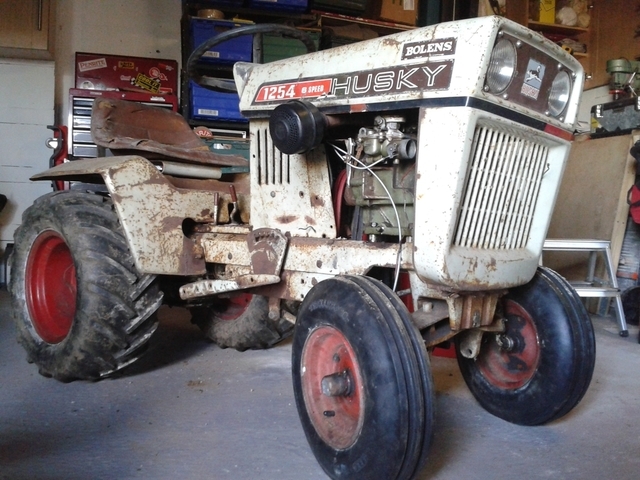

Cub Cadet 613 #3 Posted November 18, 2016 http://www.unitytyreonline.co.uk/turf_small.html I bought Duro HF257 tri ribs from here £15.60 each and mine came with tubes, i've used them on two tractors and highly recommend them. This photo shows what they look like 4 slf-uk, Triumph66, HeadExam and 1 other reacted to this Share this post Link to post Share on other sites
