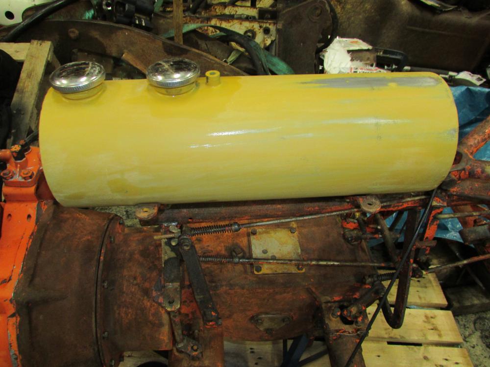

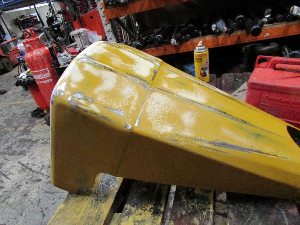

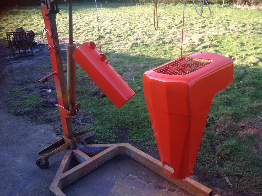

S1g 579 #28 Posted February 11, 2017 Last night I put a bit of work into rubbing down the fuel tank and the bonnet. The fuel tank should now just need another coat of primmer, but the bonnet is going to be a fair few hours yet! 3 Darmic1, pmackellow and Stormin reacted to this Share this post Link to post Share on other sites

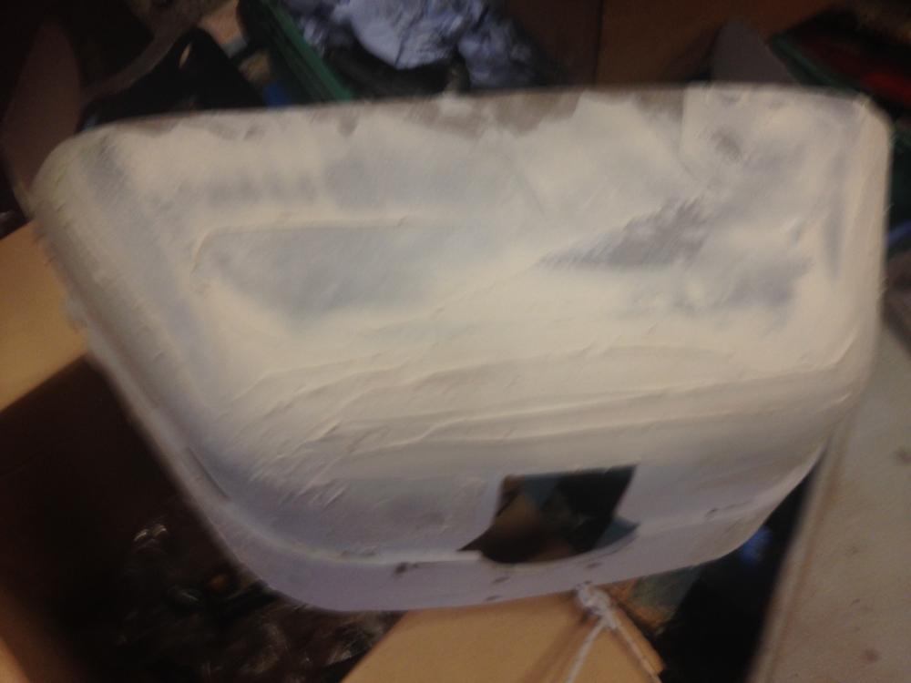

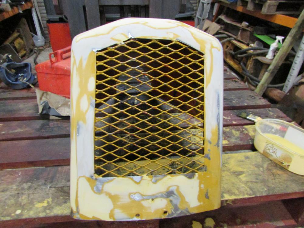

S1g 579 #29 Posted February 13, 2017 Spent another couple of hours on the bonnet, yet still it needs more work! I hate filling!!! 3 pmackellow, Darmic1 and Stormin reacted to this Share this post Link to post Share on other sites

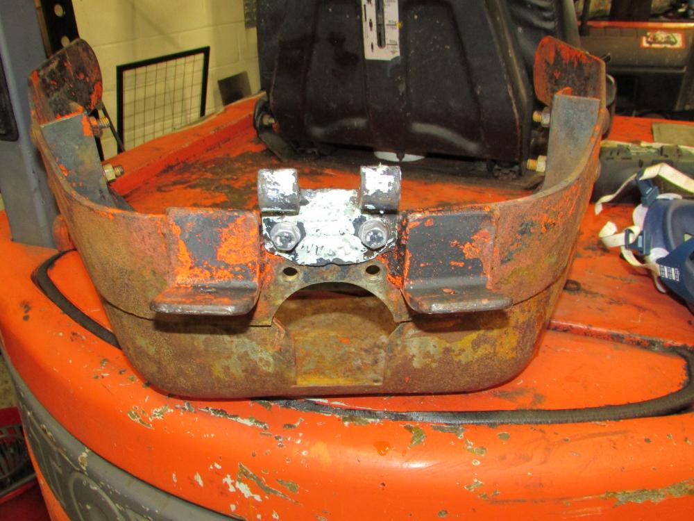

S1g 579 #30 Posted March 9, 2017 managed to make a bit more progress with the bottom cowl tonight. A previous owner had welded on some stops for the bonnet to rest on. All I can say is when I came to grind them off that they did a very thourgh job of welding them in place! Took a look time to remove. 4 pmackellow, Cub Cadet, nigel and 1 other reacted to this Share this post Link to post Share on other sites

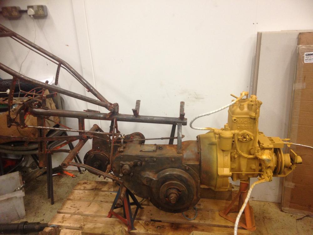

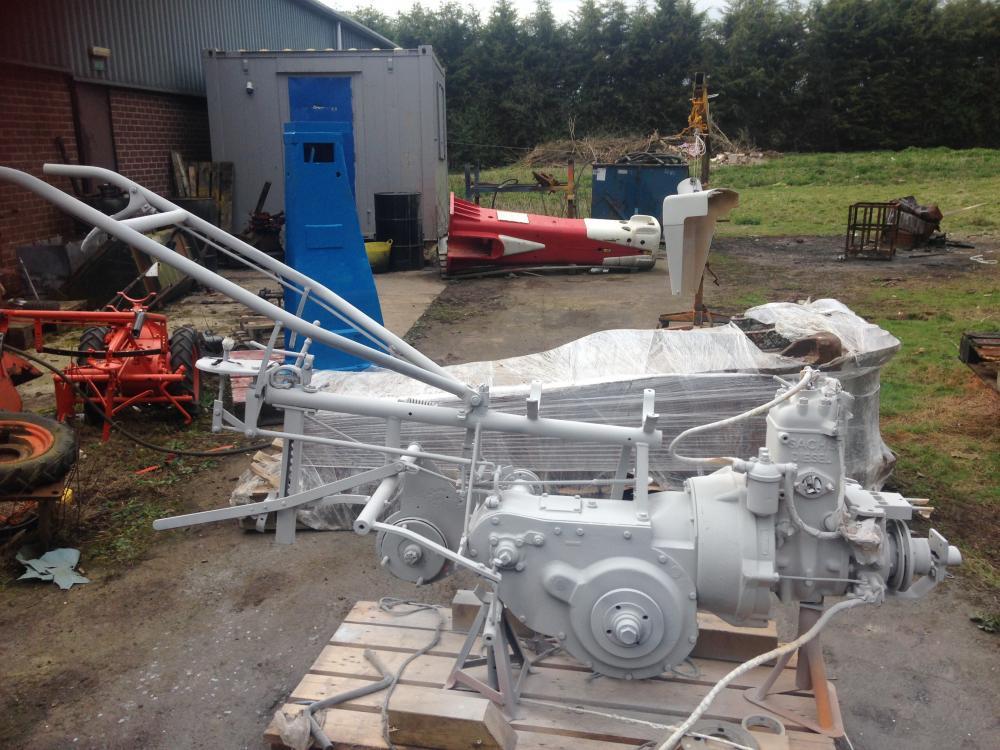

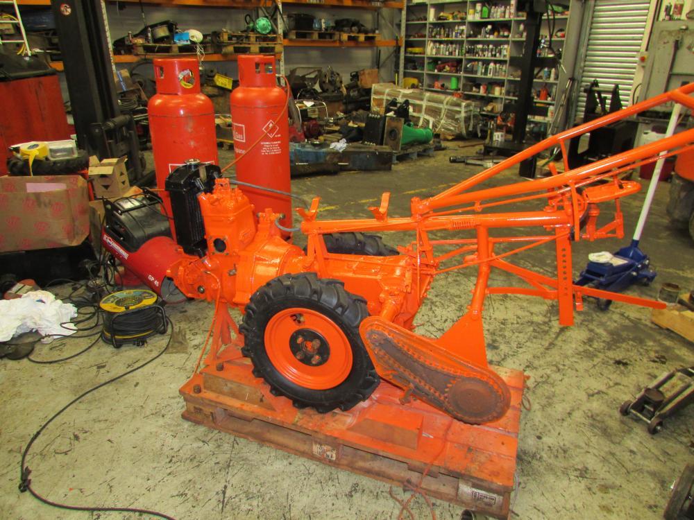

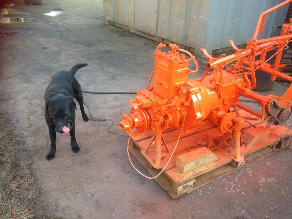

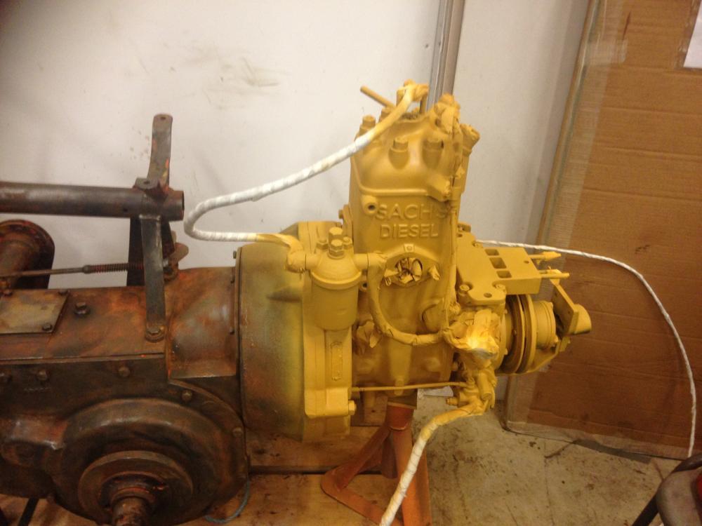

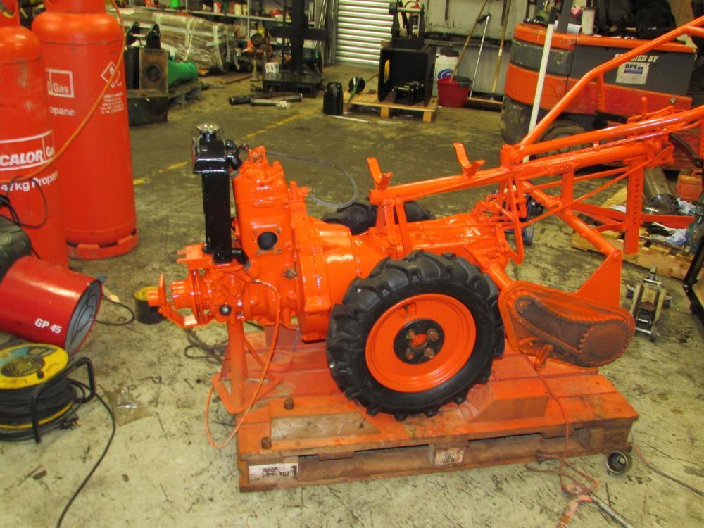

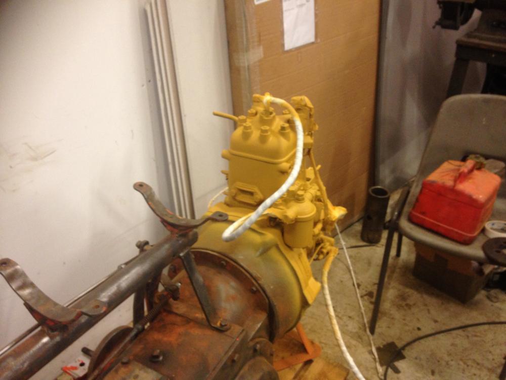

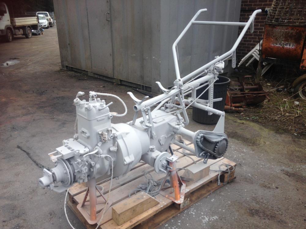

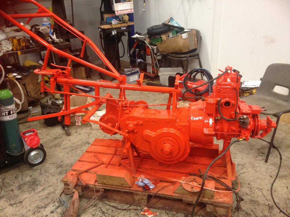

S1g 579 #31 Posted March 22, 2017 A couple of nights ago I gave the main chasis a going over with the wire brush. Tonight the engine got masked up and a couple of coats of etch primmer, followed by a couple more of high build primmer. Just got to wait for a dry evening now to prime the rest and apply topcoat. Bet you cant guess the colour! Share this post Link to post Share on other sites

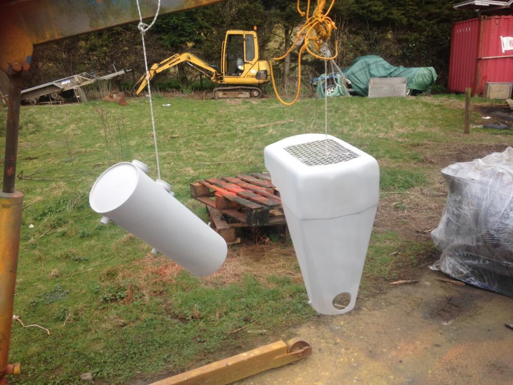

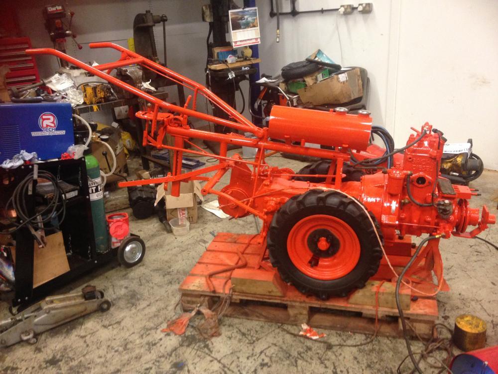

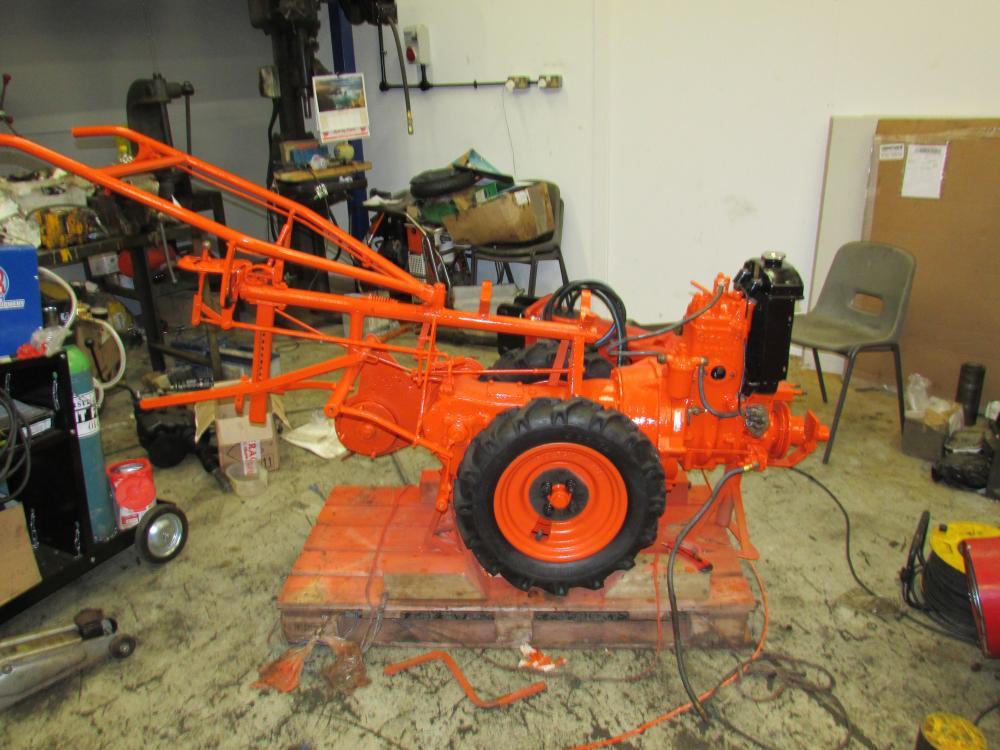

S1g 579 #35 Posted March 24, 2017 Im afraid none of you were quite right. This evening I took advantage of the lack of rain and sprayed it up. On the whole it came out ok, however I think im going to have to flatten back the bonnet and redo it, as I not 100% happy with the finish. 5 Stormin, pmackellow, nigel and 2 others reacted to this Share this post Link to post Share on other sites
nigel 1,881 #36 Posted March 24, 2017 Oh ! Orange ime so surprised Gareth 👍🏻 1 S1g reacted to this Share this post Link to post Share on other sites

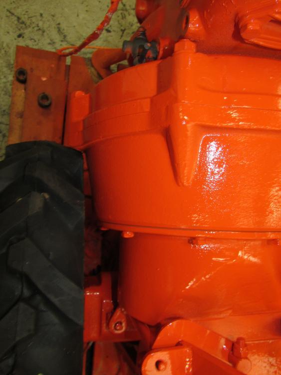

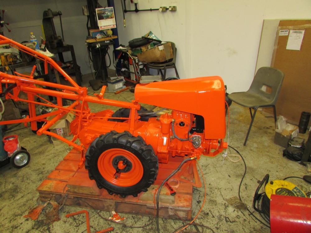

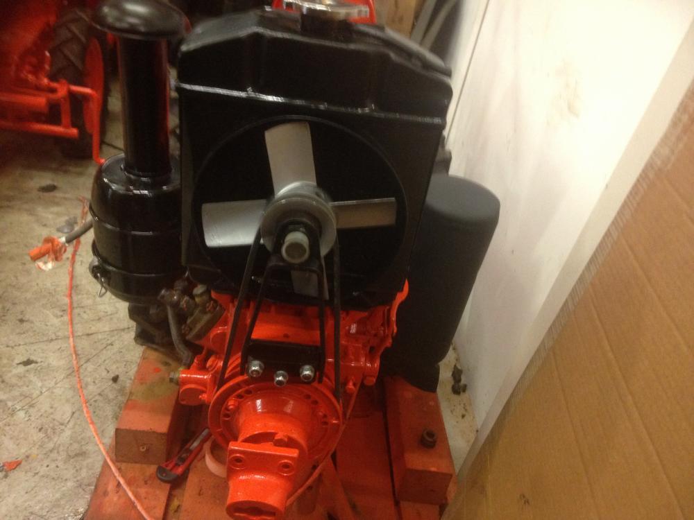

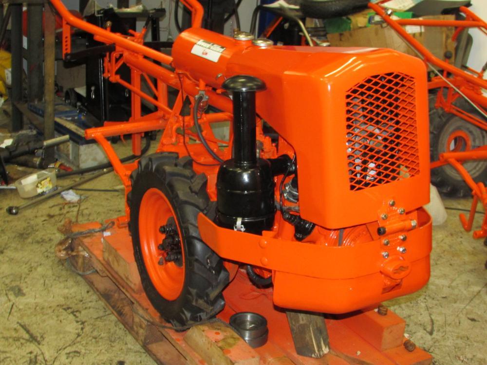

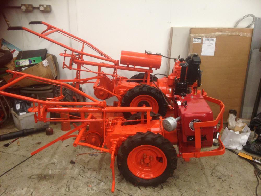

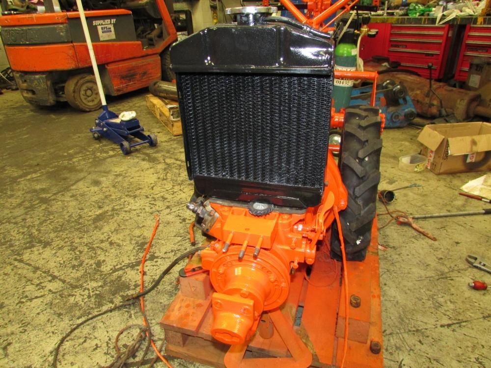

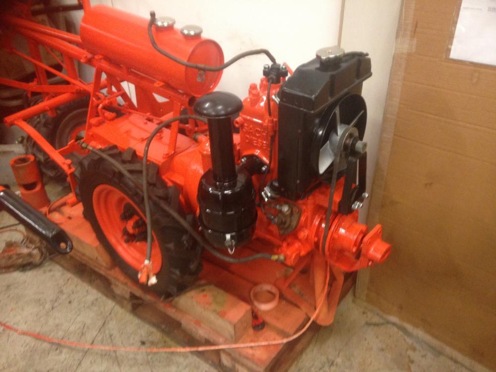

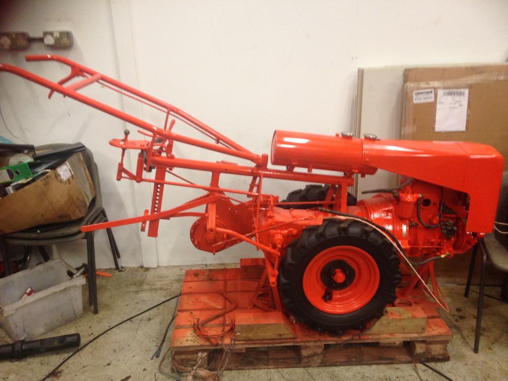

S1g 579 #39 Posted March 25, 2017 Have now started fitting up the Gem. First on was the wheels followed by the radiator. On the nearside wheel I had to fit an extra wheel disc to act as a spacer due to the tyre rubbing on the bellhousing (such a shame the original Dunlop tyres are no longer available.) This in turn will mean the springs need shortening. I have also trail fitted the bonnet. Now it has dried Im hoping that I may get away with sanding it smooth with 2500 wet and dry. 4 Stormin, Darmic1, pmackellow and 1 other reacted to this Share this post Link to post Share on other sites

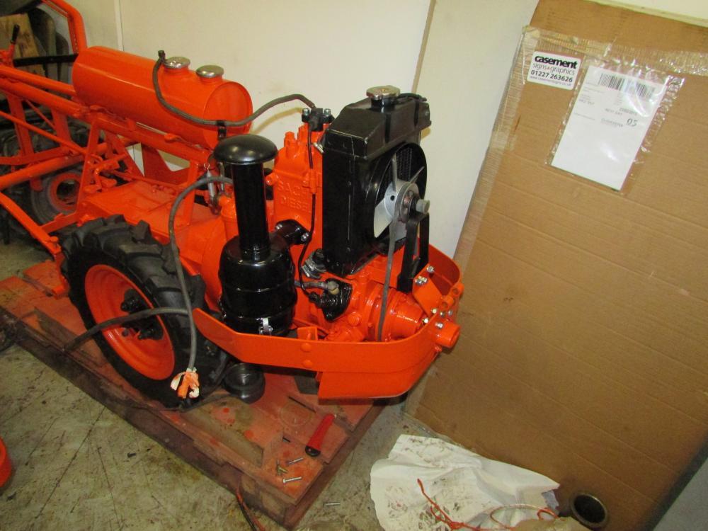

S1g 579 #42 Posted March 27, 2017 Carrying on with the build up... 2 Darmic1 and Stormin reacted to this Share this post Link to post Share on other sites

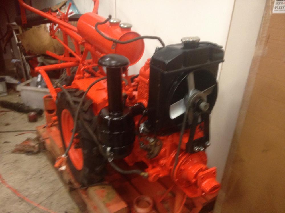

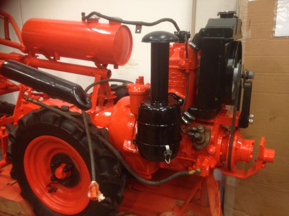

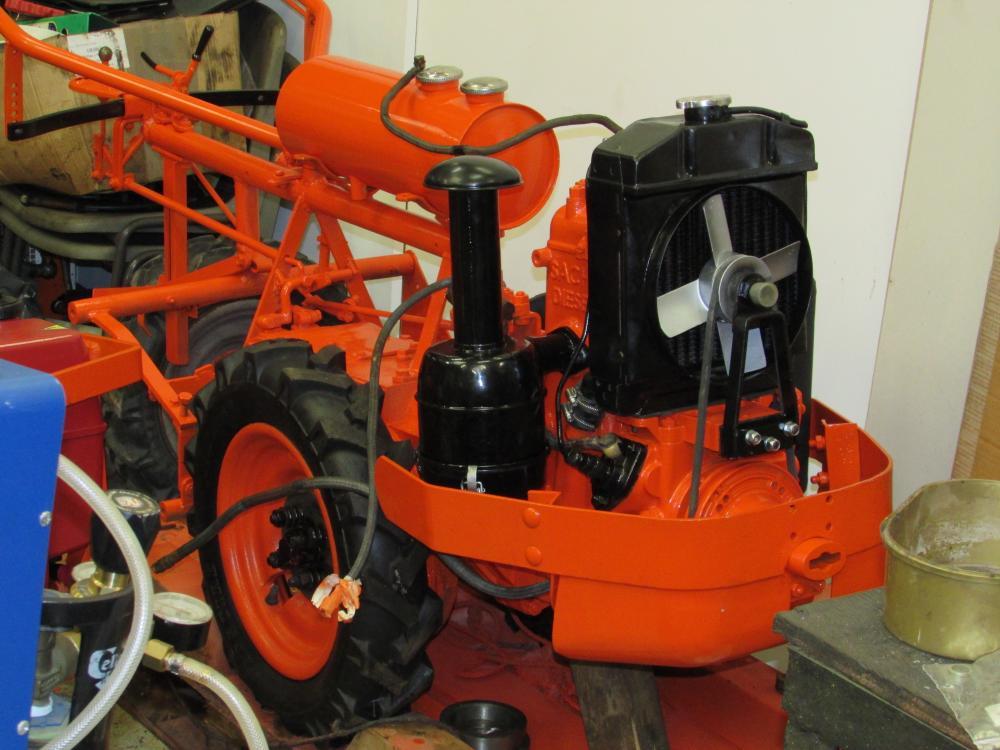

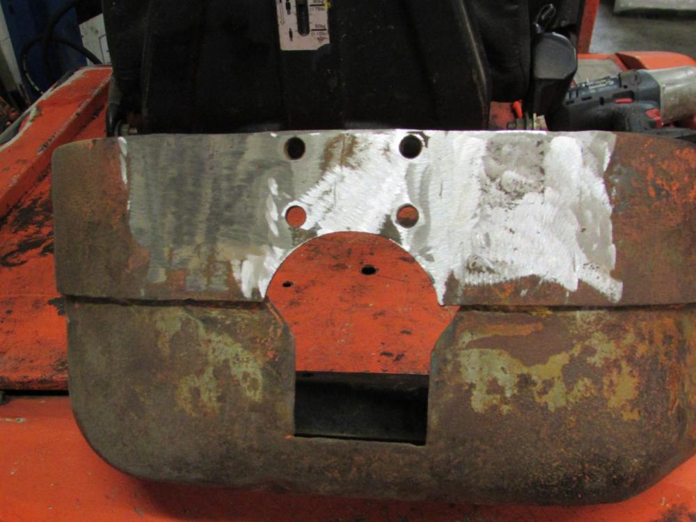

S1g 579 #43 Posted April 19, 2017 Managed to get another hour or so on this project today. The air filter was refitted, followed by the exhaust and the injector. Next the radiator and fan was properly plumbed in and I loosely refitted the fuel lines. The fuel lines could really do with replacing, can anyone recommend a good source please? The final job today saw the under belly tray get a skim of filler as after blasting it came up just way too rough to paint. 3 pmackellow, Darmic1 and Stormin reacted to this Share this post Link to post Share on other sites

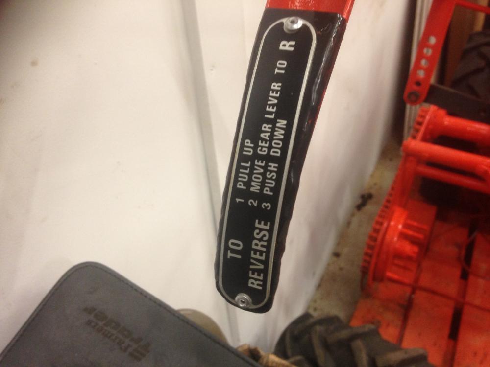

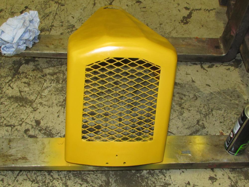

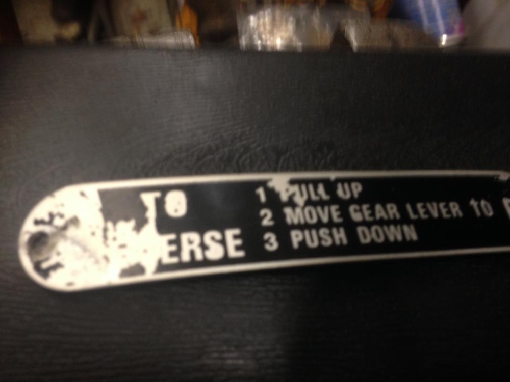

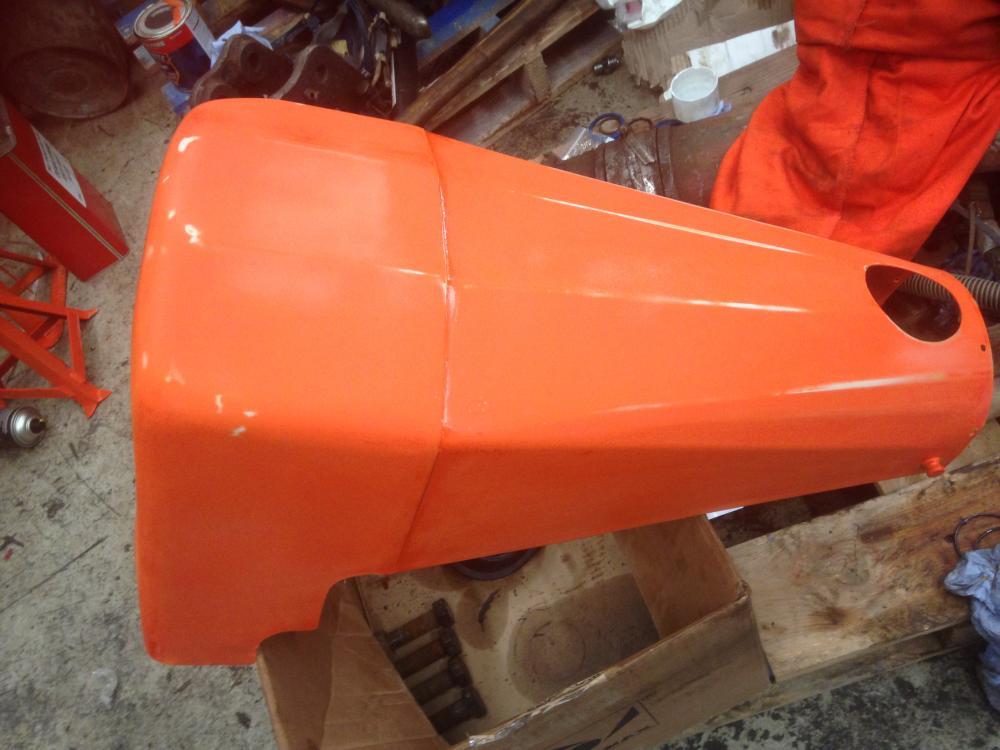

S1g 579 #44 Posted April 26, 2017 When I had a proper look at the bonnet I decided that it would need flatting back as there was some contamination im guessing in the primmer. Today I also managed to get the under belly sanded and primed. Just going to need a small skim of stopper and then it should be ready for top coat. A while back I purchased a load of N.O.S badges for Gem's, every one up till now had been fine, however when I peeled back the cellophane layer on the clutch one it peeled some of the paint off, I don't know why, but as luck would have it I had another new one that was good. 3 howardman, Darmic1 and Stormin reacted to this Share this post Link to post Share on other sites

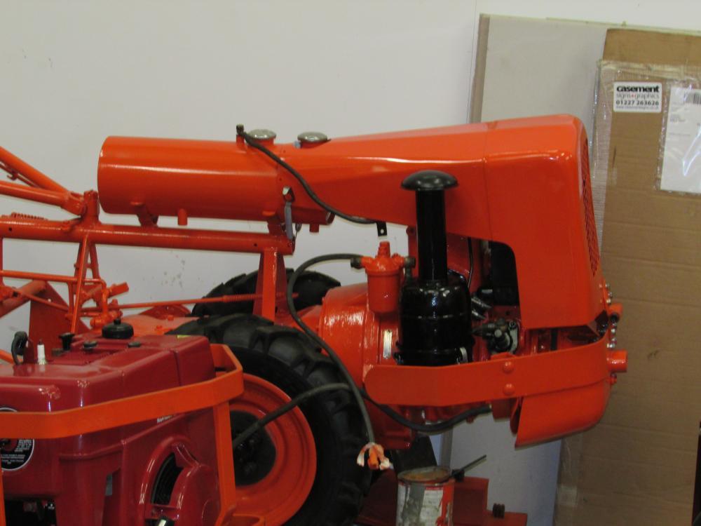

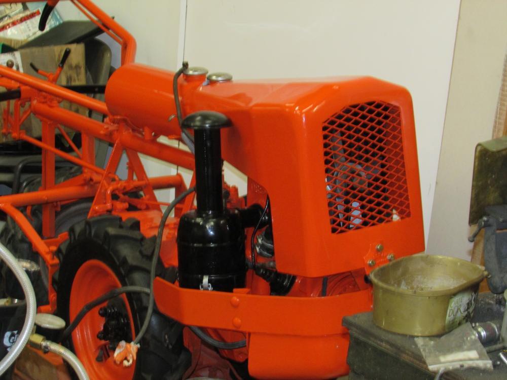

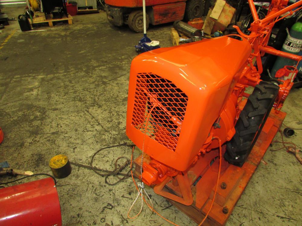

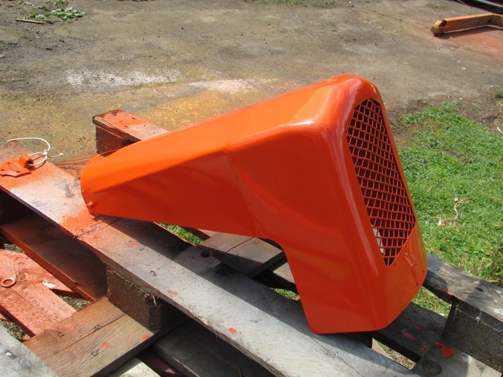

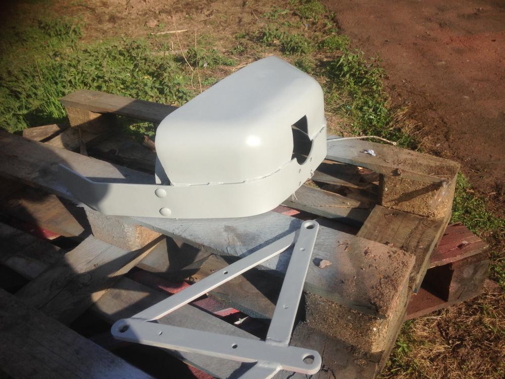

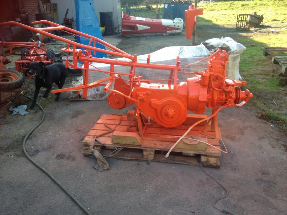

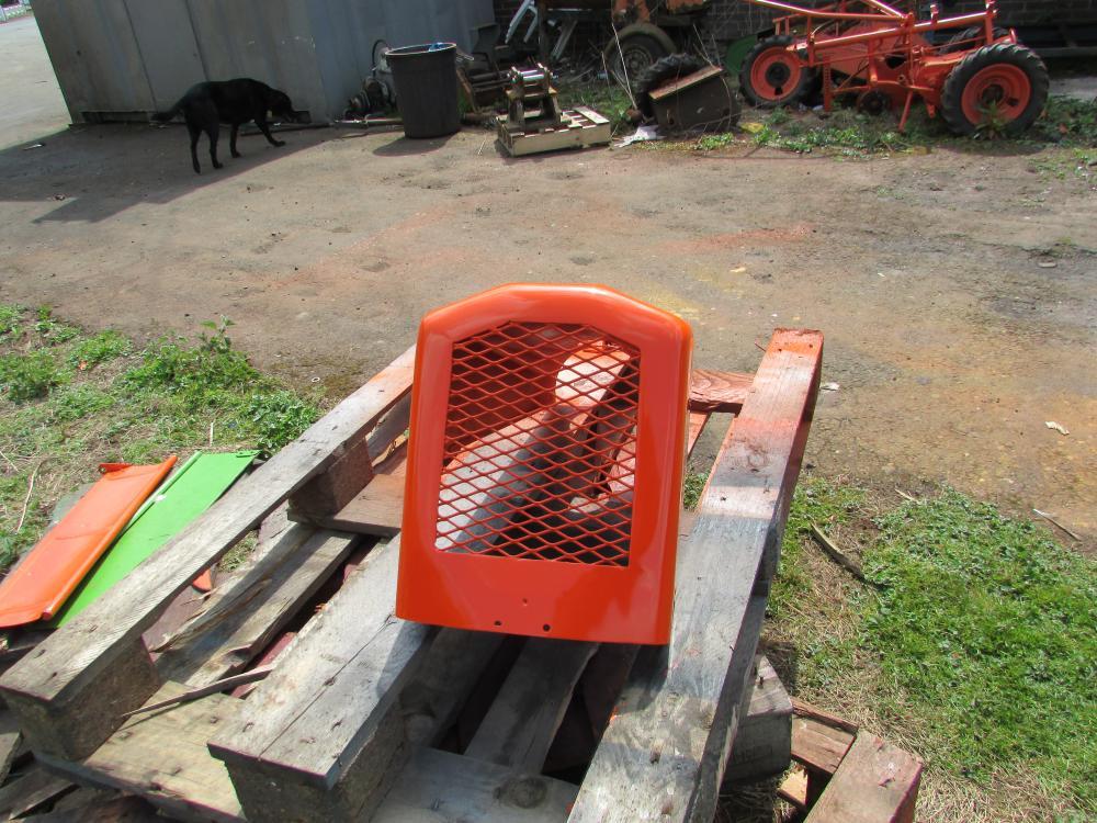

S1g 579 #47 Posted May 2, 2017 Heres a couple of shots of the painted bonnet in the sun and the under belly fitted with all the brackets lined up. 2 Alan and Stormin reacted to this Share this post Link to post Share on other sites

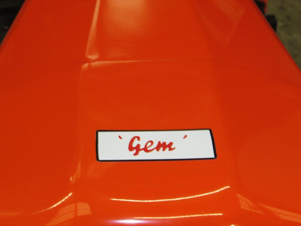

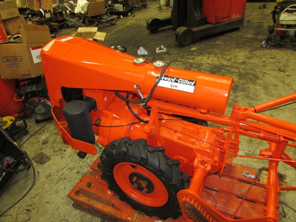

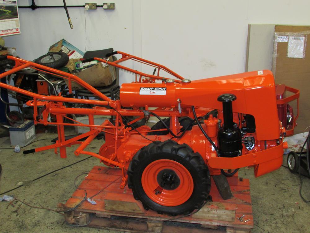

S1g 579 #48 Posted May 3, 2017 Today I finally applied the decals to the fuel tank, something ive been dying to do for a few weeks now, but wanted to get the bonnet refitted in order to line everything up. When it came to connecting up the fuel lines, as ive been struggling to find some one to make new ones up at a reasonable cost and the damage to the old ones was only asthetic, I tried using some heat shrink tube. It seems to of worked a treat. 1 Stormin reacted to this Share this post Link to post Share on other sites
