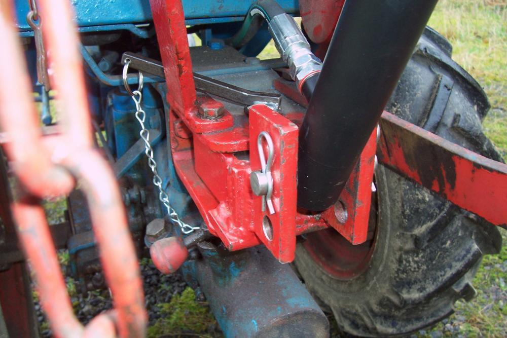

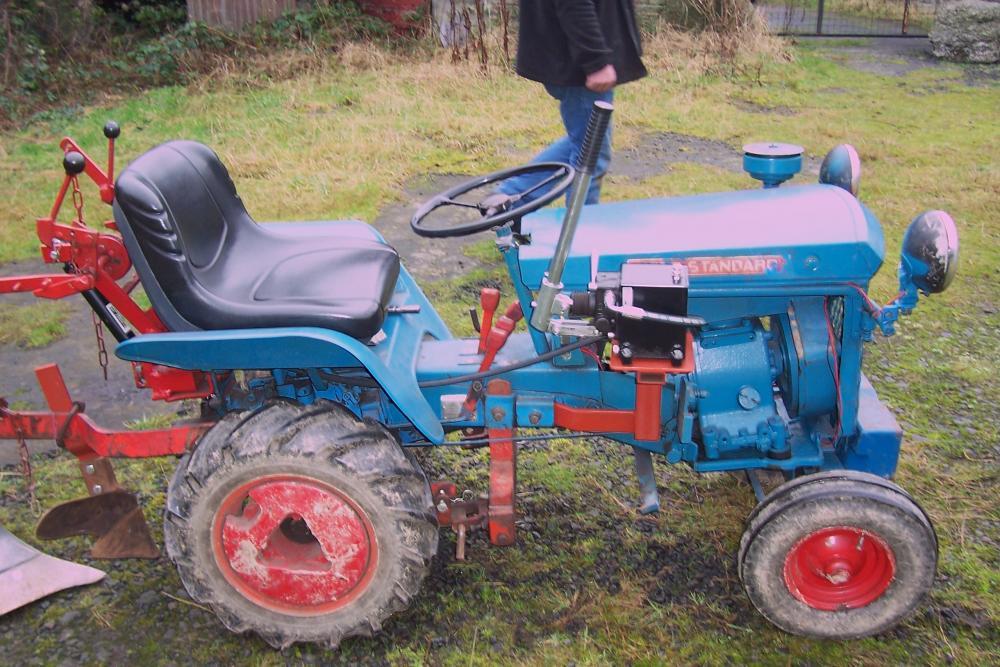

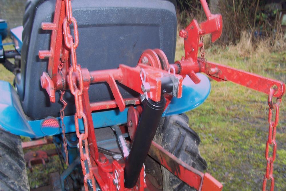

rolloman 123 #1 Posted January 22, 2017 Hi all I have been busy this wee while converting my Little Tractor from a hand lift to a nice Hydraulic lift for the up and coming Horticultural plough matches / working days here are some pictures of it today after completion i think it was well worth the time and effort involved I think I might rename this Tractor Heinz 57 as it has a Villiers 44 h engine a countax seat two Fergy Headlights and now a hydraulic lift to boot but what the heck i think its great bring on the plough days 6 Stormin, Cub Cadet, S1g and 3 others reacted to this Share this post Link to post Share on other sites

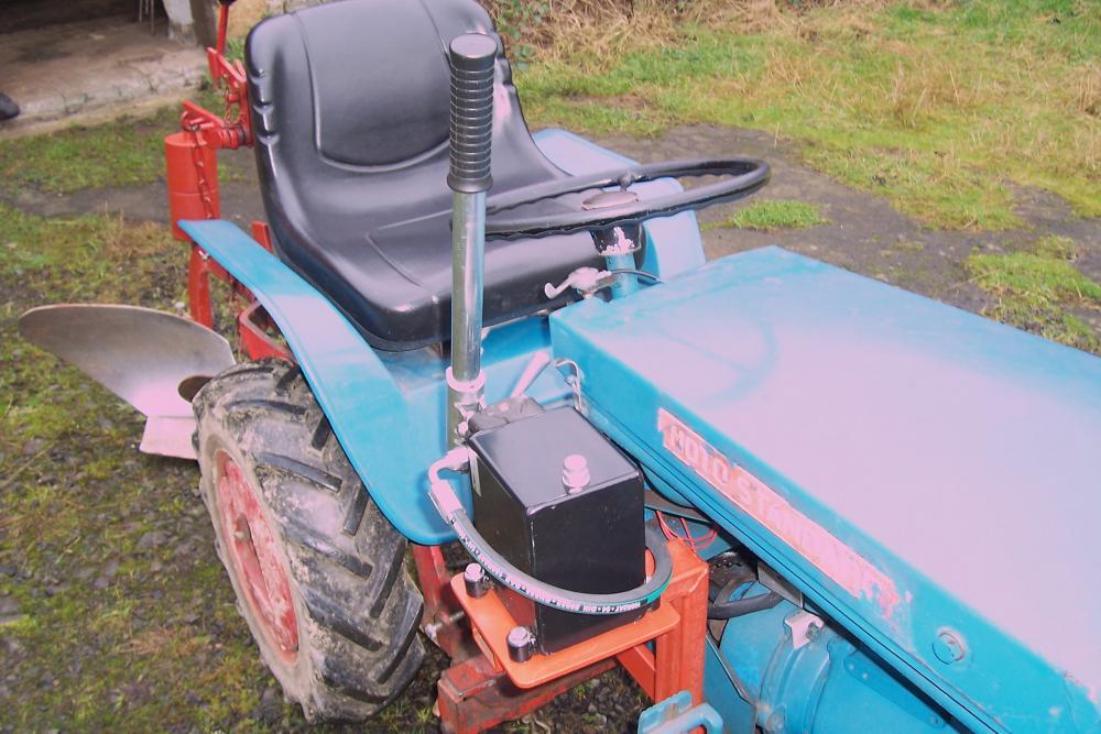

Stormin 4,458 #2 Posted January 23, 2017 A hand pump. Nice and simple. You'll have to enter the HVC match at Carlisle with Graeme (madjock) and co. Share this post Link to post Share on other sites

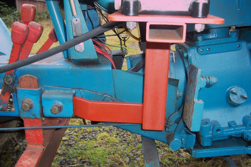

Chris 642 #6 Posted January 24, 2017 Now thats tidy Like the way you not welded anything to the tractor. Just used a bracket which was there 1 Aidan reacted to this Share this post Link to post Share on other sites
The Fife Plooman 632 #7 Posted January 24, 2017 Hi Chris The idea behind in using an existing fixing point is if the valve block or in Rollomans case was that if the pump was fixed to the tractor frame next to the 1032 number on my tractor you would have to remove the tank to bore holes in the panel and weld on captivated nuts to hold the pump or valve block. I thought this was a better idea. see photos good thing about it is anything goes wrong with one tractor you can move it to another tractor without leaving holes or spending a lot of time doing it Sorry for hijacking your post Rolloman Have fun George S 1 Aidan reacted to this Share this post Link to post Share on other sites
