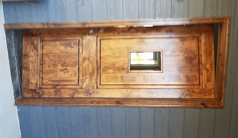

HeadExam 1,783 #6 Posted September 10, 2017 1st coat of Urethane 2 Alan and Stormin reacted to this Share this post Link to post Share on other sites
