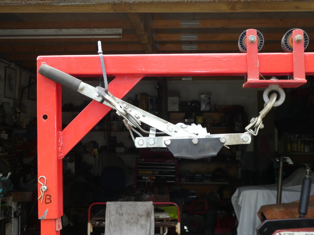

the showman 4,074 #37 Posted November 30, 2017 Fabrication all finished ( I think) I thought it would be handy if the hook for the hoist moved from side to side so I found some more bits and pieces and the photos show what i came up with. Also finished the 4 pins for the topbar. 4 Cub Cadet, Stormin, nigel and 1 other reacted to this Share this post Link to post Share on other sites
nigel 1,881 #38 Posted November 30, 2017 That’s very clever 1 the showman reacted to this Share this post Link to post Share on other sites
Stormin 4,458 #39 Posted November 30, 2017 Good job Chris and a neat idea for a monkey. 1 the showman reacted to this Share this post Link to post Share on other sites
Alan 1,274 #40 Posted November 30, 2017 As Norm said Chris. And those pins, shouldn't they fit somewhere else. 1 the showman reacted to this Share this post Link to post Share on other sites
expeatfarmer 591 #41 Posted December 2, 2017 Neat job Chris I like it , hook on rollers was a good idea .J 1 the showman reacted to this Share this post Link to post Share on other sites

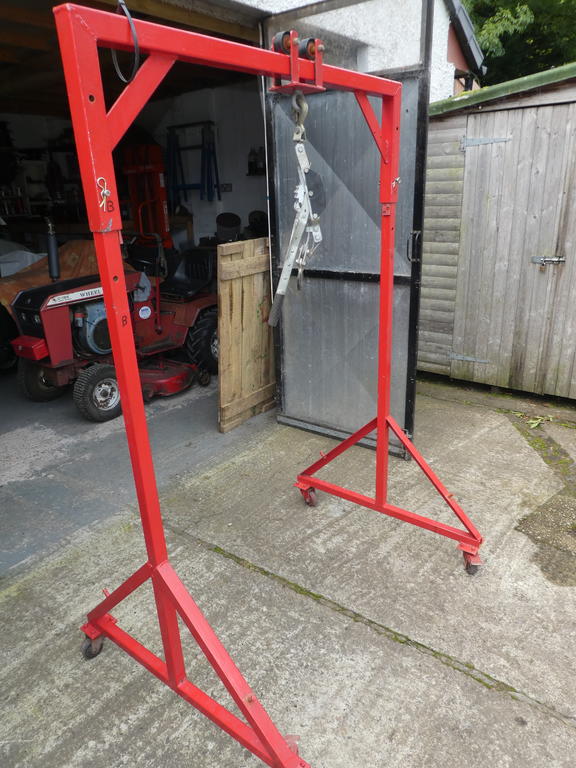

the showman 4,074 #43 Posted December 29, 2017 Final update on the gantry, I stuck some rubber on the monkeys legs to stop it scratching the paint when it runs side to side. It only takes a few minutes to put up and I think it will be handy for lifting heavy items. Im quite pleased with the end result and it's only cost me a tenner for the paint Share this post Link to post Share on other sites
Stormin 4,458 #44 Posted December 29, 2017 Monkeys have wheels like railway bogies with flanges on. Maybe you could somehow fit four rollers to the vertical brackets to guide the monkey. Less resistance when moving sideways. Give you something to think about. Share this post Link to post Share on other sites
the showman 4,074 #45 Posted December 29, 2017 5 hours ago, Stormin said: Monkeys have wheels like railway bogies with flanges on. Maybe you could somehow fit four rollers to the vertical brackets to guide the monkey. Less resistance when moving sideways. Give you something to think about. This is the FINAL update Norm, not doing anymore to it. It works fine as it is. !!!. 1 Stormin reacted to this Share this post Link to post Share on other sites

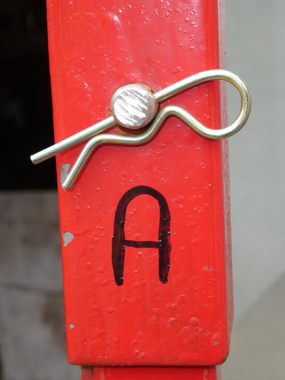

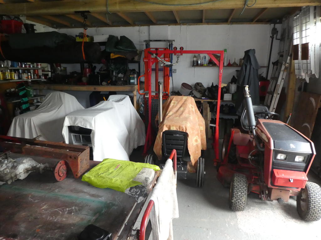

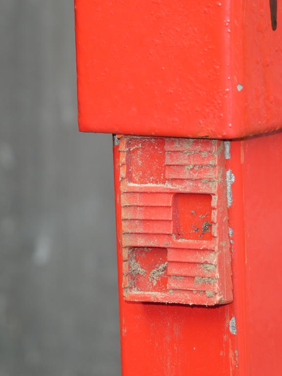

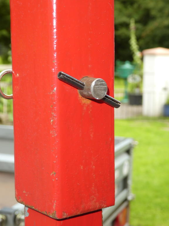

Stormin 4,458 #46 Posted August 30, 2018 On 29/12/2017 at 7:26 PM, the showman said: This is the FINAL update. Oh no it's not! Chris said he was thinking about selling the gantry, as he has acquired an engine crane. So in exchange for a bob or two, the gantry made the trip North. He neglected to supply the pins, so I had to make my own. Also marked the top ends and corresponding upright sides. I've used the top holes to give maximum height. A hand ratchet hoist hanging around, now hangs on the gantry. A nice big cable tie keeps it out of the way when not in use. As the i.d. of box section for the top, is slightly bigger than the o.d. of the legs, some side movement was evident. So a couple of wedges fitted and they stopped that. No need to dismantle it, as a tractor sits under it and takes up very little, if any extra space. Dismantled I'd have to find space somewhere to store it. 3 Alan, pmackellow and nigel reacted to this Share this post Link to post Share on other sites
the showman 4,074 #47 Posted August 30, 2018 I see you've scratched the paint as well, pins and touch up paint are an extra 2 pmackellow and Alan reacted to this Share this post Link to post Share on other sites
