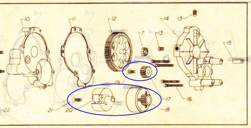

factory 487 #38 Posted September 21, 2019 The Model F is the same gear ratio as the Model J but without the Clutch, I think a digit in missing from the serial number as some of the parts look later than SN #09725. David Share this post Link to post Share on other sites
JUST O&R 237 #39 Posted September 21, 2019 Your rite I missed a number ser # is 097295 and Your rite the f model has no clutch. I'm not sure but I hope the gearbox will fit ? I'm going to try to find the parts first I would hate to take a complete engine apart. If it comes apart it will never be a nos engine again. thanks for the help David. Share this post Link to post Share on other sites
factory 487 #40 Posted September 21, 2019 That number looks right, with a production date of approx 1965. The gearbox will fit fine, the only differences inside are the gears attached to the engine PTO shaft, the clutch & drum gear changes to a standard gear (see parts circled below), all the case parts are the same for both gearboxes. Hopefully you can find the parts to repair the Model J, for the missing tank bracket you could make a temporary one & swap it over if you find an original. David Share this post Link to post Share on other sites
