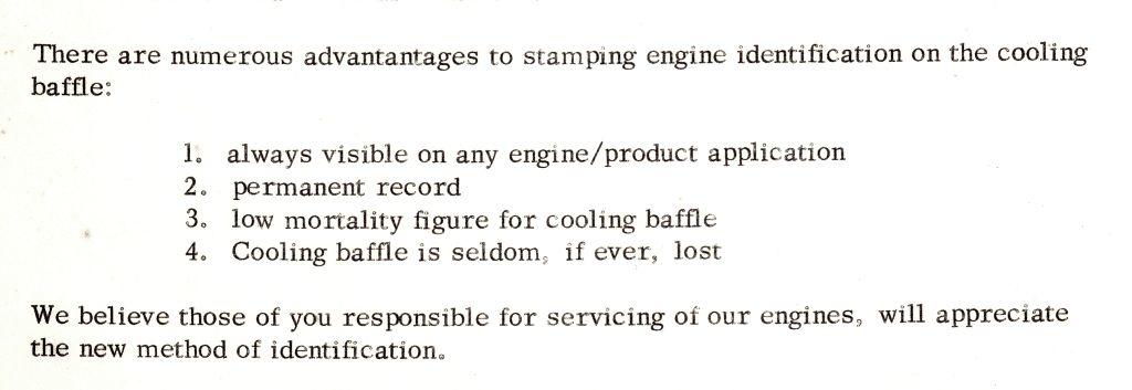

factory 487 #78 Posted November 8, 2019 They have only been on there a long time because they weren't listed with Ohlsson & Rice in the title, always good to have spares of those as they are so often missing, despite what the service bulletin says. David Share this post Link to post Share on other sites
JUST O&R 237 #79 Posted November 8, 2019 (edited) Ya OK WHY ARE THERE SO MANY MISSING ? You don't normally loose the block Edited November 8, 2019 by JUST O&R 2 Wallfish and factory reacted to this Share this post Link to post Share on other sites

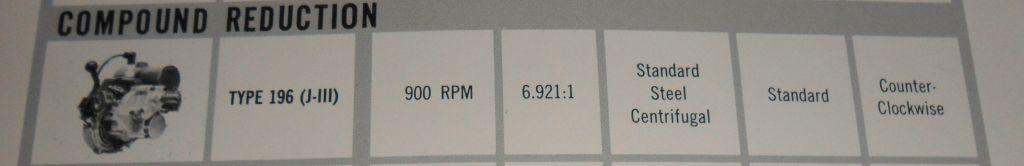

JUST O&R 237 #80 Posted November 9, 2019 Can anyone tell me if these is the same gearbox as the j- II ser 091196 ?? O&R 196.pdf Share this post Link to post Share on other sites
factory 487 #81 Posted November 10, 2019 On 11/8/2019 at 9:49 PM, JUST O&R said: Ya OK WHY ARE THERE SO MANY MISSING ? Usually the original or previous owner takes it apart after something like the starter mechanism breaks and before the web existed they probably couldn't get parts (after O&R/AEP closed down), or figure out how to get it back together, so left it in bits or never put them back on. On 11/9/2019 at 5:12 PM, JUST O&R said: Can anyone tell me if these is the same gearbox as the j- II ser 091196 ?? I will check my info and let you know. David Share this post Link to post Share on other sites
factory 487 #82 Posted November 10, 2019 Yes the Type 196 has the same gearbox as a Model JIII (900 R.P.M. reduction, counter clockwise PTO shaft), but the Type 196 engine has a back-shaft with a flat, part no #42-49. David. Share this post Link to post Share on other sites

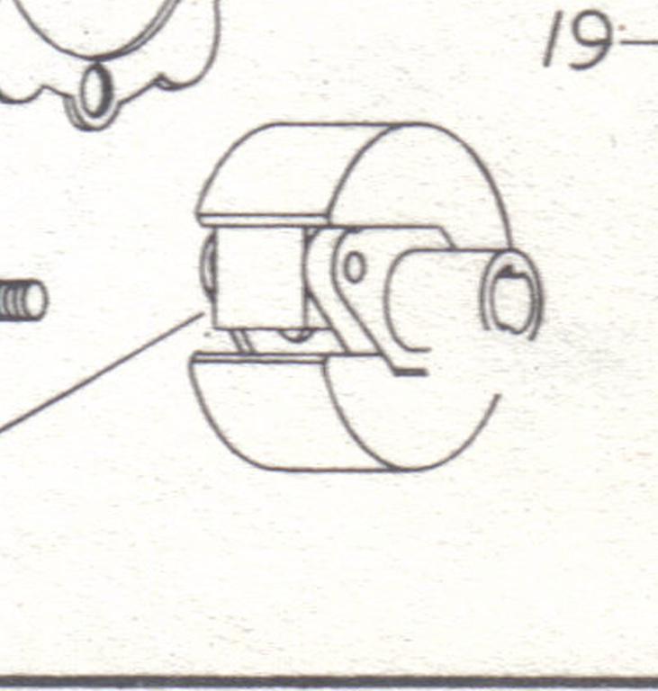

factory 487 #88 Posted November 12, 2019 On 11/10/2019 at 11:09 PM, factory said: I have two pages from 1964 covering older gearboxes, it's too late tonight to add them to the forum. Parts diagrams for the gear case models from 1964 have been cleaned up, turned into a PDF and added to the manuals 'sticky' thread. Note: there may be slightly different parts used in earlier or later gear-cases, for example alloy gears in earlier models, the flat 'D' shaft used for the later clutch (instead of tapered shaft) and updated bearings. I've only just noticed part of drawing for the clutch assembly has a bit of the print missing, I checked and the original (below) is the same. David Share this post Link to post Share on other sites
