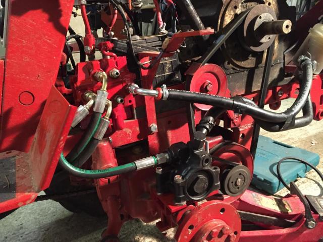

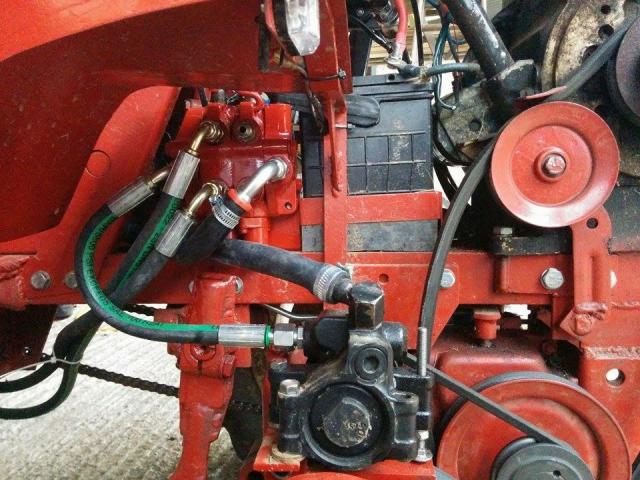

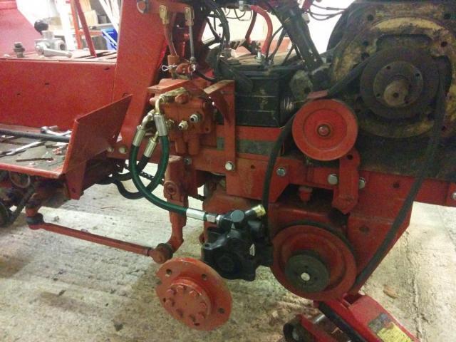

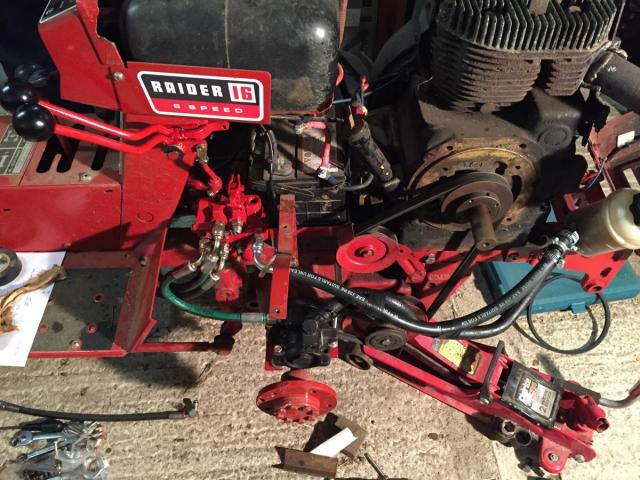

meadowfield 1,901 #351 Posted February 15, 2016 Briefest of updates, bought yet more plumbing and started on mounting the pump, which is clutch driven. Power steering reservoir turned up today. Might have it running next weekend 2 nigel and ranger reacted to this Share this post Link to post Share on other sites
meadowfield 1,901 #352 Posted March 4, 2016 Been a bit slow, busy at work and not very motivated. Bit the bullet today Ewan did a quick video, thanks again to Doug (Ranger) for his assistance. I got there in the end! 7 ranger, jak3_smith, Alan and 4 others reacted to this Share this post Link to post Share on other sites

meadowfield 1,901 #354 Posted March 19, 2016 Might get the hydraulic tank mounted under the seat later Share this post Link to post Share on other sites

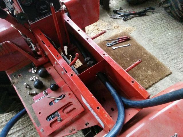

meadowfield 1,901 #355 Posted March 19, 2016 A small break in and amongst other jobs meant I finished off the pipe work. It's all neatly routed behind the fender and through the hood stand. Tank is now under the seat, but I forgot to take a picture. 2 ranger and nigel reacted to this Share this post Link to post Share on other sites

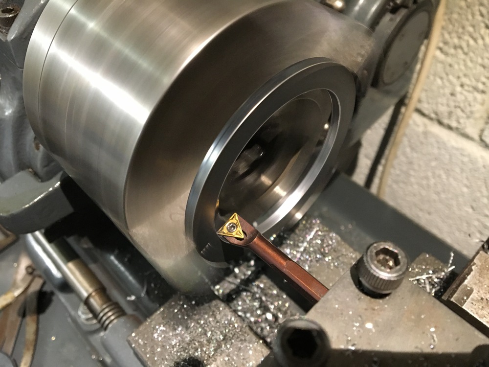

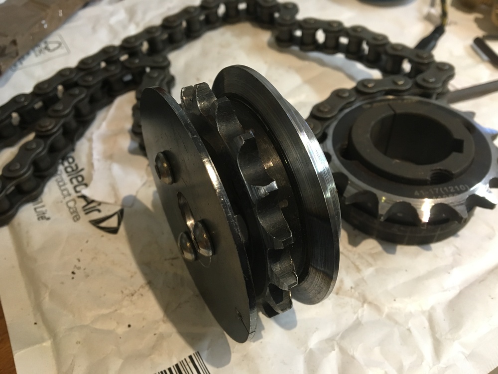

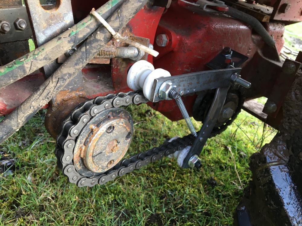

meadowfield 1,901 #357 Posted July 18, 2016 Talked about if for a while, made a start on fixing the rear drive. bought some 78mm laser cut discs and turned them down. The idea being I can use washers to keep the chain on the sprockets to stop it riding over the edge 4 ranger, pmackellow, Stormin and 1 other reacted to this Share this post Link to post Share on other sites

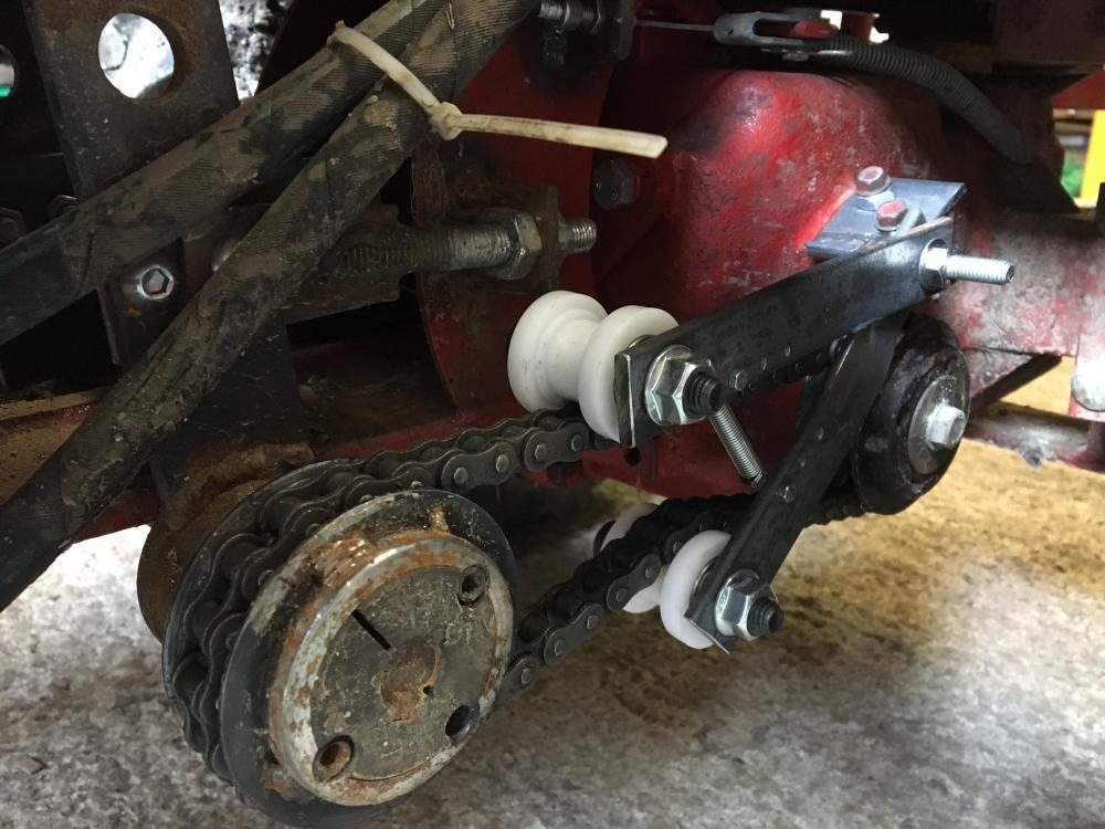

meadowfield 1,901 #358 Posted March 18, 2017 @?!$#!? Finally finished the chain drive and tensioners after a few attempts. however after 10 minutes of playing and getting more articulation the chain still rode up over the flange bending the tensioners and twisting the whole intermediate shaft its so so jammed that it stopped me dead and I can't take the tension off... 2 Cub Cadet and diggerjames reacted to this Share this post Link to post Share on other sites
