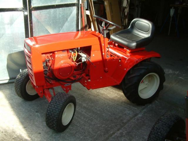

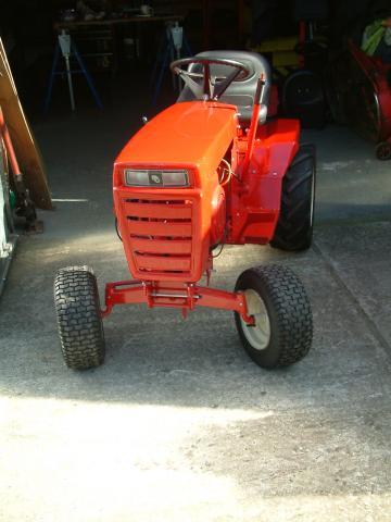

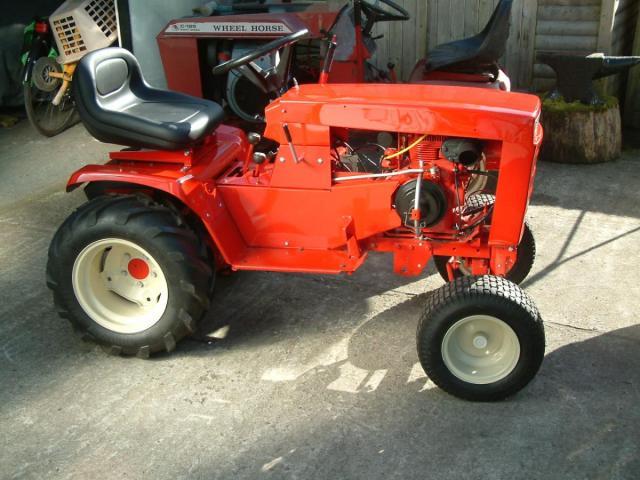

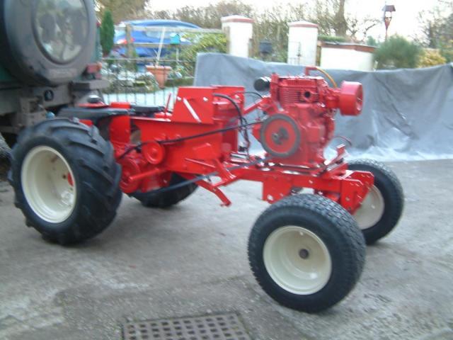

Stormin 4,458 #1 Posted February 21, 2014 Some will recall this Wheel Horse C-81. Bought in the condition you see it. Nicely done by Martin Hurst, who I bought it off well over a year ago. Unfortunately progress has been somewhat slow. Actually practically none existent due to other factors. But hopefully in the next week or so things will progress. Share this post Link to post Share on other sites

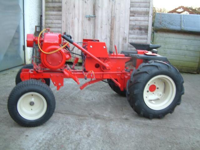

Stormin 4,458 #5 Posted May 28, 2014 Not managed to get much done, but hopefully get the tin ware back from painting by tomorrow. Then a push to get it ready for Newby. Share this post Link to post Share on other sites
meadowfield 1,900 #6 Posted May 28, 2014 Hurry up and stop gassing then Look forward to seeing it... Share this post Link to post Share on other sites
Stormin 4,458 #7 Posted May 28, 2014 I'm looking forward to it finished. Can't do anymore till the panels are back. Memo to self. Must get a battery. Share this post Link to post Share on other sites

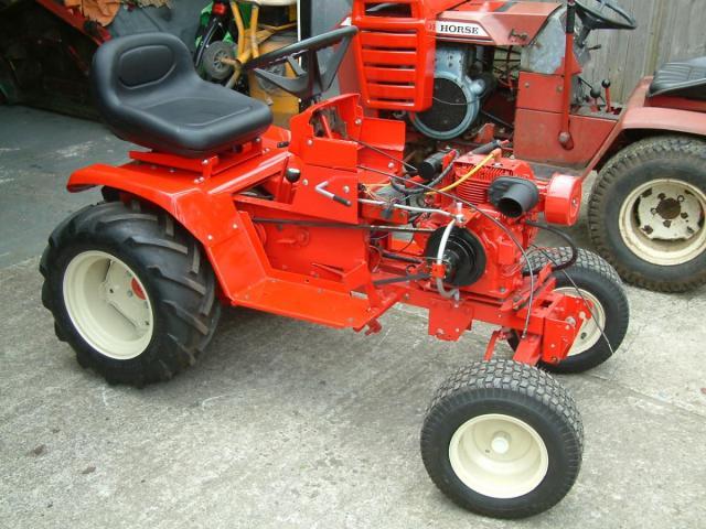

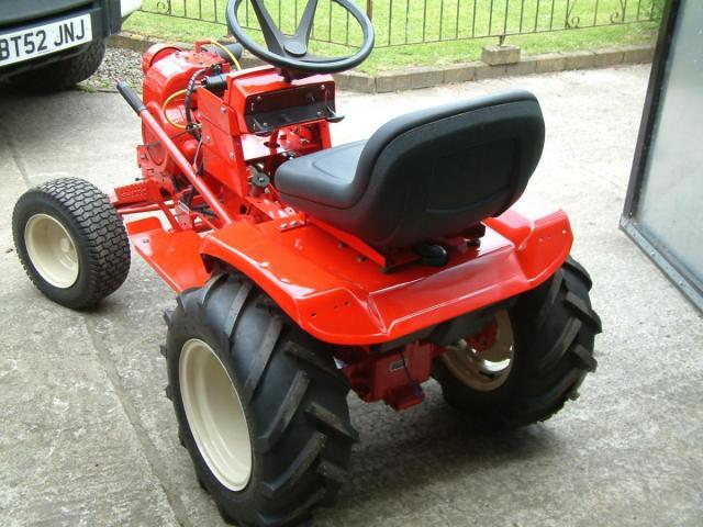

Stormin 4,458 #16 Posted June 3, 2014 Well I managed to get a bit more done today. First The start of play this morning. Rear fender and seat fitted. Dash and control cables fitted. More panels on. Electrics to sort out and then see if I can get it to run. That's for tomorrow. 2 pmackellow and Ian reacted to this Share this post Link to post Share on other sites
Ian 2,417 #17 Posted June 3, 2014 She's looking good Norm, the finish must be in sight.. and then onto the next project Share this post Link to post Share on other sites
Stormin 4,458 #18 Posted June 3, 2014 Still several details to see too, touch up here and there and decals to apply, but that will be most likely after Newby. Some accidental damage to the paint on the hood when one of the dogs knocked it over. Share this post Link to post Share on other sites
