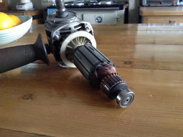

meadowfield 1,901 #1 Posted March 22, 2014 When halfway through grinding or cutting, your tool of choice decides it's had enough. My trusty angle grinder stopped so fierce that it undid the disc and launched it across the garage. The bearing on the end of the armature has seized solid 1 HeadExam reacted to this Share this post Link to post Share on other sites

BeemerNut 0 #13 Posted March 12, 2020 (edited) On 3/22/2014 at 3:42 AM, meadowfield said: When halfway through grinding or cutting, your tool of choice decides it's had enough. My trusty angle grinder stopped so fierce that it undid the disc and launched it across the garage. The bearing on the end of the armature has seized solid My 4 1/2" Bosch angle grinder also started to labor down and when it was off you couldn't turn the flap wheel at all. Lucky it didn't melt and destroy the plastic bearing mounting. The small bearing as in your photo had seized up, it was a shielded bearing now replaced with a sealed bearing a $4.73 USD bearing. Also added a little disc brake wheel bearing grease to the gearbox she's good as new again. Same with Porter Cable power tools, they went cheap installing junk shielded bearings vs sealed as well oiled not greased that had run dry and failing bearings. Everyone now sealed bearings. Milwaukee power tools made in China rubbish living off their past tool reputation of their older made in the USA Milwaukee tools. Lucas and Bosch starter motor in the 95 Land Rover Discover were all rubbish, the Nippon starter out lasting them all. Good thing a 5 speed and can bump start it a rare vehicle in the USA vs automatic transmission rubbish. Edited March 12, 2020 by BeemerNut Share this post Link to post Share on other sites
