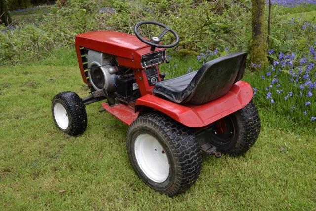

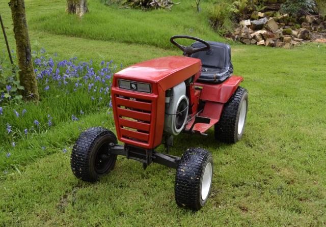

WestwoodGazelle 106 #1 Posted May 20, 2014 Hi all, This is my Wheelhorse C-100 from 1975 I have owned since 2005. It is a 10hp Kohler and is my first ever ride-on. One day when I have my own place I'd love to restore it it perfect condition but for now she's used for gardening jobs. This is one I definitely want to keep forever though. Share this post Link to post Share on other sites
meadowfield 1,901 #2 Posted May 20, 2014 Hey Jon, Glad to see you back posting, nice horse! Looks like it needs some decals.... Share this post Link to post Share on other sites
neil 524 #3 Posted May 20, 2014 she is a beauty,just neends the decals ,like Mark said Share this post Link to post Share on other sites
Ian 2,417 #4 Posted May 20, 2014 A fine looking machine Jon The tow hitch looks interesting! Share this post Link to post Share on other sites

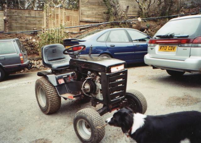

WestwoodGazelle 106 #11 Posted May 29, 2014 (edited) Hi all, I managed to dig out a photo of my Wheelhorse as it was when it arived back in 2005. Luckily it's looking better these days, even though I don't consider it finished. (could do with a fresh lick of paint on the red parts). I did keep the engine silver, when I first painted it ages ago, not really sure why I'd actually forgotten someone must have crashed it since the hood was damaged at the front, I learned a lot about body work straigntening it out. The rest of her was in pretty good shape though and most surprising is how there's effectively no rust on it at all. I also brought the light lens and light box for behind so I'll have to wire up the lights when I do the repaint at some point. Edited May 29, 2014 by WestwoodGazelle 1 nigel reacted to this Share this post Link to post Share on other sites
meadowfield 1,901 #12 Posted May 29, 2014 They don't really suit black do they.... Share this post Link to post Share on other sites
Stormin 4,458 #13 Posted May 29, 2014 The tractor or the collie? I like the black chassis and axles with the red bodywork. Share this post Link to post Share on other sites
WestwoodGazelle 106 #14 Posted May 29, 2014 I agree Mark, not to mention it was brush painted thickly over gloss red underneath That's my faithful dog Poppy when she was only two (ten years old now). Glad you like the paint scheme, I thought it was a nice little throwback to it's earlier life Share this post Link to post Share on other sites

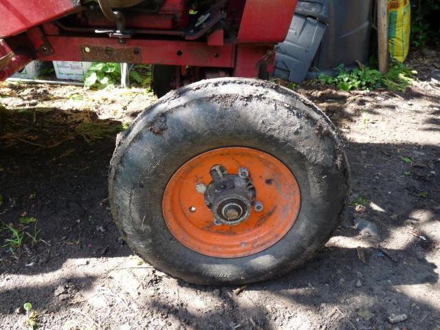

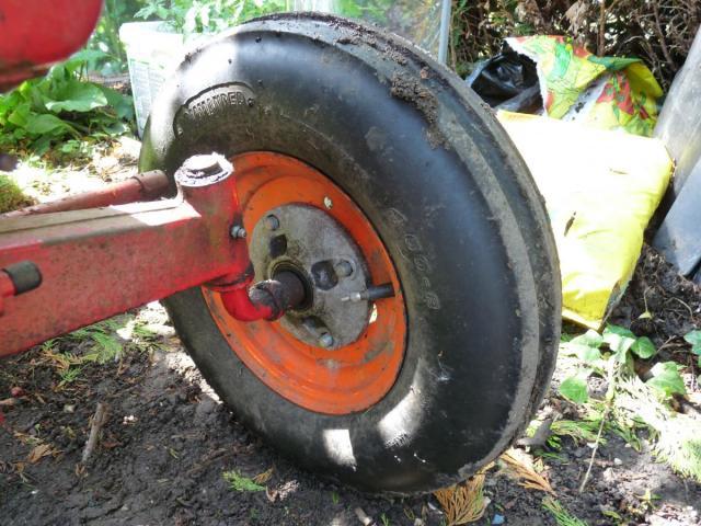

ranger 373 #19 Posted May 30, 2014 Hi W/Gazelle I fitted John Deere 279 deck spindle housings minus the shafts to the front stub axles of my C121 these have 3/4" bore bearings the same as the Wheelhorse I scrounged these from a customer of ours-a council mower shop whose policy was if the bearings are shot,change the whole assembly! If a walk behind mower needed more than a spark plug to repair it -it was scrapped! I bought a box of new bearings from the USA for these and fitted a couple of nice narrow Howard/ Dowdeswell rotavator wheels along with 4.00 x 8 tri rib tyres. These housings have four threaded holes to attach them to the deck,these now take the wheel bolts.They almost lined up,just a touch with a file needed, tube spacers then fitted to give the track width I wanted. regards Doug. 1 WestwoodGazelle reacted to this Share this post Link to post Share on other sites

ranger 373 #23 Posted June 7, 2014 Hi again, some photos of the John Deere 279 mower deck spindles converted to front wheel hubs. The holes are not threaded as i thought, I threaded them M10. The wheels are off a Howard rotavator. 1 WestwoodGazelle reacted to this Share this post Link to post Share on other sites
WestwoodGazelle 106 #24 Posted June 8, 2014 Nice job on the spindles there Doug! Looks like a good bit of work. However, since I am not the most skilled mechanic in the world/England/Devon/my house, if there was an option where I could just swap like for like easily, I would appreciate the link, Richard. Share this post Link to post Share on other sites
ranger 373 #25 Posted June 8, 2014 No machining other than tapping threads for wheel bolts. The spindles were knocked out of the bearings, new bearings pressed in, (the same size) and the hubs fitted to the W/H front spindles just like the original wheels. The beauty of this conversion is being able to fit narrow wheels, I think the stud P.C.D ( pitch circle diameter) is either 100mm or 4") plenty of wheels like these are available. Check out the local mower shop, private or council and see what they have in the scrap bin. Councils seem to like the John Deere rideons. regards Doug. Share this post Link to post Share on other sites
