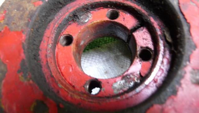

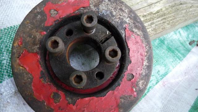

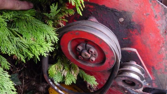

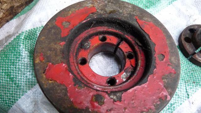

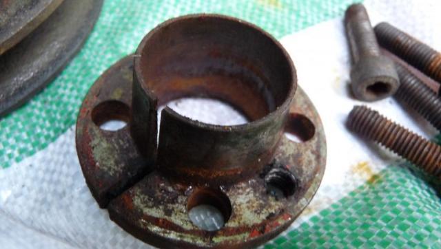

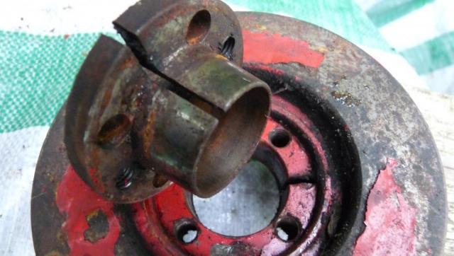

ranger 373 #33 Posted July 31, 2014 Hi Ian, got PM, sorting it out, Renewing bearings on the BCS flail, pics of the drive pulleys, no keys, the bore of the pulley & the outside of the centre piece have matching tapers,the screws pull the two together very tightly. I assume no keys to allow shock absorption by slipping . I wonder if something like this may help prevent the taperlock breakages you are suffering ? With a lathe I would think they would not be too difficult to makeif an immovable object is encountered 1 Ian reacted to this Share this post Link to post Share on other sites

Ian 2,417 #36 Posted August 1, 2014 Hi Ian, got PM, sorting it out, Renewing bearings on the BCS flail, pics of the drive pulleys, no keys, the bore of the pulley & the outside of the centre piece have matching tapers,the screws pull the two together very tightly. I assume no keys to allow shock absorption by slipping . I wonder if something like this may help prevent the taperlock breakages you are suffering ? With a lathe I would think they would not be too difficult to makeP1020025.JPGP1020024.JPGP1020023.JPGP1020022.JPGP1020021.JPGP1020020.JPGif an immovable object is encountered P1020026.JPG Thanks for that Doug. I think the problem is I'm asking something that wasn't designed for this sort of job to put up with too much strain and weight! I'm hoping the "Wheel job" will take some off the strain out.. Looking at the thickness of some of this metal, I'm thinking..... I wonder what this beast weighs? Have you a local weigh bridge that may be able to help? Would be interesting to find out the weight of this beast, Also.... Once back together and finished, it looks like time for a good old pressure wash, she looks abit dirty.... Hi Charlie, I've no idea how much she weighs, but at a guess I'd say a lot It would be good for her to loose a few kilos.. The dirt can stay for now, all being well she is off to a working weekend next weekend and would only get covered in muck and dust anyway Looks as good as ever Ian, hope it handles and drives better for you! Thank you Sir, I'm hoping it will help the steering and straining out a bit.. I'm also hoping that the farmer does not plow the field behind my house before I've had a chance to give the 6x6 a good thrashing across it.. Well, I need to test the modification's out A small update... The right side outrigger now looks like this.. I hope to have it finished by the end of the day.. Share this post Link to post Share on other sites
