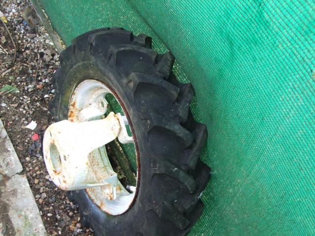

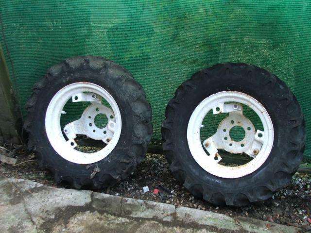

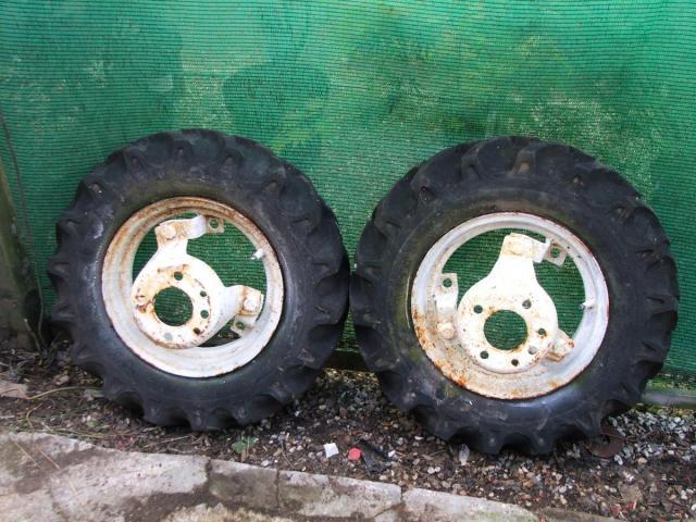

nigel 1,880 #5 Posted July 26, 2014 ive got some duels that could be up for grabs Share this post Link to post Share on other sites
Ian 2,417 #6 Posted July 27, 2014 I like them Ian Custom dual wheel adapter/weights, theres just so many things to make for my tractor you are a bad influence Happy to help ive got some duels that could be up for grabs bay 001.jpgbay 002.jpgbay 004.jpg I forgot you had those tucked out the back Nigel, what did they come from? Share this post Link to post Share on other sites
Wristpin 400 #7 Posted July 27, 2014 The dual set up with weights certainly looks the part but I would guess could be a bit hard on the half-shafts particularly if used with that blade on the front? Share this post Link to post Share on other sites
nigel 1,880 #8 Posted July 27, 2014 Happy to help I forgot you had those tucked out the back Nigel, what did they come from? bolens Share this post Link to post Share on other sites

meadowfield 1,900 #11 Posted July 27, 2014 That's an interesting setup Nigel... Share this post Link to post Share on other sites
Ian 2,417 #12 Posted July 28, 2014 The dual set up with weights certainly looks the part but I would guess could be a bit hard on the half-shafts particularly if used with that blade on the front? I never has any problems with half-shafts even when using the blade very hard pushing dirt about and that was when the Wh still had it's original trans with 1 inch diameter shafts! bolens I should of guessed that Share this post Link to post Share on other sites
