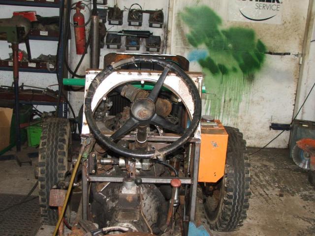

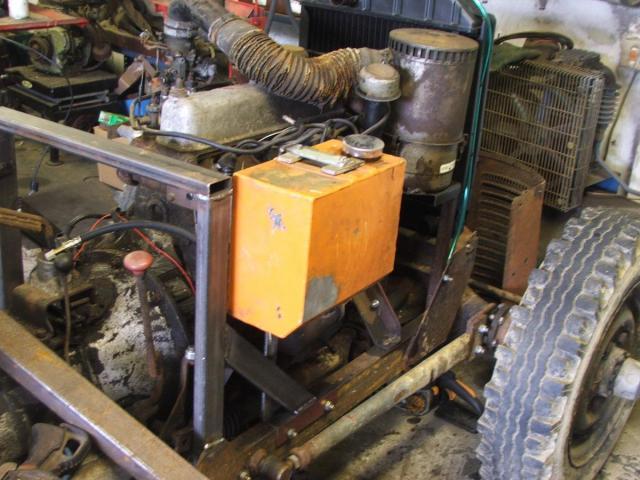

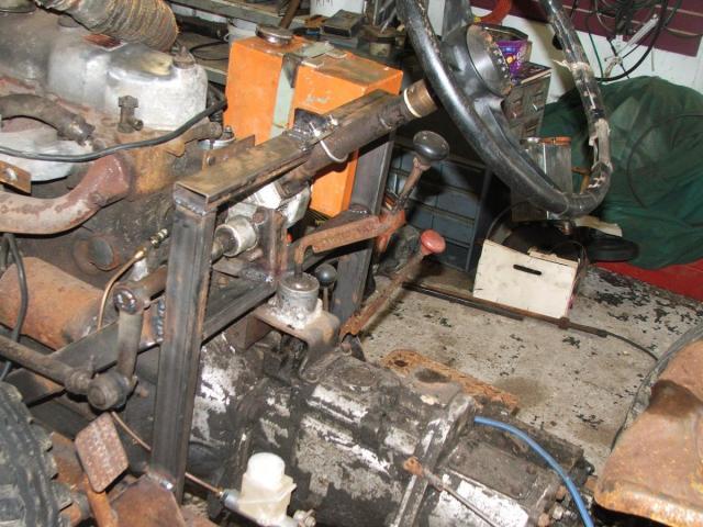

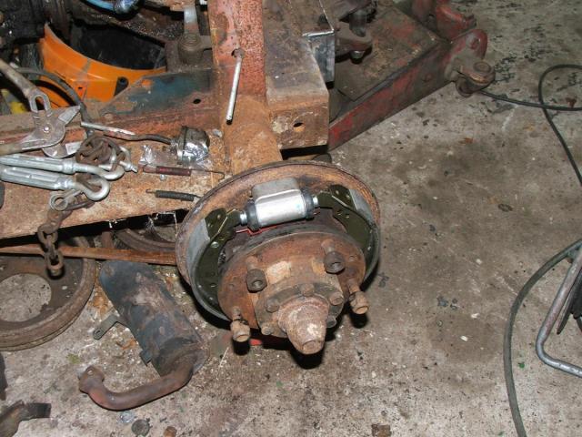

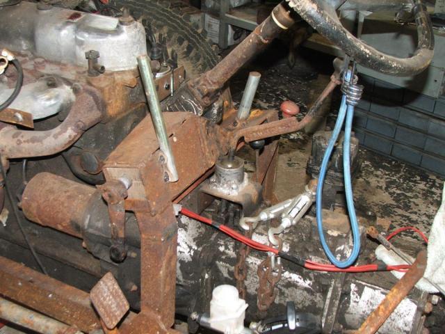

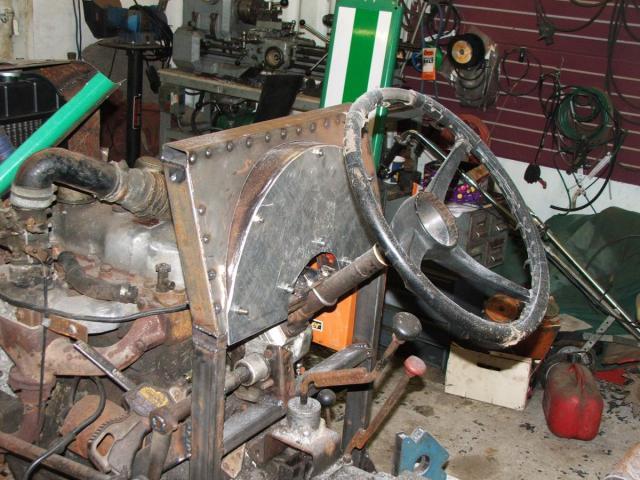

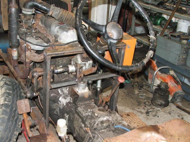

nigel 1,881 #27 Posted October 13, 2014 my boy and i did a bit today ,cut of old steering made new bolt on frame,fitted fuel tank, got rid of the wooden block and fitted bearing for steering,new wheel cylinders and shoes 1 rotoscytheben reacted to this Share this post Link to post Share on other sites
Ian 2,417 #28 Posted October 13, 2014 Some fast progress going on there.. The steering looks much better and safer with the bearing fitted Share this post Link to post Share on other sites
diggerjames 543 #29 Posted October 13, 2014 Looking good mate Share this post Link to post Share on other sites
meadowfield 1,901 #30 Posted October 13, 2014 Good work Share this post Link to post Share on other sites
Stormin 4,458 #31 Posted October 13, 2014 I take it you'll not be going far with it, judging by the size of what I take to be the fuel tank. Doing well though. Share this post Link to post Share on other sites
nigel 1,881 #32 Posted October 14, 2014 I take it you'll not be going far with it, judging by the size of what I take to be the fuel tank. Doing well though. ime going to build a beer keg trailer norm to carry extra petrol 1 Stormin reacted to this Share this post Link to post Share on other sites

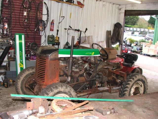

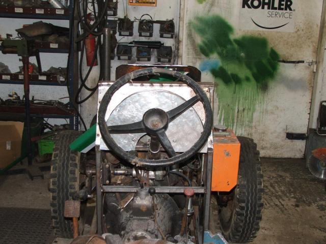

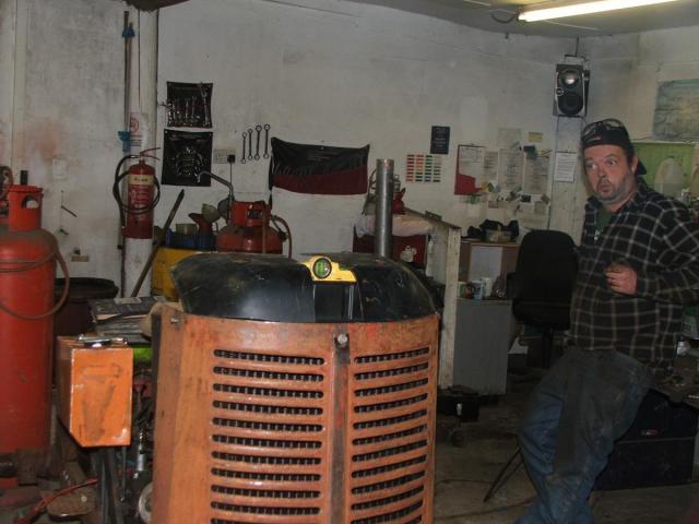

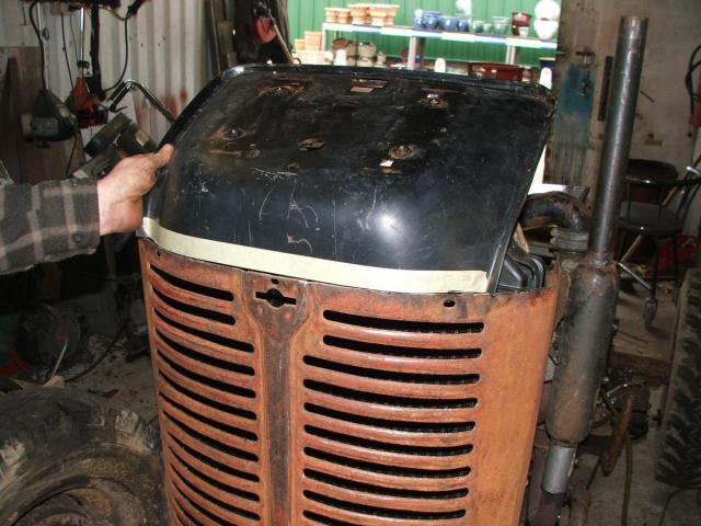

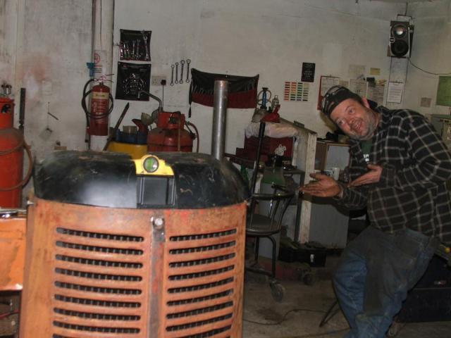

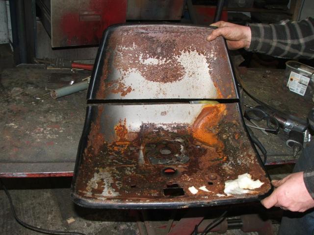

nigel 1,881 #33 Posted October 15, 2014 did a bit more today it took most of the day getting the 2 front wheels of just could not get the nuts undone and i had to resort to heat any way thought i would work out a nose cone to get over the tall tractor radiator, so i got a westwood tractor seat and cut it up this should do the job, ian made a visit and gave me a hand thanks mate 3 meadowfield, rotoscytheben and Ian reacted to this Share this post Link to post Share on other sites
Stormin 4,458 #34 Posted October 15, 2014 That doesn't look level. Share this post Link to post Share on other sites
Ian 2,417 #35 Posted October 16, 2014 Ian made a visit and gave me a hand thanks mate Your welcome mate, put two similar warped mechanical minds together and anything could happen 1 meadowfield reacted to this Share this post Link to post Share on other sites
diggerjames 543 #36 Posted October 16, 2014 Looking good Nigel love your twos ingenuity Share this post Link to post Share on other sites

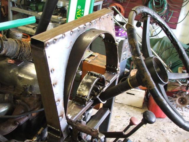

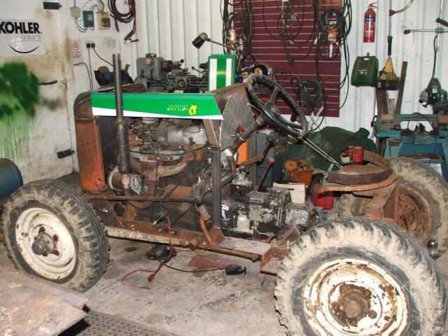

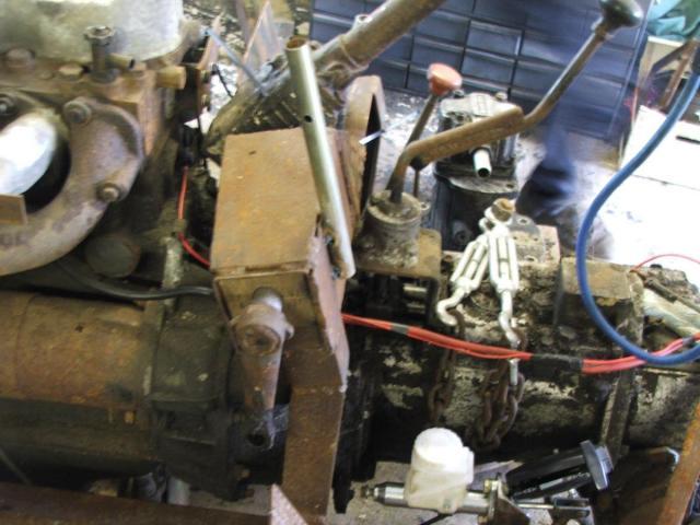

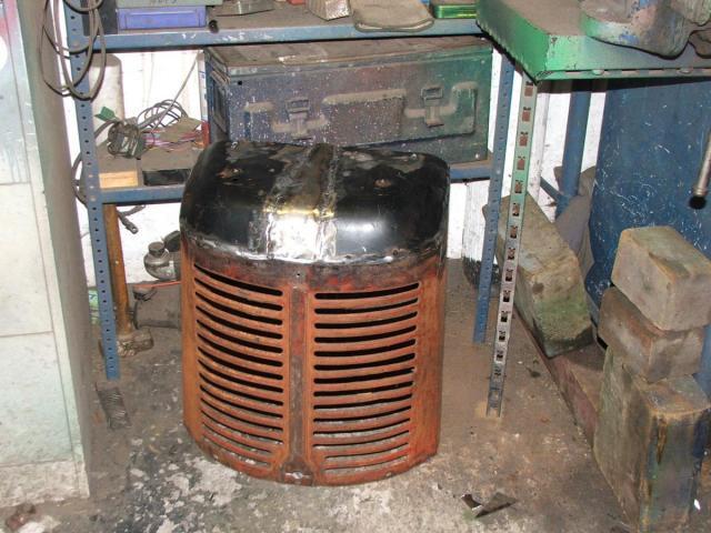

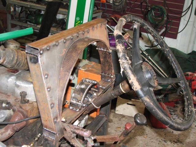

nigel 1,881 #37 Posted October 18, 2014 nose cone welded up /we now have a hydrolic clutch that works and propper steering 1 rotoscytheben reacted to this Share this post Link to post Share on other sites
meadowfield 1,901 #38 Posted October 18, 2014 Getting there Nigel Share this post Link to post Share on other sites
Ian 2,417 #39 Posted October 18, 2014 You finished the nose cone without me mate!! :o It does look rather good.. An inspired idea you had Share this post Link to post Share on other sites

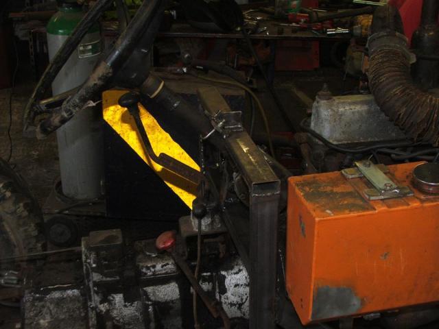

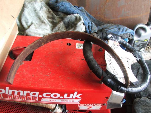

nigel 1,881 #49 Posted October 22, 2014 started making a dash today so i found an old wooden water but and cut one of the metal rings of it and welded it in then coverd it with a bit of alley plate this should look ok when the rest is painted a dark colour behind it 7 slf-uk, Vinnetrow, ranger and 4 others reacted to this Share this post Link to post Share on other sites
Stormin 4,458 #50 Posted October 22, 2014 That's lookin' good, Nigel. 1 nigel reacted to this Share this post Link to post Share on other sites
