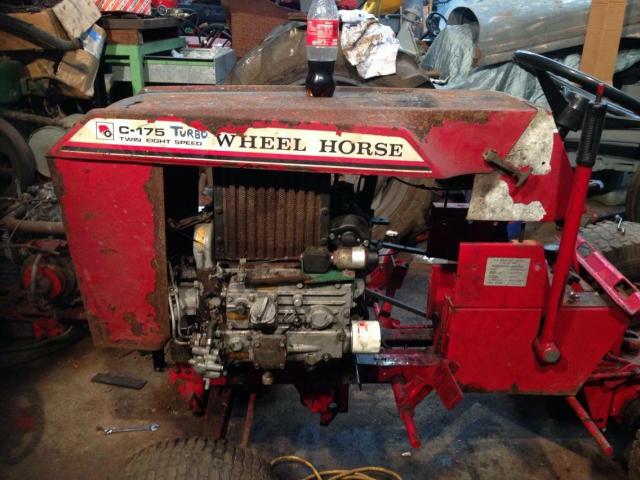

the showman 4,074 #151 Posted January 5, 2016 That looks awesome will the hood still fit ? Share this post Link to post Share on other sites
diggerjames 543 #152 Posted January 5, 2016 That looks awesome will the hood still fit ? yes and no Chris it will fit with the hinges length end and the console lifting but yeah it should be great 1 Joe the small engine man reacted to this Share this post Link to post Share on other sites

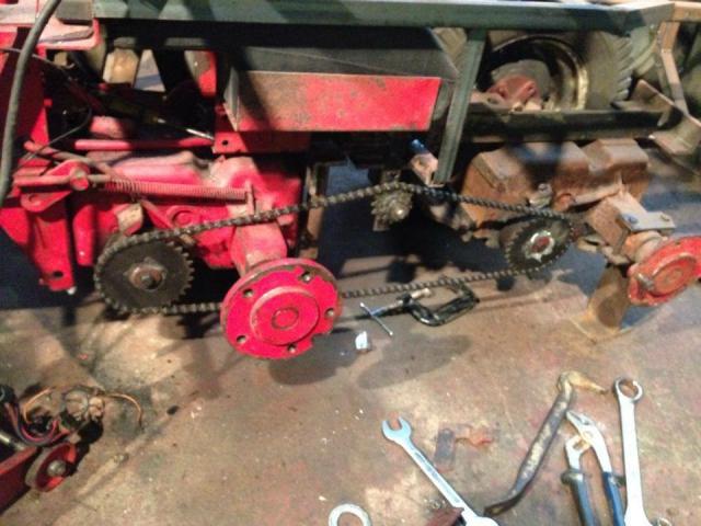

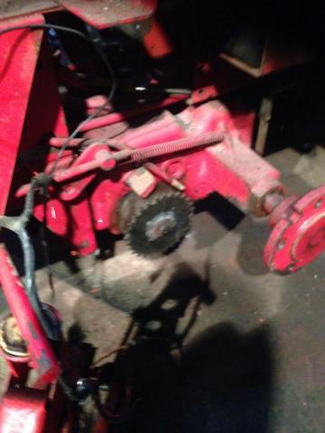

diggerjames 543 #159 Posted January 6, 2016 A bit more progress today guys I've fastend the 4x4 drive chain up to the rear axle here is what I have done so far Share this post Link to post Share on other sites
Stormin 4,458 #160 Posted January 6, 2016 If that rear axle swivels, James, won't the chain catch the front axle, when the left hand wheel drops? Maybe the idler sprocket should be further forward? Or is the rear down as far as it will go in the photo? Share this post Link to post Share on other sites
meadowfield 1,901 #161 Posted January 6, 2016 nice work, as long as the chain doesn't go too tight not an issue it is touches the axle really. My chain on bendy has stretched and now the axle is the idler Share this post Link to post Share on other sites
Stormin 4,458 #162 Posted January 6, 2016 If it does touch, I'd be inclined to fit a wear pad to stop it wearing a groove in the axle. 1 diggerjames reacted to this Share this post Link to post Share on other sites
diggerjames 543 #163 Posted January 6, 2016 I may end up putting a spring loaded tensioner on to compensate for this I'm hoping to sort a bit more in it tomorrow Share this post Link to post Share on other sites
meadowfield 1,901 #164 Posted January 6, 2016 You may end up with the tensioner fixed and on the low side. On C4 when I reverse the chain can skip! Share this post Link to post Share on other sites

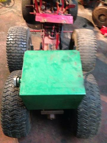

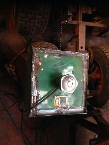

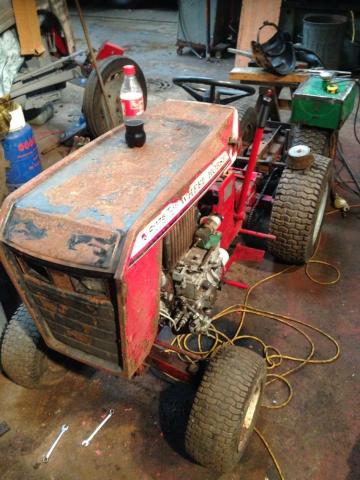

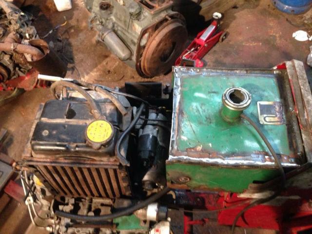

diggerjames 543 #170 Posted January 9, 2016 Hi all been busy on the tractor I thought to my self before I go any further on the project I would test drive it and test the articulation with the chain on etc bearing in mind I don't want it to twist to far and let the chain slip so I've tested it on a ramp and took a few measurements on the angle and I'm quite pleased with the results of the first test !http://youtu.be/Ru7qvO6TIyA After that test I've decided to take the rear load body off and make a new fuel tank which I have made out of a big old ransomes mower diesel tank it was to big so I cut it in half and welded it back together again here is what I have done so far Now that the tank is nearly done I have not got to think about the bonnet and steering console etc because the kubota. Engine is a big lump it sticks proud of the original alignment of the bonnet so I have lifted the bonnet 3 inches on the bonnet and and 2 inches at the moment on the console. I put longer bolts in the con sole with nuts on under the console so I can make adjustments so I no my exact size I need to make the plates etc 7 Stormin, C-101plowerpower, meadowfield and 4 others reacted to this Share this post Link to post Share on other sites
