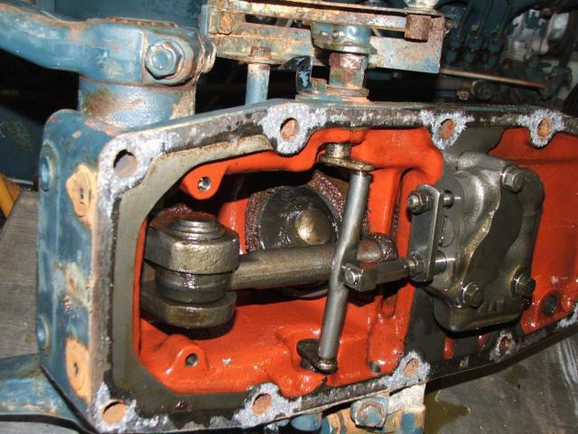

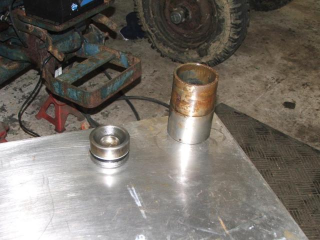

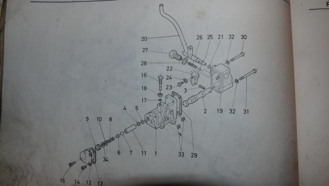

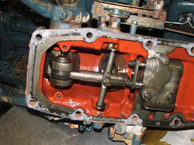

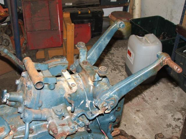

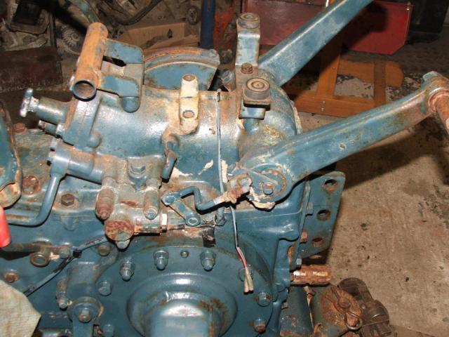

Stormin 4,458 #26 Posted November 19, 2014 I know nothing about these tractors, but I'm wondering if that screw that locks the arms is working right. Maybe a broken locating spigot or spring? Can it be removed easily to see if a bit is broken off the end of the screw? Or should I just keep quiet? Share this post Link to post Share on other sites

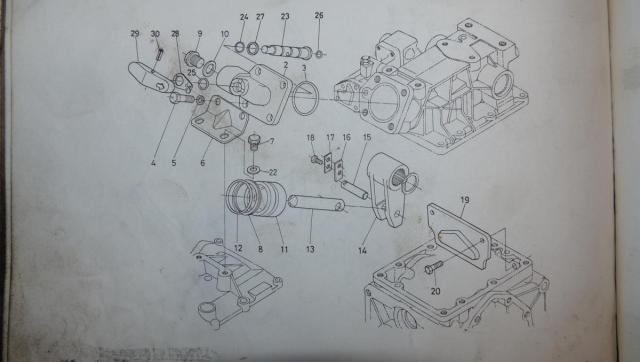

ranger 373 #27 Posted November 19, 2014 Hi Nigel. I've got a parts book for a B6100 if thats any use. Share this post Link to post Share on other sites
Tom 215 #28 Posted November 19, 2014 Hi, I will have a quick look to see what I have got. Stormin could well be right as I have heard of this happening before, I can't remember how much of a job it is to look. However with you saying there is a clonk makes me think something is broken internally which is preventing it from moving. Before you split it I will speak to my uncle who works with these things every day and see what he has to say, he may have come across something like this before. Tom Share this post Link to post Share on other sites

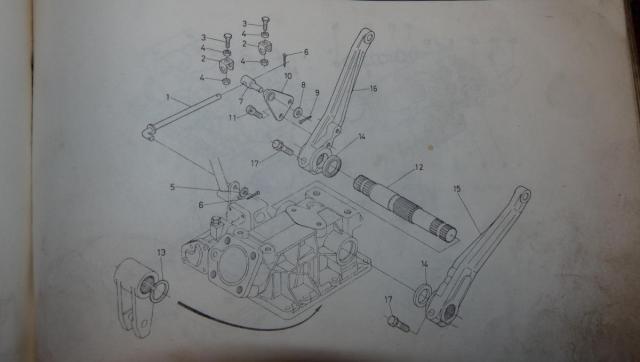

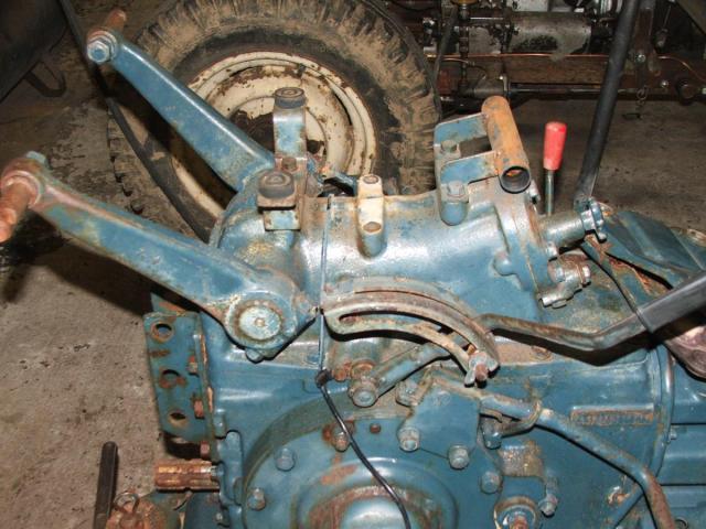

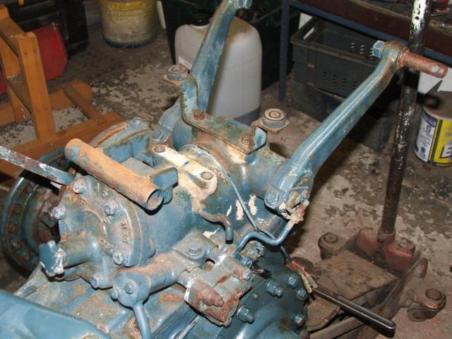

nigel 1,881 #29 Posted November 20, 2014 I know nothing about these tractors, but I'm wondering if that screw that locks the arms is working right. Maybe a broken locating spigot or spring? Can it be removed easily to see if a bit is broken off the end of the screw? Or should I just keep quiet? your thinking on the same lines as me norm doug thanks for the picts but mine looks differant to yours i think tom that would be great if you can speak to him maybe he has a diagram? anyway he are some close up picts Share this post Link to post Share on other sites
ranger 373 #30 Posted November 20, 2014 Hi Nigel The layout looks pretty similar, if you remove the end cap with the knob on I would think you should see the end of the piston, maybe it has seized in the bore -water in the oil- and the `clunk' is the play between the pushrod and the piston Doug. Share this post Link to post Share on other sites
nigel 1,881 #31 Posted November 20, 2014 good thinking doug ime going to leave it til sataday in case any one else comes up with more bright ideas before i rip into it Share this post Link to post Share on other sites

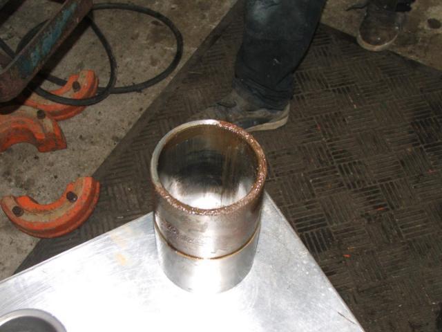

nigel 1,881 #32 Posted November 22, 2014 update we have sussed it and you were all right it was a mechanical fault and a hydrolic fault basicly the connecting rod had dropped out of the piston cos the piston had seized up in the liner, many thanks to every one for your imput Share this post Link to post Share on other sites
the showman 4,074 #33 Posted November 22, 2014 Well sorted mate, that's good news Share this post Link to post Share on other sites
Tom 215 #34 Posted November 22, 2014 Glad to hear you sorted it, great news! Tom Share this post Link to post Share on other sites

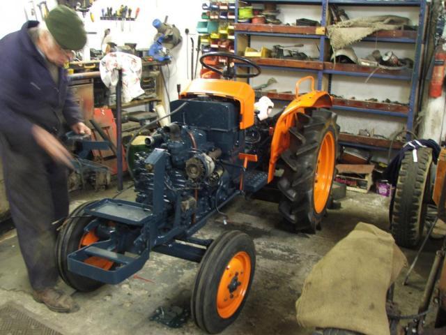

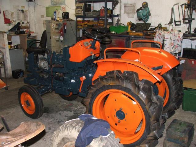

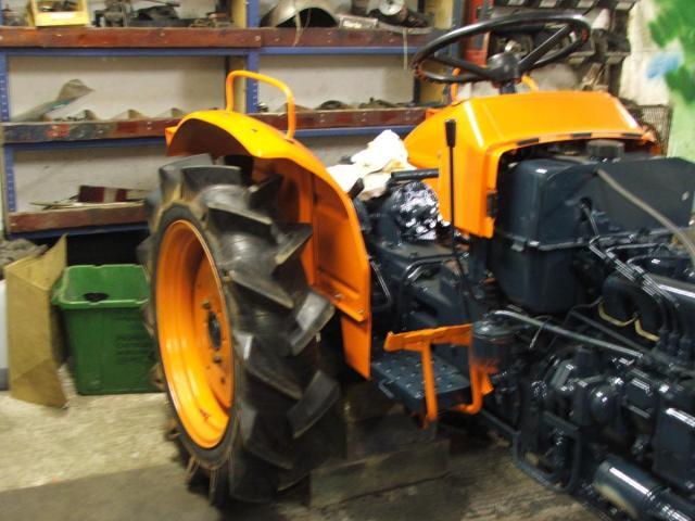

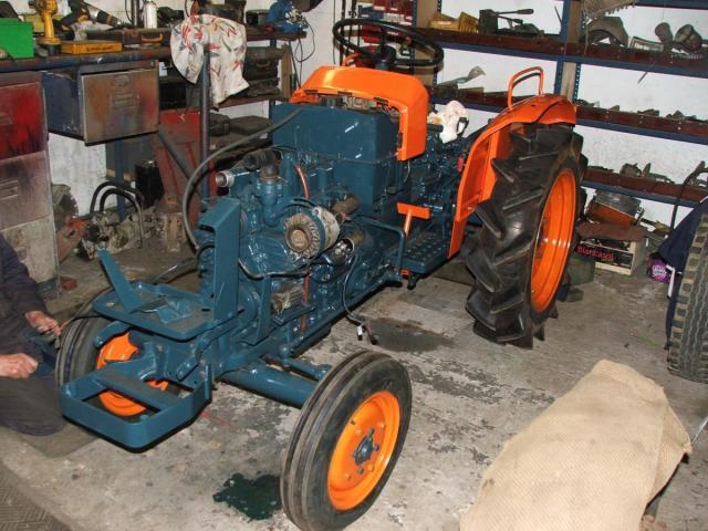

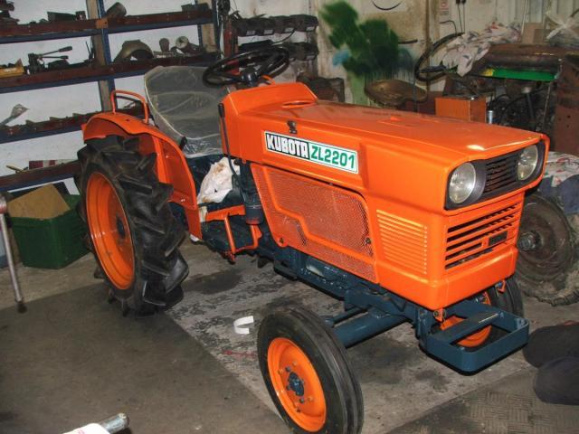

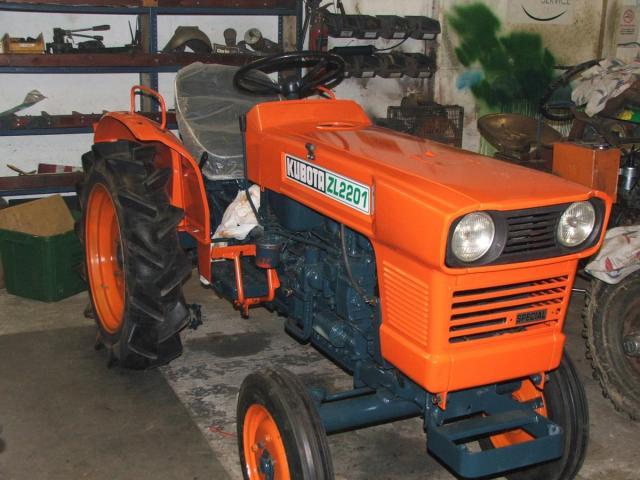

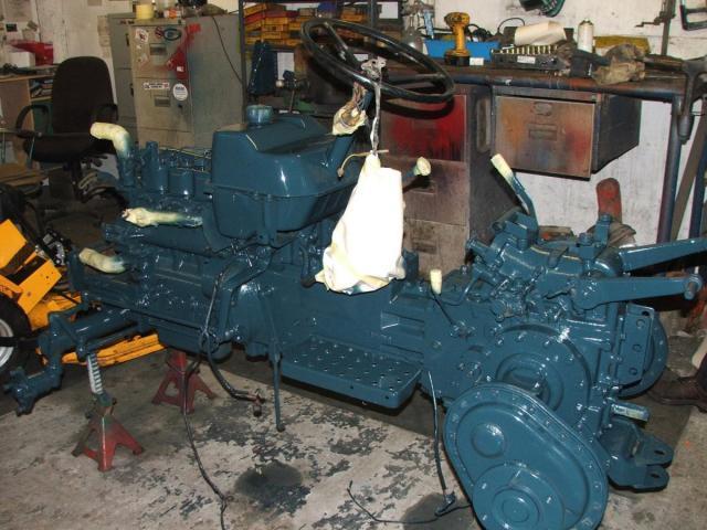

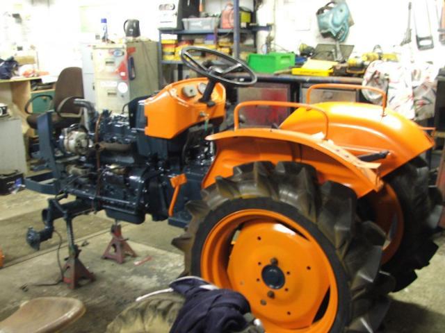

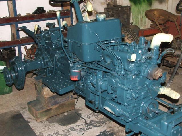

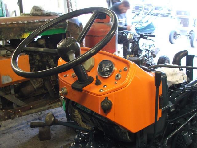

nigel 1,881 #35 Posted November 29, 2014 done a bit more on her 1 ranger reacted to this Share this post Link to post Share on other sites
ranger 373 #36 Posted November 29, 2014 Looking good, at least nothing broken. 1 nigel reacted to this Share this post Link to post Share on other sites
Charlie Smith 192 #37 Posted November 29, 2014 Looking really smart 1 nigel reacted to this Share this post Link to post Share on other sites
bowtiebutler956 166 #38 Posted December 4, 2014 Very nice work Nigel! Those Kubota's are very tough little rigs. Your sure doing right by that one. Matt 1 nigel reacted to this Share this post Link to post Share on other sites
Ian 2,417 #39 Posted December 4, 2014 It looks even better now it has wheels, wings and a new seat on it Share this post Link to post Share on other sites
pmackellow 2,738 #40 Posted December 4, 2014 Blimey Nige that's going to look a bit posh mate Share this post Link to post Share on other sites
Stormin 4,458 #41 Posted December 4, 2014 Wings?? He's not going try and fly it, is he? Share this post Link to post Share on other sites

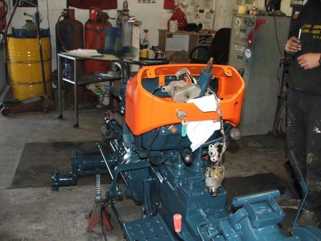

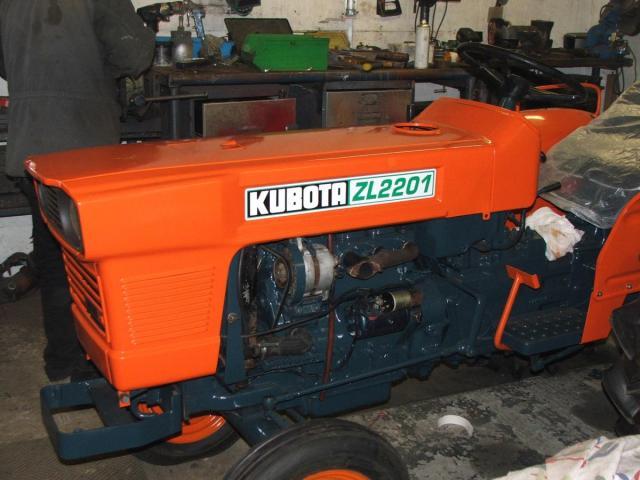

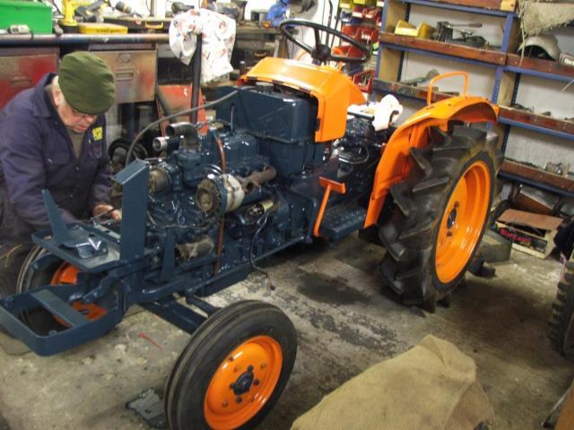

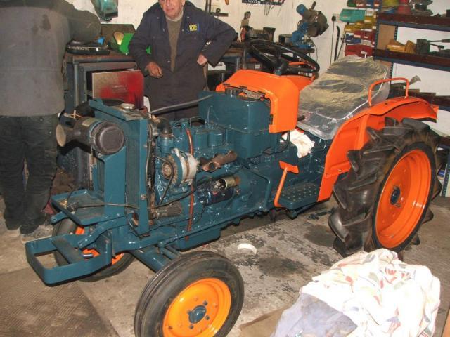

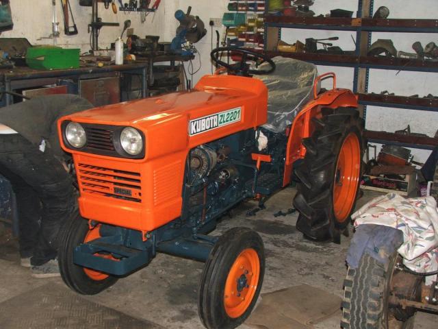

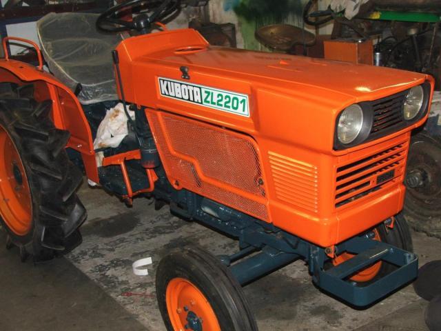

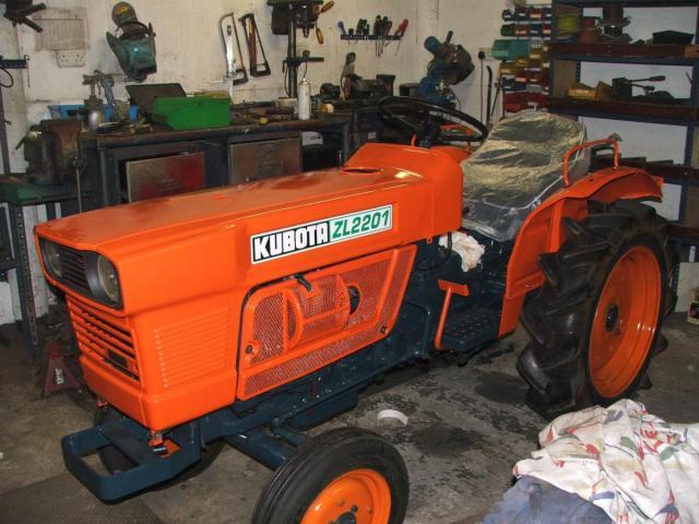

nigel 1,881 #42 Posted December 5, 2014 bit more done not far off now 5 pmackellow, Triumph66, ranger and 2 others reacted to this Share this post Link to post Share on other sites
Stormin 4,458 #43 Posted December 5, 2014 That's nice, Nigel. Superb job by the gentleman doing the work, while you sup tea. Share this post Link to post Share on other sites
meadowfield 1,901 #44 Posted December 5, 2014 Looking good, doc you sort the lift? Share this post Link to post Share on other sites
nigel 1,881 #45 Posted December 5, 2014 That's nice, Nigel. Superb job by the gentleman doing the work, while you sup tea. thats ian doing the tea supping, ime doing the photos, havent a clue who the other old fellow is, i seem to have inherited him Looking good, doc you sort the lift? yes mark go back in the post and you will see what the problem was Share this post Link to post Share on other sites
meadowfield 1,901 #46 Posted December 5, 2014 Oops, need to pay attention! Share this post Link to post Share on other sites
Stormin 4,458 #47 Posted December 5, 2014 So do I. Sorry Ian, didn't mean to upset you. Share this post Link to post Share on other sites
nigel 1,881 #48 Posted December 5, 2014 i dont know which is uglier this tractor or ian 1 Ian reacted to this Share this post Link to post Share on other sites
Triumph66 1,256 #49 Posted December 5, 2014 i dont know which is uglier this tractor or ian No contest; it's Ian. Tractor looking good by the way Nigel 1 nigel reacted to this Share this post Link to post Share on other sites
pmackellow 2,738 #50 Posted December 5, 2014 Tractor looks great Nigel, I see Dennis is supervising the job !! 2 nigel and rotoscytheben reacted to this Share this post Link to post Share on other sites
