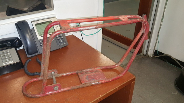

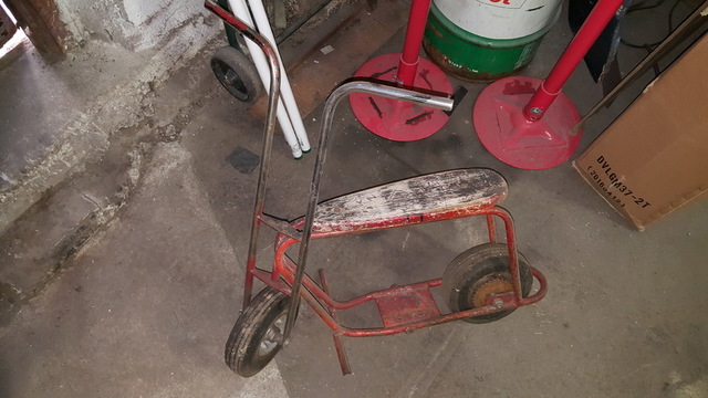

krackermeal55 6 #3 Posted August 31, 2016 I must be a lucky guy, cause I've still got mine!!! And, just recently discovered it's history, and Rarity!! Resto has already started. 3 Wallfish, Alan and factory reacted to this Share this post Link to post Share on other sites
krackermeal55 6 #4 Posted August 31, 2016 I've determined mine had the P7 TAS engine, obviously. So, the search is on. Need everything not on the bike. Should be like finding a hen with teeth Share this post Link to post Share on other sites
Wallfish 724 #5 Posted August 31, 2016 Nice! Bet we can probably help if you want to power it with an O&R. Share this post Link to post Share on other sites
krackermeal55 6 #6 Posted August 31, 2016 Thank you! I just may do that. If I can't find a P7, or if I decide to use the motor I believe to be better designed. I am most likely going to deviate from how my bike was when new. I like the blue paint much better from an aesthetic viewpoint. There are no serial numbers or I.D. on the frame, so I can build it with late or early production specs if I want. I may port the lil 'smoker and up the carb size just for fun...lol. Either way, it's gonna be awesome to see it done, and hear it run again. It's my very first piston motor as a lil gearhead. Popped my cherry, if you will. Lol. Ken Share this post Link to post Share on other sites
Wallfish 724 #7 Posted August 31, 2016 The better designed engine will be the P7, the Japanese ripped off the basic design but made improvements which made their version much more reliable. Those guys always seem to engineer a good engine. To be quite honest, the O&Rs are good for collecting, not so reliable for constant use. Share this post Link to post Share on other sites

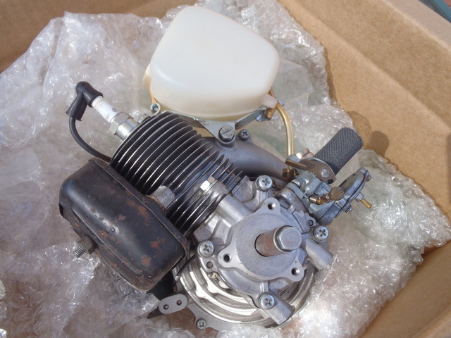

Webhead 95 #8 Posted September 1, 2016 How about an NOS P5? For Sale. 1 krackermeal55 reacted to this Share this post Link to post Share on other sites
krackermeal55 6 #9 Posted September 1, 2016 WOW that's sweet!!!! I was offered another N.O.S. P5 from a member of a different site too!! Maybe I'll buy Both!! How much do you need to get for that? Ken Share this post Link to post Share on other sites

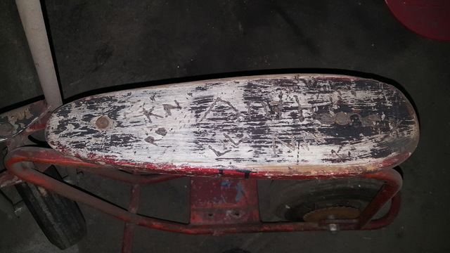

H Killackey 8 #12 Posted April 29, 2018 Hello Everyone. I'm trying to restore a Little Petro. My wife had one 50+ years ago. I need HELP. I need : Seat, Chain Guard/Cover, a better Tanaka Engine and/or carburetor rebuild kit, Engine mounting bracket, Gas tank, Blue Hand grips. Maybe you have a chain guard or a seat .... and a mold could be made OR maybe you have a mold? If you have any Little Petro parts or a lead from some please Private Message me or send info to hkillackey@aol.com . Thanks Share this post Link to post Share on other sites
H Killackey 8 #13 Posted April 29, 2018 The bike I need help with. See my above post. Share this post Link to post Share on other sites

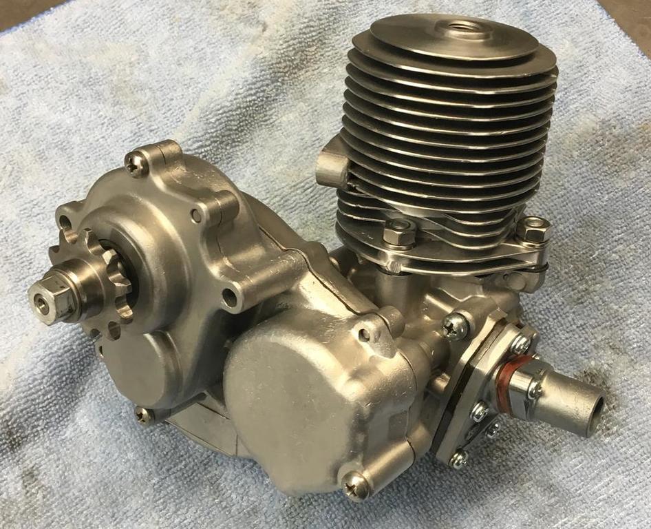

H Killackey 8 #14 Posted December 23, 2018 (edited) My Little Petro motor TANAKA TAS P7 has been restored rebuilt. Does anyone know if the Clutch is a WET Clutch OR a DRT Clutch? That clutch is inside a compartment that has gears. The cover that contains the clutch and gears has to large screws for oil fill and drain at the bottom ... So if that compartment is filled will oil ..... Its a Wet clutch .... It will grab ? Engine above restored .... WET or DRY clutch ? ..... I have not put oil in the GEAR & CLUTCH compartment ........ yet ?This is the same engine as 2 or 3 photos above Edited December 23, 2018 by H Killackey 1 1 CNew and Craig H reacted to this Share this post Link to post Share on other sites
factory 487 #15 Posted January 6, 2019 On 12/23/2018 at 3:01 PM, H Killackey said: My Little Petro motor TANAKA TAS P7 has been restored rebuilt. Does anyone know if the Clutch is a WET Clutch OR a DRT Clutch? That clutch is inside a compartment that has gears. The cover that contains the clutch and gears has to large screws for oil fill and drain at the bottom ... So if that compartment is filled will oil ..... Its a Wet clutch .... It will grab ? I don't know about the Tas Motor, but the O&R gearboxes are filled with one & a half tablespoons of grease (from the chainsaw manual), someone who sold & serviced the O&R chicken power kits in San Diego said that the clutch wouldn't engage properly if there was too much grease on the clutch, see here; https://motorbicycling.com/threads/lack-of-speed-with-chicken-motor.19076/#post-632019 David Share this post Link to post Share on other sites
CNew 409 #16 Posted January 21, 2019 H Killackey, What did you do to get your TAS P-5 so clean and shiny? Did you polish it or have it soda blasted? It looks incredible! Clint Share this post Link to post Share on other sites

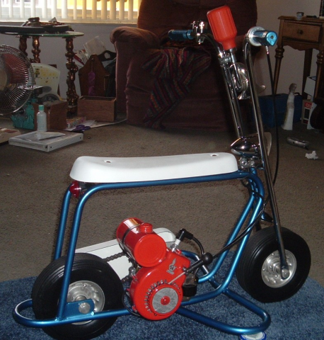

H Killackey 8 #17 Posted February 27, 2019 On 1/20/2019 at 8:02 PM, CNew said: H Killackey, What did you do to get your TAS P-5 so clean and shiny? Did you polish it or have it soda blasted? It looks incredible! Clint It was media blasted. Im not sure with what exactly - and It's a TAS P-7 Here's my resto-mod today. You can scroll up above to my April 2018 post and see the before picture. The chain guard mold will be made this summer 2019 - then copies. I will later in the year make the seat mold and copies 3 CNew, factory and Wallfish reacted to this Share this post Link to post Share on other sites

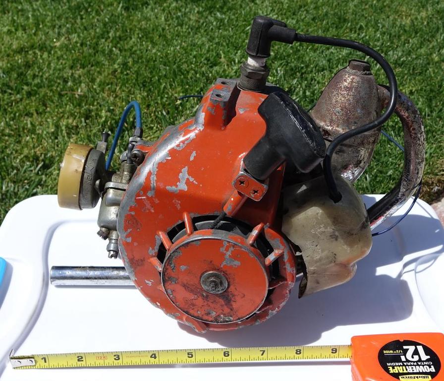

CNew 409 #18 Posted February 27, 2019 Wow, that’s a beauty- that turned out amazing, very nice work! Thank you for the photo. Good to know about the blasting, I may look into that as well. When I first went through the original post I saw the little orange NOS P-5 engine that Wallfish had and assumed it was this engine but I see now it’s a P-7. I have a P-7 as well that is mounted to an ice auger and it’s in pretty nice shape. I picked up a little orange P-5 not too long ago but haven’t been able to dig into it yet since I’ve been obsessed with the little Ohlsson Rice Engines. I hope to mess with P-5 before long and at least see if I can get it running. One challenge I’m having with the old P-5 is locating the proper spark plug. The one that’s in the engine now is a NGK C-40 and I can’t seem to find any information on this plug or it’s equivallent number today. The P-7 wasn’t too difficult but the plug on the P-5 is much smaller. Please let me know if you have any suggestions. Clint Share this post Link to post Share on other sites
H Killackey 8 #19 Posted February 27, 2019 P-7 engines came with small & medium diameter spark plugs. I have 2 P-7's and the heads & plugs are different. I went down to an old lawn mower / weed wacker repair shop and he had the plugs. Share this post Link to post Share on other sites
CNew 409 #20 Posted February 27, 2019 Great, thank you. Can you provide the spark plug part numbers that are stamped on them? I might be able to source these if I can get a couple numbers to start from. Thanks! Clint Share this post Link to post Share on other sites
factory 487 #21 Posted February 27, 2019 9 hours ago, CNew said: One challenge I’m having with the old P-5 is locating the proper spark plug. The one that’s in the engine now is a NGK C-40 and I can’t seem to find any information on this plug or it’s equivallent number today. The one in post #8 looks to be a NGK C40 too, I can't find much about it either apart from it's not in the NGK catalogue anymore. I imagine it's a 10mm thread similar to the Champion UY6 used on the early O&R's, or it could even be smaller i.e. 8mm, can you confirm the thread size? David Share this post Link to post Share on other sites
H Killackey 8 #22 Posted February 27, 2019 33 minutes ago, factory said: The one in post #8 looks to be a NGK C40 too, I can't find much about it either apart from it's not in the NGK catalogue anymore. I imagine it's a 10mm thread similar to the Champion UY6 used on the early O&R's, or it could even be smaller i.e. 8mm, can you confirm the thread size? David For my P-7 engine in the photos that has the small diameter Spark Plug (10mm major thread diameter) I use NGK CMR7A. For my other P-7 engine that has the large diameter Spark Plug (about 14mm) I purchased Champion CJ14. Since my usage will only be a few times a year for maybe 5 minutes it really won't matter ... It's not like the engine(s) will be raced or held at 90%+ RPM's for any long durations. Share this post Link to post Share on other sites
CNew 409 #23 Posted February 27, 2019 Excellent, thank you very much. I think I need the 10mm version for my P-5. I’ll look for a CMR7A. Much appreciated! Clint Share this post Link to post Share on other sites
