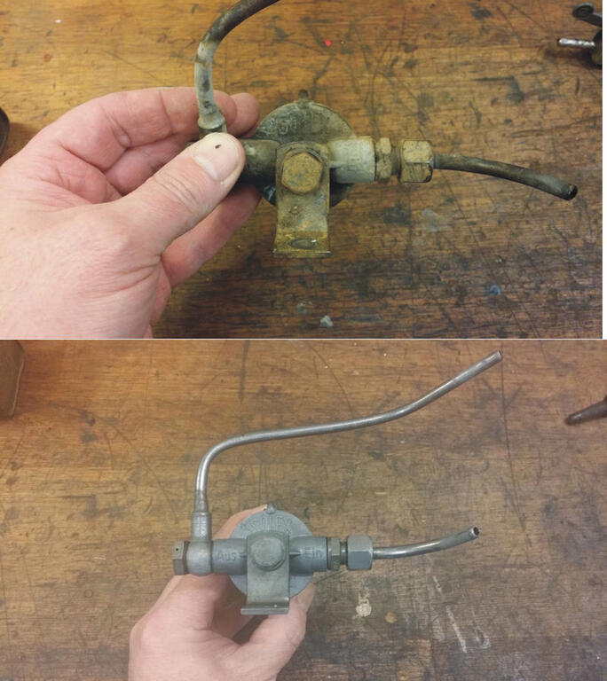

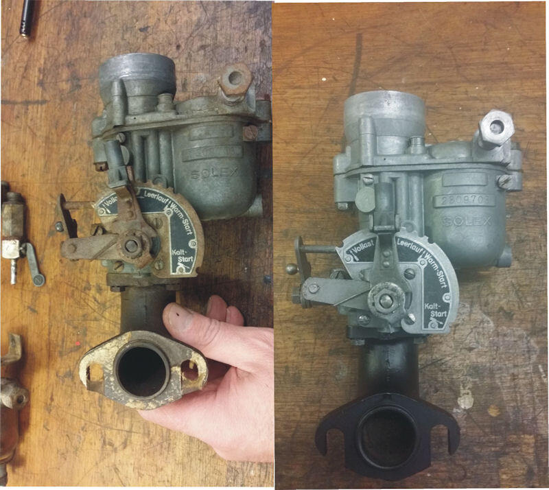

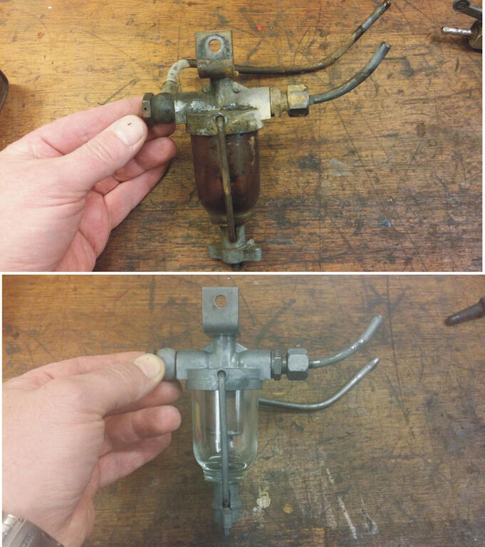

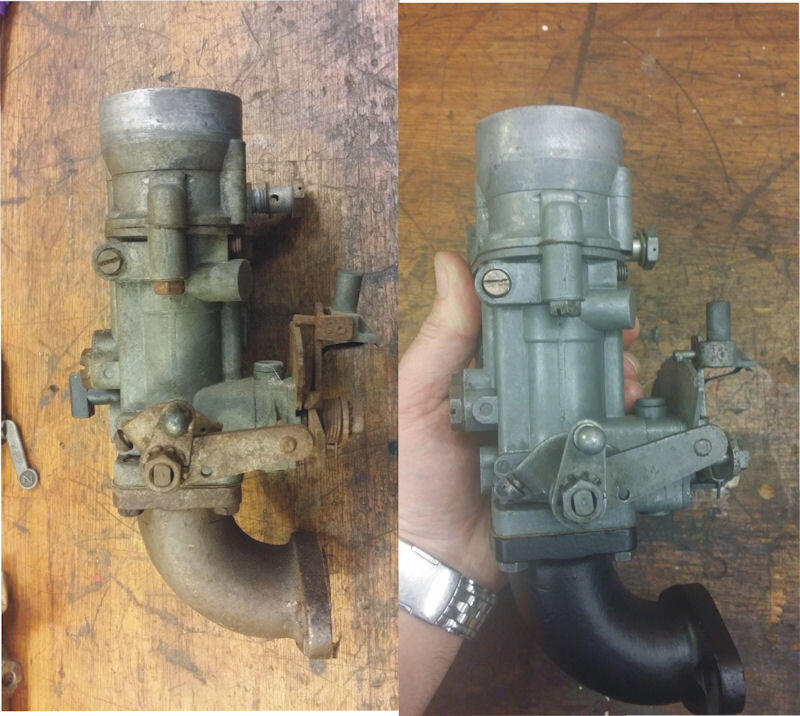

Twinsport 30 #41 Posted August 4, 2016 Hi there, I have been using a 6 liter chinese ultrasonic cleaner for years now. Mostly carburettor cleaning due to the limited size. I tried all sorts of cleaning agents, but I have had most succes with a mixture of 10% toilet cleaner to 90% wind screen washer fluid (for brass cleaning) or 20% toilet cleaner to 80% wind screen washer fluid (for aluminum, zinc and steel cleaning). Don't use to much toilet cleaner! Brass will discolour and cheap aluminium (read: japanese carburettors) disappears if you go above 35% toilet cleaner. Both items are cheap, effective and easy to get. I usually run it at 45°C for 1 hour with toothbrush scrubbing at the end. A couple of examples can be seen here: It's parts that wasn't touched since 1945 and I think the pictures speak for themselves. I did paint the intake elbow though :-) /Steen 1 Triumph66 reacted to this Share this post Link to post Share on other sites

Triumph66 1,256 #43 Posted August 4, 2016 That's a very useful tip and the photos speaks volumes as you say. Thanks Share this post Link to post Share on other sites
HeadExam 1,783 #44 Posted August 5, 2016 Wow, that does a great job. Truly a indispensable item Share this post Link to post Share on other sites
