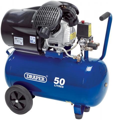

Charlie Smith 192 #7 Posted January 5, 2015 Me and My Dad both have air compressors, both 3HP twin motor 50L tanks, however one is.. shall i say 'unnamed' as such, it was cheap as chips i think something like £150 brand new from Aldi or The Range or somewhere like that, the other is a Draper and was more like £250-300ish we got them around the same time, they both came dismantled exactly the same way with the same instructions same warning labels... they are the same on noise, take roughly the same time to fill.. they are both 2 years old and still going strong admittedly the 'cheaper one' might give in first, but Its showing no signs of giving in! if you stand them next to each other, you would not be able to tell the difference, they are exactly the same the only difference is the colour... so I'm not sure quite what goes on in the factory's as Chris said my bets are on one company makes the tanks and fits the motors then they just get painted differently and different decals! .... but maybe it is true what people say... 'you only pay for the name' Share this post Link to post Share on other sites
Charlie Smith 192 #8 Posted January 5, 2015 I Stand Corrected! the 'unnamed one' does in fact have a name, 'Parkside' and it come from Lidl yes you heard that right... it was from Lidl. and was half the price of the Draper one... not very good pictures, one day if someone reminds me, ill get pictures of our actual two, until then here's stock pictures, the only difference is colours, the parkside one is green black and red, the draper one is blue and black Share this post Link to post Share on other sites

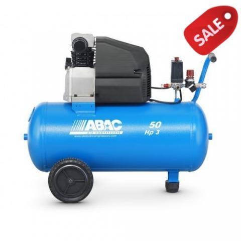

Rayp 48 #16 Posted January 19, 2015 Sorry for the delay in responding, but thank you all for your helpful advice. i will have to make my mind up as to what I intend to use it for and how often I am likely to use it. My current preference seems to be for an Abac 3HP Direct Driven with either a 25 or 50 litre tank. I had thought that I could use it for occassional spraying of small items in the future and these both appear to be up to the job, then I read that small airless sprayers could achieve the same results. Ranger, thanks also for the catalogue - I now know where to get Kohler rings etc. Share this post Link to post Share on other sites
Rayp 48 #17 Posted February 19, 2015 I've finally made up my mind and bought an Abac 3HP (photo attached). The suspicions of one member were confirmed when I read on the internet that 80% of non-industrial compressors are made by one factory in China and merely painted and badged as required. I spoke to one 'well-known' company asking them about what I had read and they said that there was a load of nonsense on the internet and that I shouldn't believe it. I did not tell them that I had read this on their Company Website!!! P.S. I've now got to work out what filters/connections and airlines I need. 1 Triumph66 reacted to this Share this post Link to post Share on other sites
