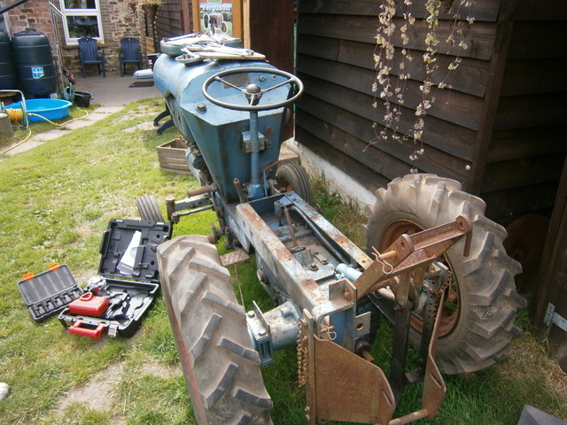

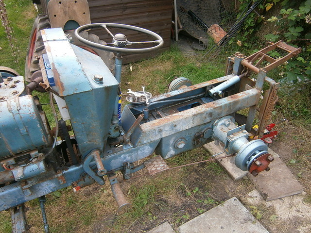

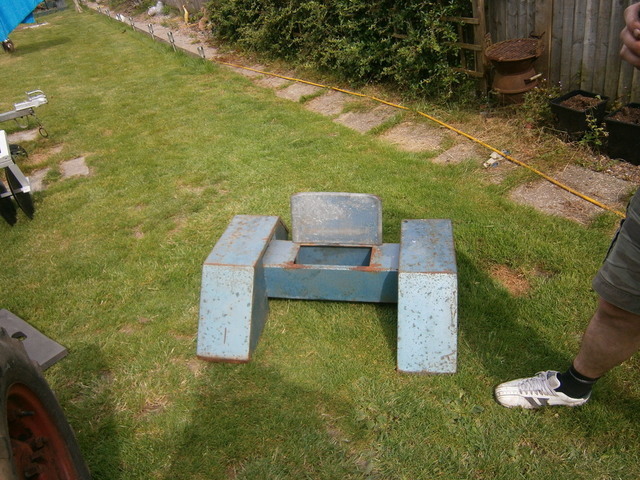

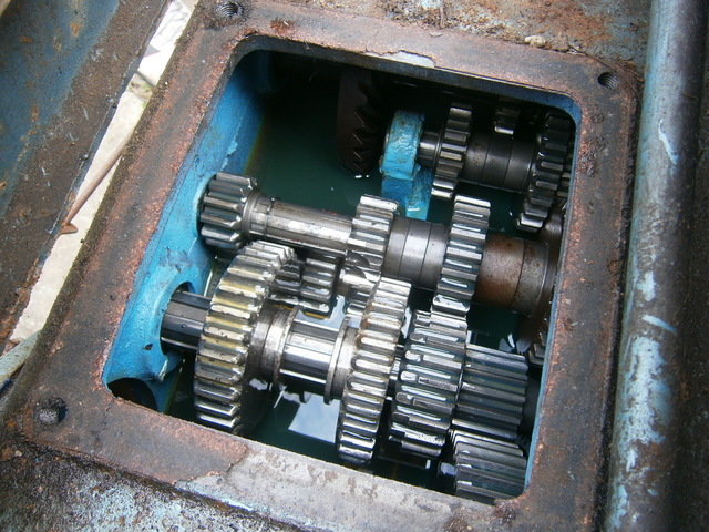

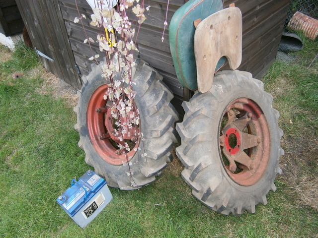

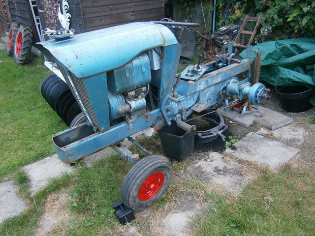

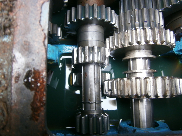

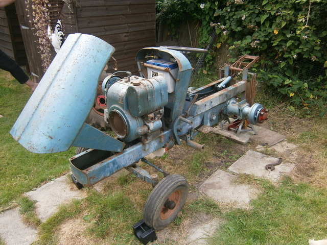

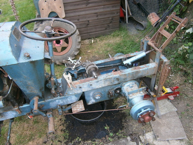

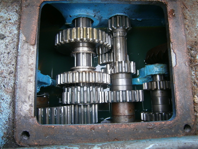

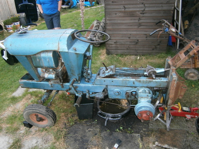

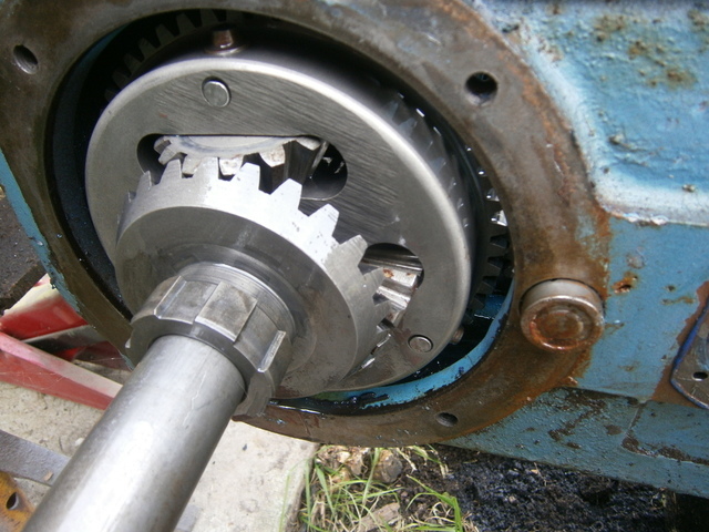

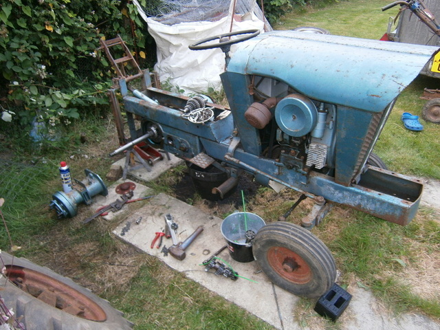

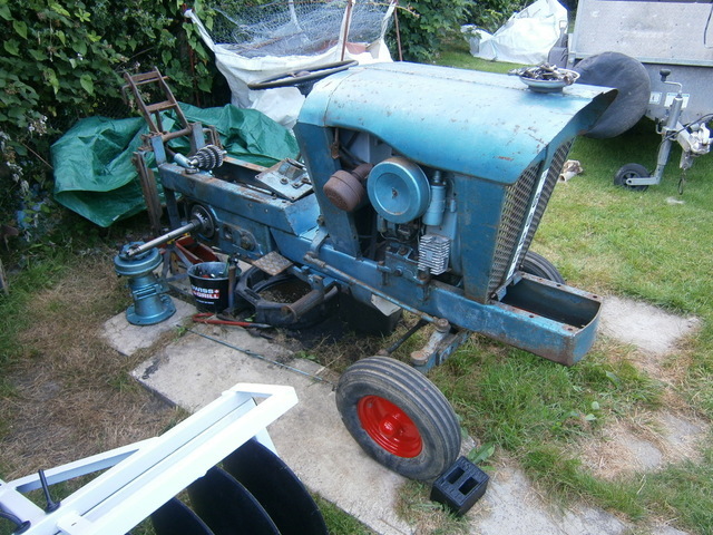

pmackellow 2,738 #127 Posted July 22, 2016 Steve D came round yesterday and we pulled the tractor apart to see what's up with the gearbox... There's a couple of gear wheels with broken teeth and a lot of play on the gear lever assembly Hopefully a chap we know down West with a MM has some spares he has offered to help so fingers crossed Here's the photos, starting with the seat base/fender... 1 Triumph66 reacted to this Share this post Link to post Share on other sites

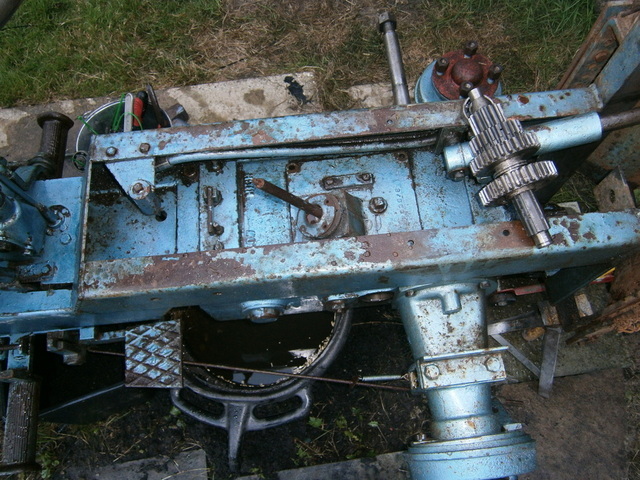

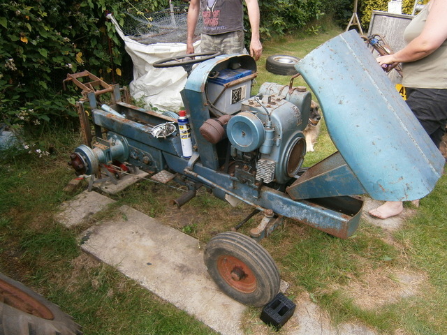

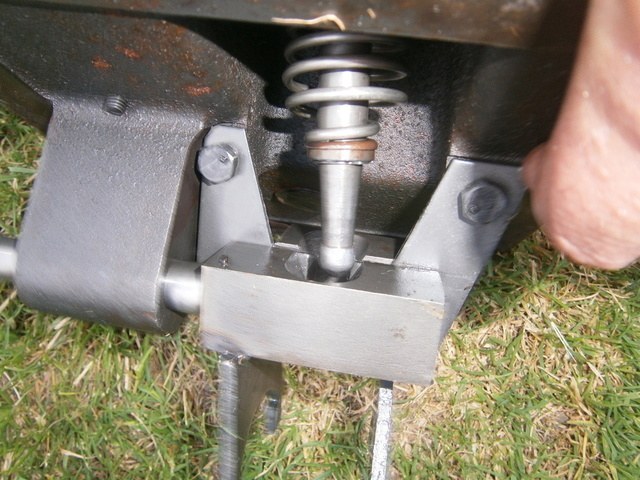

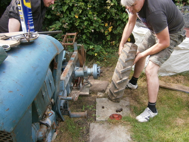

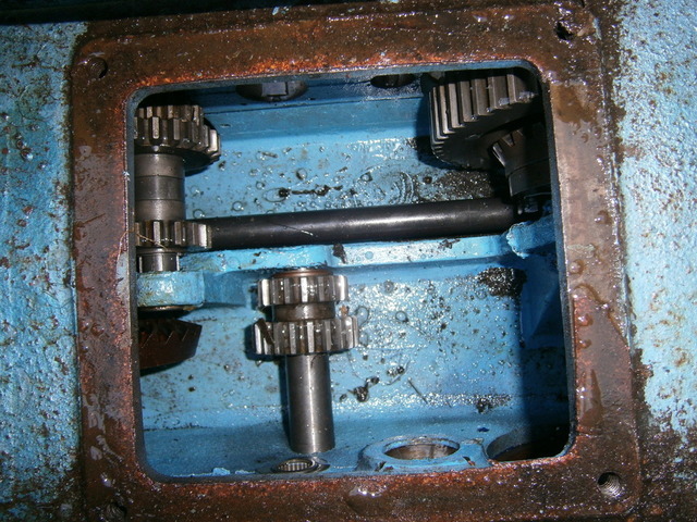

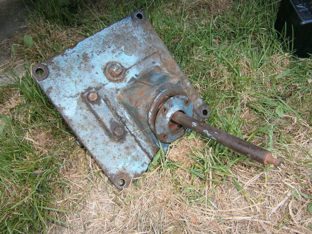

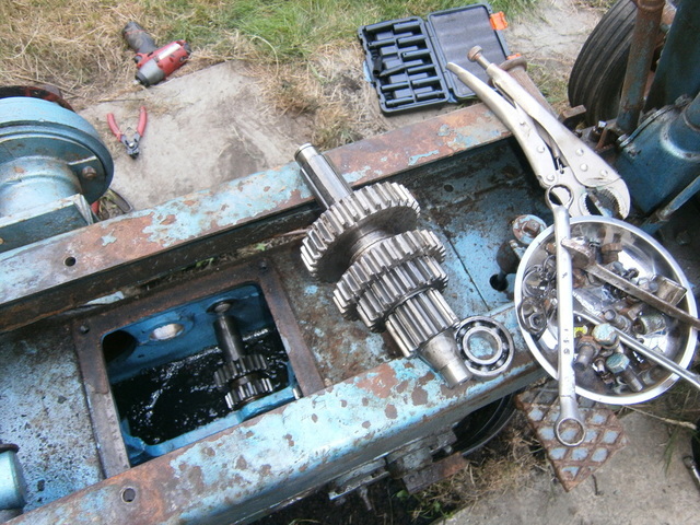

pmackellow 2,738 #128 Posted July 22, 2016 more photos... 4 the showman, Triumph66, meadowfield and 1 other reacted to this Share this post Link to post Share on other sites

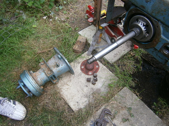

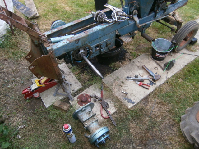

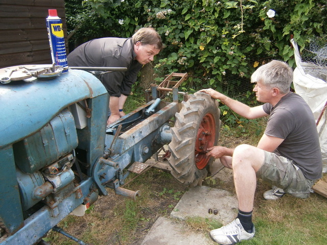

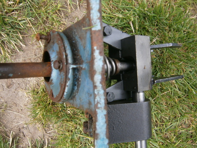

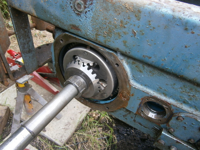

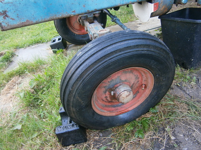

pmackellow 2,738 #130 Posted July 22, 2016 and some more... 1 Alan reacted to this Share this post Link to post Share on other sites

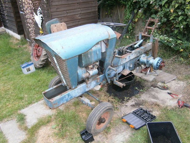

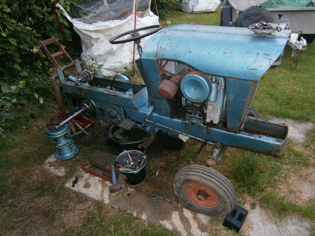

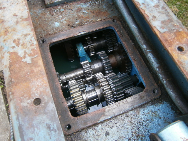

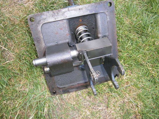

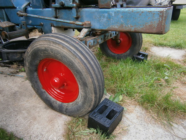

pmackellow 2,738 #131 Posted July 22, 2016 Last few photos for now... 1 nigel reacted to this Share this post Link to post Share on other sites

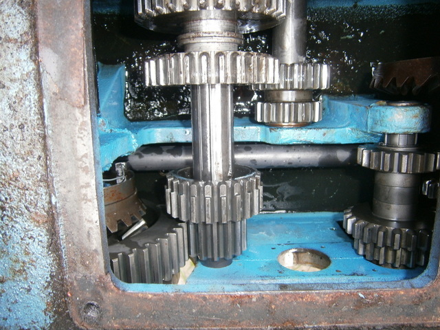

Triumph66 1,256 #132 Posted July 22, 2016 Always good to have a helping hand with these things. The original blue in the gear box is very vivid. I wonder if that would be how the tractor look like when brand new? Whereabouts is this fellow in the West Country Paul? 1 pmackellow reacted to this Share this post Link to post Share on other sites
pmackellow 2,738 #133 Posted July 22, 2016 I am pretty sure the tractor should be the metallic like blue that it is, its very close to the old Landmaster colour The chap with the bits is in Radstock 1 Triumph66 reacted to this Share this post Link to post Share on other sites
Stormin 4,458 #134 Posted July 22, 2016 Everything's very nice and clean in there. Share this post Link to post Share on other sites
pmackellow 2,738 #135 Posted July 22, 2016 Even cleaner now 2 Triumph66 and the showman reacted to this Share this post Link to post Share on other sites
S1g 579 #136 Posted July 23, 2016 Looks like a giant jigsaw puzzle, Paul. Hope you manage to find all the new parts off your source, otherwise hopefully the damaged cogs will be the same as something else more common. Are the bearings ok? I've just recently rebuilt a gem gearbox and because all the bearings were imperial the bill for them came to over £300 on their own. 1 pmackellow reacted to this Share this post Link to post Share on other sites
pmackellow 2,738 #137 Posted July 23, 2016 Fingers crossed the parts have been found, will be off to Zummerzet next Sunday with trailer to pick them up (another gearbox/back end) 2 S1g and nigel reacted to this Share this post Link to post Share on other sites

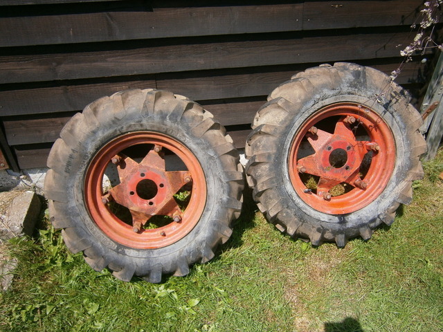

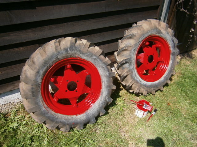

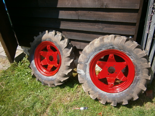

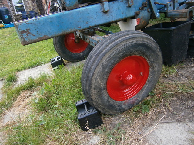

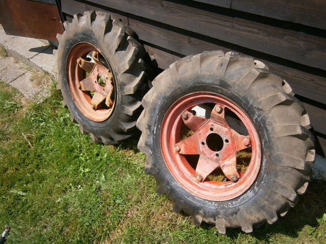

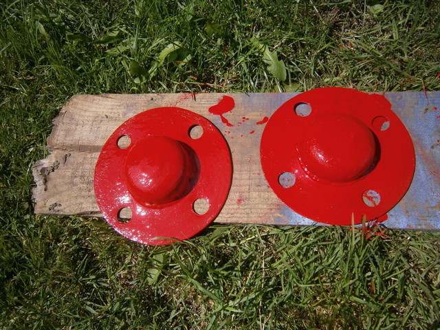

pmackellow 2,738 #138 Posted July 23, 2016 Ideal painting weather today so gave the back wheels and hubcaps a rub down and a coat of IH red... 4 Ian, nigel, Stormin and 1 other reacted to this Share this post Link to post Share on other sites
the showman 4,074 #139 Posted July 23, 2016 They look good Paul, did you have any luck with the gearbox parts ? 1 pmackellow reacted to this Share this post Link to post Share on other sites
pmackellow 2,738 #140 Posted July 23, 2016 Yes mate, we are off to Somerset next Sunday to pick up another gearbox/rear end 2 Ian and Triumph66 reacted to this Share this post Link to post Share on other sites
pmackellow 2,738 #141 Posted July 24, 2016 Seat base/fender down to the Wheelhorse Shed this afternoon (they do cater for other models ). Chris and Steven will be sorting out the untacked tack welds on it this week, thanks chaps !! 2 Alan and Triumph66 reacted to this Share this post Link to post Share on other sites

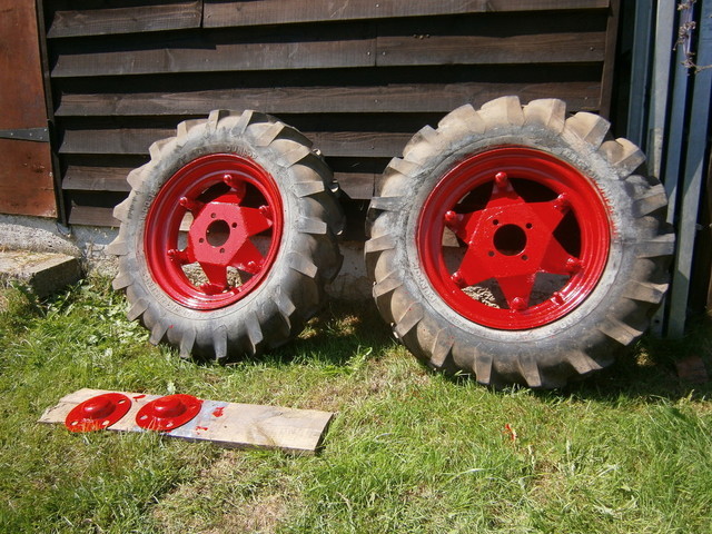

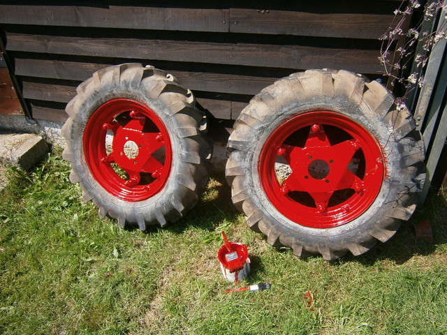

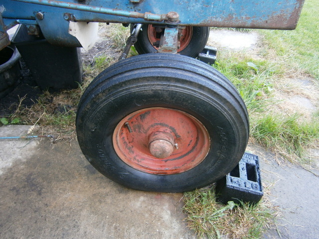

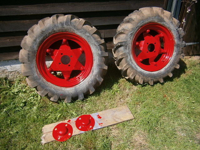

pmackellow 2,738 #145 Posted July 25, 2016 Front wheels got a clean up this evening, I would have removed them to do it but was not happy leaving the whole tractor up on axle stands !! Coat of IH red tomorrow... New front tyres to go on somewhen, I will get the rear end back on the ground first... 1 nigel reacted to this Share this post Link to post Share on other sites
pmackellow 2,738 #146 Posted July 26, 2016 Painted !! Share this post Link to post Share on other sites

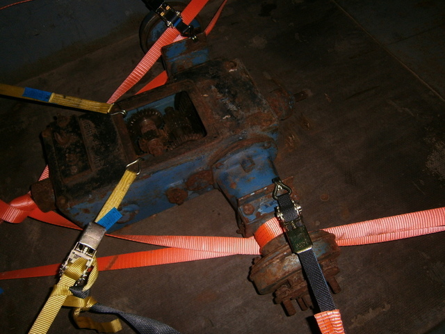

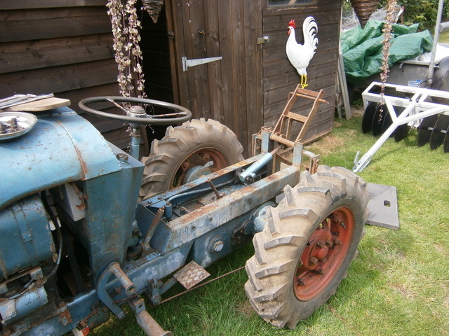

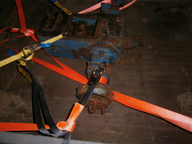

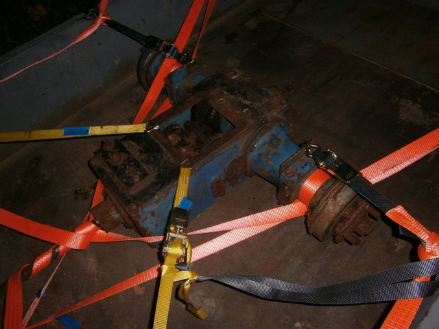

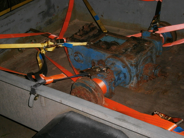

pmackellow 2,738 #147 Posted July 31, 2016 After a mega road trip (Sunday, sun shining, roads full of idiots) we are finally home with the back end of another MM Here's the "in the trailer" photos, better ones on here tomorrow... 3 Alan, the showman and Stormin reacted to this Share this post Link to post Share on other sites
the showman 4,074 #148 Posted August 1, 2016 Well done Paul, lucky to find that I would have thought. 1 pmackellow reacted to this Share this post Link to post Share on other sites
Stormin 4,458 #149 Posted August 1, 2016 Lucky man indeed. Are you just going to use the gears you need? 1 pmackellow reacted to this Share this post Link to post Share on other sites
pmackellow 2,738 #150 Posted August 1, 2016 We will replace the damaged gears and then box the rest up for spares. Share this post Link to post Share on other sites
