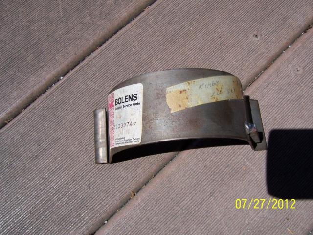

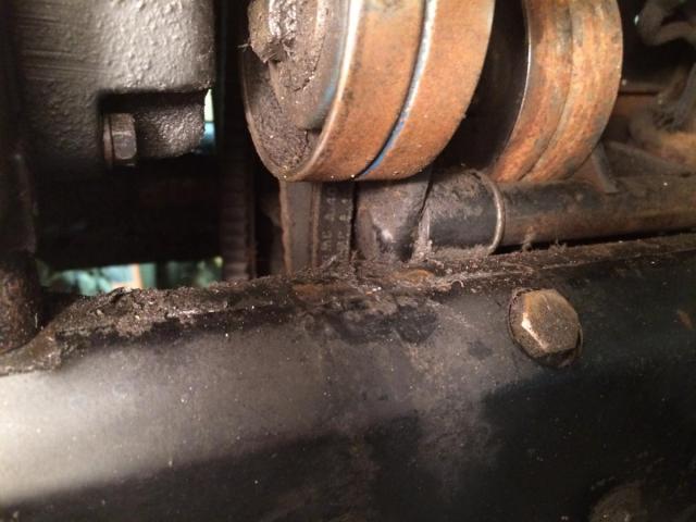

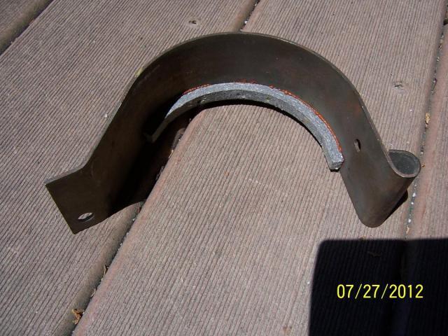

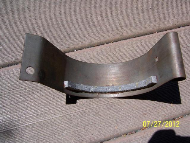

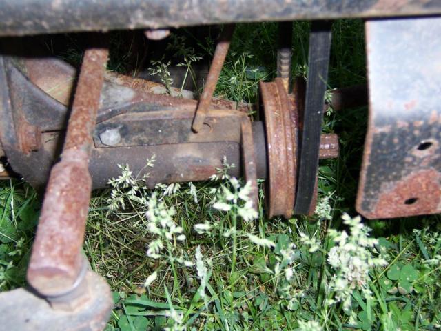

OldBuzzard 186 #2 Posted February 27, 2015 Iain, Is the belt shield on the PTO 'different' than the standard tube frames? The 1978 G14 and G11 used a different shield that incorporated a PTO brake as opposed the shield used on previous years tube frames. Only one of my G11s has the proper PTO sheave, and it was missing the shield. Here are some pics of the PTO and a NOS shield that I found. The rod you see hanging down in the PTO pic is used to activate the brake when the PTO is disengaged. I'm also including a page from the tube frame service manual that discusses the adjustment of the PTO brake. BOLENS_TUBEFRAME_Service _Repair 85.pdf 2 Triumph66 and slf-uk reacted to this Share this post Link to post Share on other sites
slf-uk 914 #3 Posted February 27, 2015 Thanks for the information OB, very interesting. A completely new PTO has been made for the G14 with the shaft being the only part that has been reused. The seller has the original PTO case but no belt guard. Share this post Link to post Share on other sites

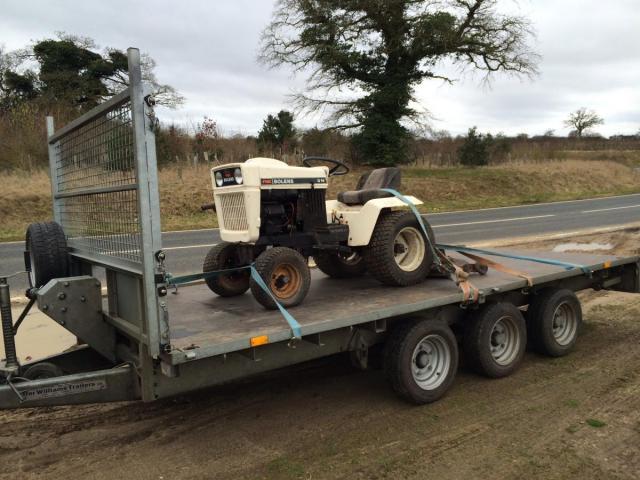

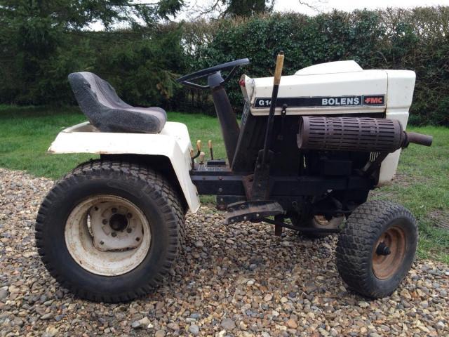

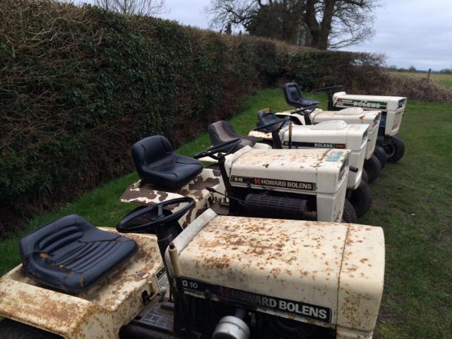

slf-uk 914 #8 Posted February 28, 2015 I picked the G14 up today and managed to miss the worst of the weather. The seller was a lovely guy and is interested in old equipment. I pointed him to this forum. A couple of pictures of the G14 I then had my 7 year old lad helping me for the rest of the day so I was unable to get on with anything useful. He wanted to have some tractor time so I thought it would be good to pull a couple of the working tractors out for a line up as the G14 completes a advert type picture. Left to right is a G10, G12, the new G14, H16 and HT23. No G11 as OldBuzzard has all them and Chris has all the HT20's. Iain 7 Anglo Traction, nigel, Stormin and 4 others reacted to this Share this post Link to post Share on other sites
Triumph66 1,256 #9 Posted February 28, 2015 Iain, The G14 look better than the advert! What a great buy. Is there a deck with this? That line up look damn cool and your son is a lucky chap to be able to drive them; another Bolens collector in the making! The HT23 is distinctly bigger than the tube frames models. Cheers 1 slf-uk reacted to this Share this post Link to post Share on other sites
OldBuzzard 186 #10 Posted February 28, 2015 Yeah, from just looking a pics it's hard to get a feel for the size of the Large Frames. Once you put one next to a Tube Frame it becomes obvious :D Nice 'herd' you have going there Iain 2 slf-uk and Triumph66 reacted to this Share this post Link to post Share on other sites

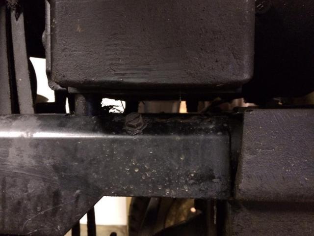

OldBuzzard 186 #23 Posted March 3, 2015 In the 1996 Service Seminar, they reference the OH140 for the 1977 and 1978. The earlier models referenced the HH140. So, that narrows it down to two years. There was a MAJOR difference between the 1977 and 1978 which was the PTO. If you can determine which type PTO it had you can pretty much pin point the year. Especially if it is the one that has the PTO brake which was exclusive to the 1978. If you can date the engine, the model year would be one year NEWER than the engine. So if it's a 1976 engine it would be a 1977 tractor. On the attached G14 Parts manual, on page 4 you can see in the loser right the difference in the two PTOs. Now if your PTO is not there, all is still not lost. If you look on page 8, part 10 is different for the 1978. It would have a tab and hole that part 55 would fit into and be retained by a cotter pin. 1453-G14 Parts.pdf 2 Triumph66 and slf-uk reacted to this Share this post Link to post Share on other sites
slf-uk 914 #24 Posted March 4, 2015 Thanks for the information. I don't have enough of the original PTO to be able to identify it in that way so I check for the tab. I am looking forward to getting out to the workshop tonight to check. Iain 1 Triumph66 reacted to this Share this post Link to post Share on other sites

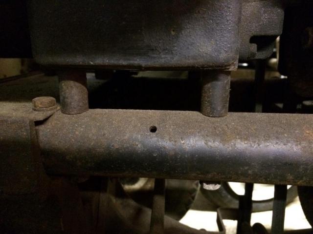

slf-uk 914 #25 Posted March 5, 2015 I was allowed an hour in the workshop by the boss last night and despite being very tired I managed to get a reasonable amount done. Posting it here makes it feel like progress. I checked out the shaft as suggested by OldBuzzard and it does not have the tab at the end, which suggests it is a 1977. Picture of the end of the shaft As with most of these tractors the wiring has tangled with the pulleys or belts at some point in the past so sorting that out was the first job of the evening. I then moved to the starter which was seized. The starters on these engines are held on with two bolts through a tab underneath and some have a third tab at the top. I am sure wiser people than me will know why some have the third tab and some don't. The starter on this engine had the third tab which meant that the fuel tank and the bracket holding the tank and hood strap had to come off first. I took the starter apart cleaned it up and it now works great. Whilst I had the tank off I cleaned it out made sure the tap worked as expected. It was then just a case of putting it all back together and getting indoors before I got into trouble. Iain 2 nigel and Triumph66 reacted to this Share this post Link to post Share on other sites
