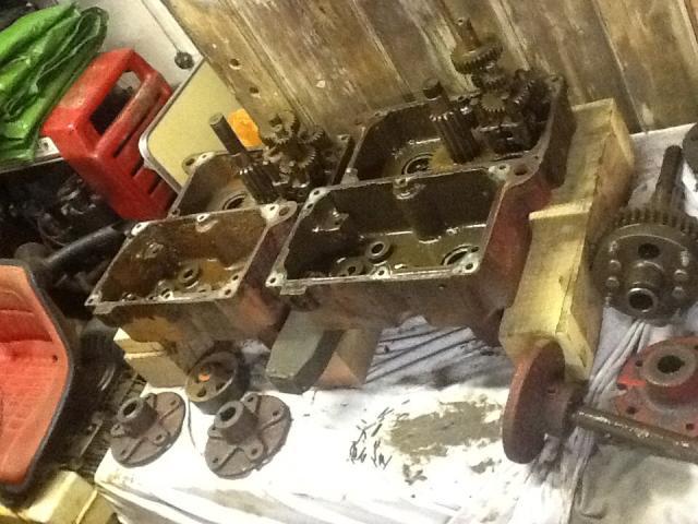

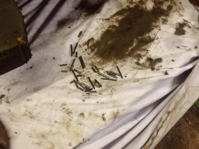

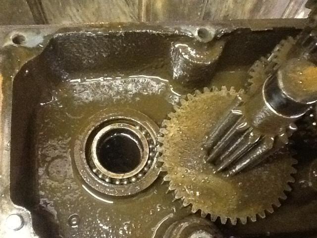

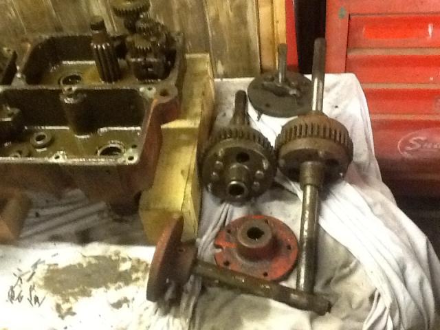

the showman 4,074 #37 Posted March 28, 2015 After going to buy a new drill, i spent the afternoon in the shed. I finished drilling out the hitch pin removed allthe hubs from both boxes without braking them with my home made puller and opened them up. The box on the left is the one that won't go in 3rd gear, it looks like the problem is rusty balls in the selector shafts and the one on the right is the box out of the tractor which is just about a bin job, there was aload of needles in the bottom and one of the roller bearings is missing some balls. Next job is to throw it all in the parts washer and see what can be saved out of three boxes Share this post Link to post Share on other sites

Stormin 4,458 #41 Posted March 28, 2015 , there was aload of needles in the bottom and one of the roller bearings is missing some balls. Now where have I seen that before? 1 the showman reacted to this Share this post Link to post Share on other sites

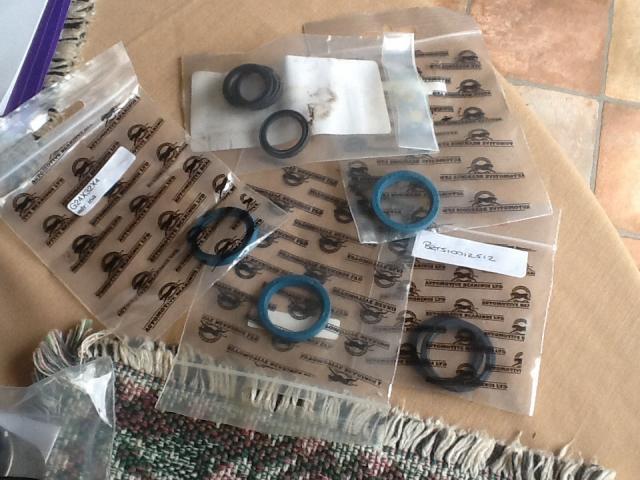

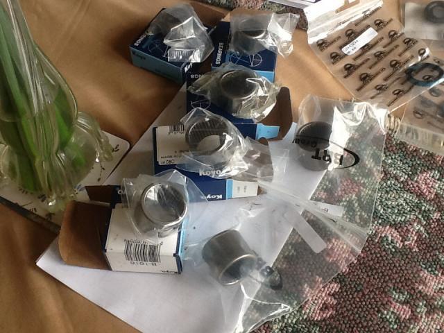

the showman 4,074 #45 Posted March 30, 2015 Another day on the trannys, out of 4 i have found 2 casings with good ball bearings in and have cleaned them both up in the parts washer, ordered all new needle bearings and oil seals from my local bearing shop. They have them all in stock at another branch and i will have them Wednesday, ive made a new gasket so at a standstill until they arrive 1 Ian reacted to this Share this post Link to post Share on other sites

the showman 4,074 #47 Posted April 2, 2015 Finally got my bearings and seals to day so hopefully get them pressed in the casings tomorrow 2 nigel and Triumph66 reacted to this Share this post Link to post Share on other sites
