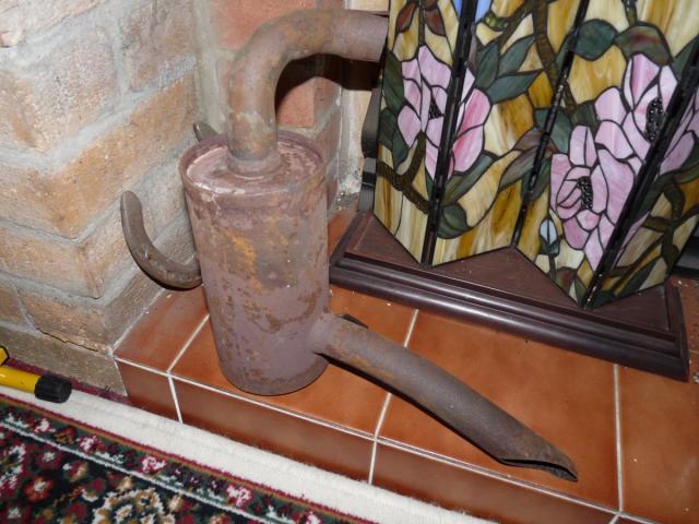

Martin H 6 #27 Posted April 17, 2015 (edited) Thanks Stormin, finally found it, nice job, you make it look so simple.. And that is very encouraging at this stage Meadowfield, thanks, I was starting to wonder what I'd got myself into... Anyway, here's some photos, (promise not to laugh at the bodywork)...and you may notice a rather interesting exhaust modification which is well outside the realms of health and safety. Still, as long as you don't touch it after it's been running it's ok... Edited April 17, 2015 by Martin H Share this post Link to post Share on other sites

ranger 373 #35 Posted April 18, 2015 Hi Martin, whereabouts in Cambs are you? I think I've got a C121 exhaust in the shed You're welcome to if you can make use of it. regards Doug. Share this post Link to post Share on other sites
Martin H 6 #36 Posted April 19, 2015 Hello Doug, That sounds interesting, would that mean I could replace that long length of custom exhaust pipe? I'm over near St Ives. I could also collect if you're not too far away... Cheers, Martin. Share this post Link to post Share on other sites

ranger 373 #41 Posted April 22, 2015 Hi Martin, found the silencer,it;s for a C121, but i think the C125 is the same. I live in Sutton, just up the road from you. I'll be coming through St Ives tomorrow evening,off to the garden centre. if you p.m. me your address I'll drop it off for you. regards Doug . Share this post Link to post Share on other sites
