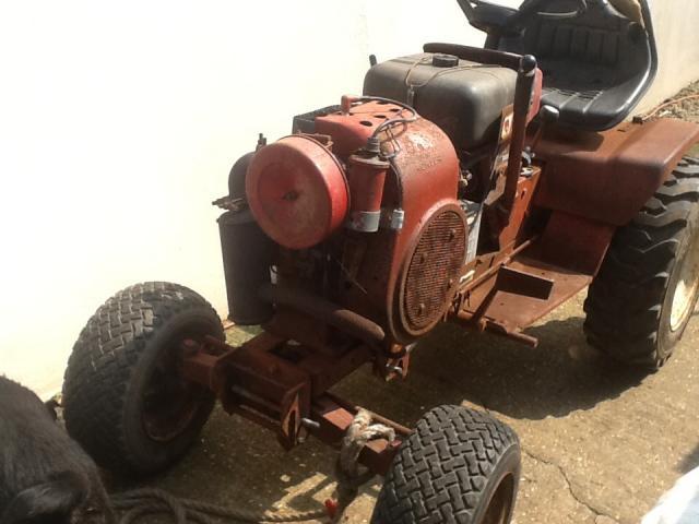

the showman 4,074 #1 Posted April 9, 2015 A while ago i got a Wheehorse in that had been standing for a long time, after cleaning the points and fuel system i got it to fire up. The bit that frightened me was when i opened up the throttle the rpm went through the roof, there was a big cloud of crap from the cowling and a load of sparks from the exhaust, after it settled back down it ran as sweet as a nut except the governor wasn't working. I didn't know weather to look for another engine or cut my grass at 50 mph Share this post Link to post Share on other sites

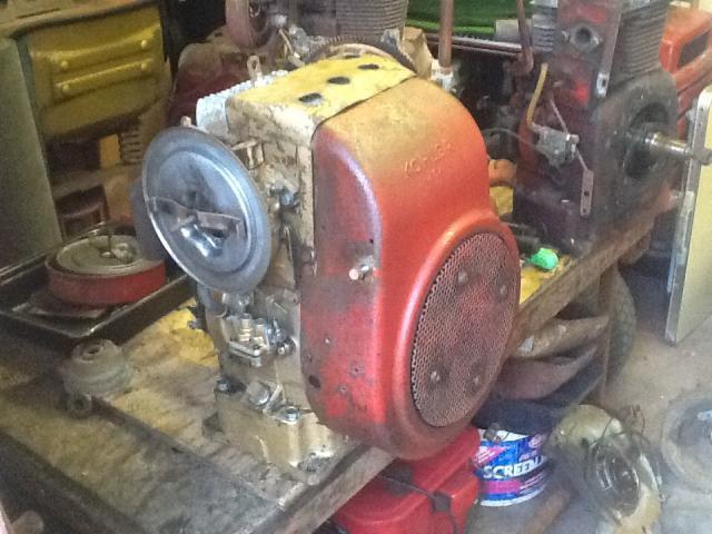

the showman 4,074 #2 Posted April 9, 2015 Here's a couple of photos, its a C series with a 12 hp Share this post Link to post Share on other sites

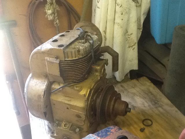

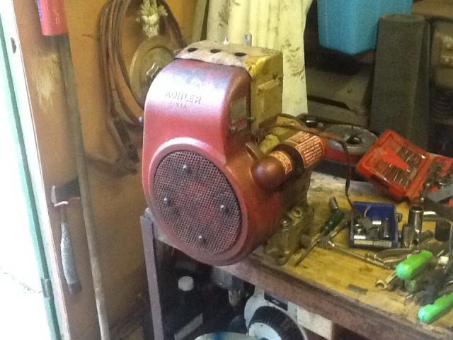

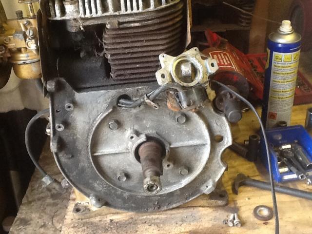

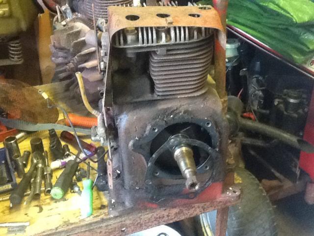

the showman 4,074 #3 Posted April 9, 2015 When i was up at Ian's helping him move, he had a spare engine sat in his shed so a deal was struck and I brought it home. Its been sat on my garage floor ever since so today I thought it was time i did something with it. Its a 12 hp pull start, so just swop a few bits over, ha ha . You'll notice I swapped the pulley and pto clutch first to see if the crank was the same 1 diggerjames reacted to this Share this post Link to post Share on other sites

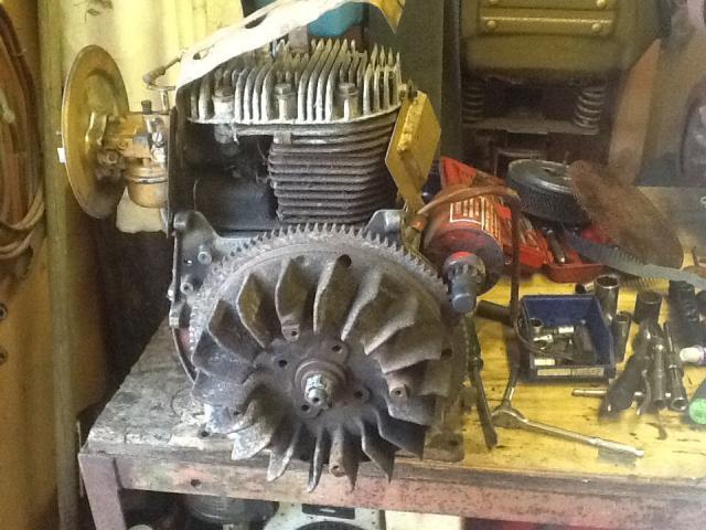

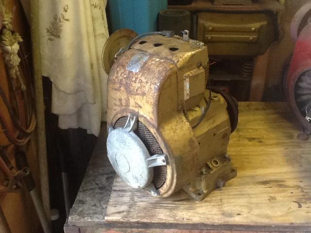

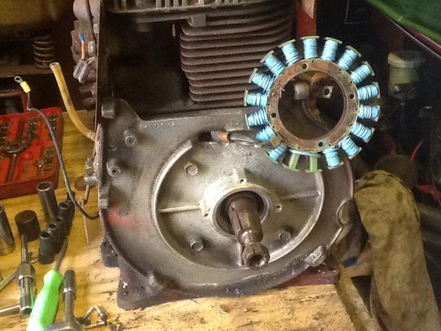

the showman 4,074 #4 Posted April 9, 2015 Next was the starter and flywheel, after a fight with the flywheels i found the backplates were different, so off they came and luckily i had some gaskits, this is where it all went pear shaped Share this post Link to post Share on other sites

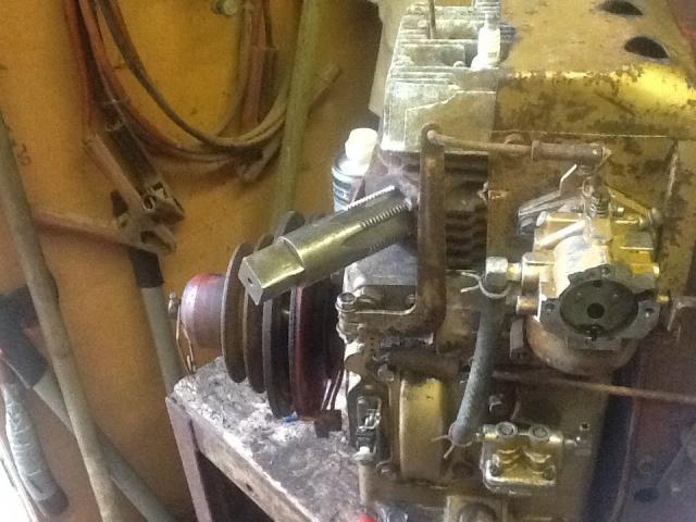

the showman 4,074 #5 Posted April 9, 2015 Her in doors came in the workshop and wanted a ton of 10mm shingle for the garden so off we went, so progress on the engine was slow as i only managed to do bits in between the barrow fulls of shingle and cups of tea So at the end of the day this is where I'm at, see what interruptions i get tomorrow Share this post Link to post Share on other sites

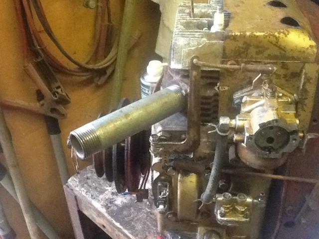

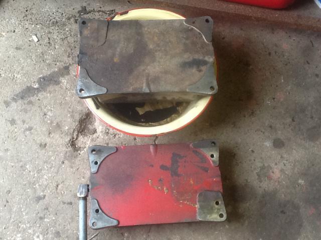

the showman 4,074 #10 Posted April 10, 2015 Done a bit more today, i dont know why but i looked underneath the sump this morning and guess what no threaded holes so something else to swap over, glad i had a gaskit, next was the exhaust, it had a smaller pipe bolted to the block and of course they wouldn't undo then out with my big tap and a new piece of pipe. Might get it bolted in the tractor tomorrow 3 Triumph66, slf-uk and nigel reacted to this Share this post Link to post Share on other sites

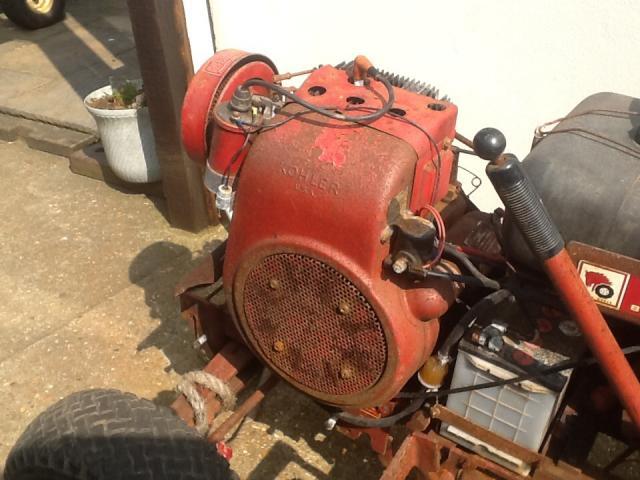

the showman 4,074 #12 Posted April 11, 2015 All fitted back in the tractor, flicked the key and away she went, nice and smooth, quiet and no smoke , result !!!. Very pleased with that, job done 3 Ian, nigel and Stormin reacted to this Share this post Link to post Share on other sites
