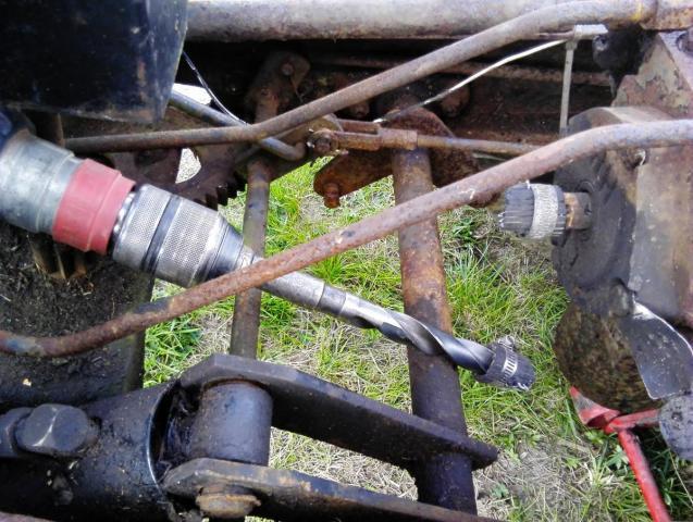

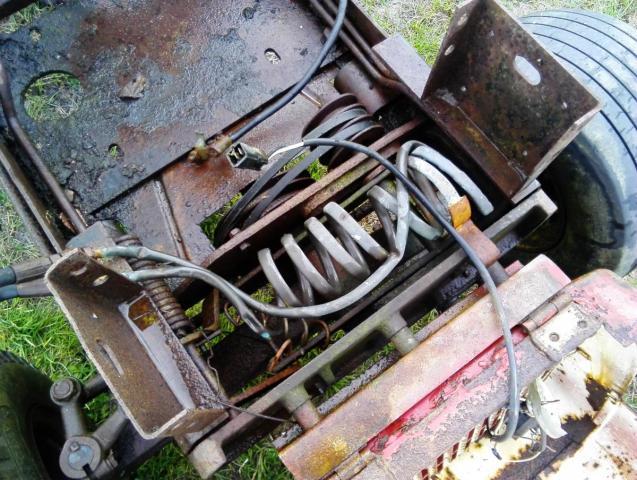

BIGBucks35X 11 #1 Posted April 19, 2015 Hi all, my first proper post on here so I hope it's in the right place?! I have recently acquired this dog of a tractor for a pint of barley juice and a packet of fags! (The previous owner decided a gas torch was an 'all in one' combined tool set when it came to fixing it?!!) Is there any way I can test the gearbox without mounting an engine in first? What sort of speed does the input shaft need to turn? Also the coil thing at the front looks a bit home bodged, should this be a radiator or something, the pipes come from the top / front of the hydraulic pump?? Any help or info would be great! Thanks Luke Share this post Link to post Share on other sites
OldBuzzard 186 #2 Posted April 19, 2015 To test the hydro, I'm thinking anything from 1,000-3,600 RPM would work. As far as the coiled tube. That's the remains of the tubing that goes from the hydrostatic transmission to the hydraulic control valve and then to the lift cylinder and auxiliary hydraulic outlets. The engine would have been a Kohler K532 air cooled flat twin cylinder. Share this post Link to post Share on other sites
BIGBucks35X 11 #3 Posted April 19, 2015 Great! Thanks for the help, I may try and make an adaptor to hook up a corded drill? Jack up the rear end and see if anything trys to move. Not sure what the chances of finding an engine are so maybe have to look at a conversion? Share this post Link to post Share on other sites

BIGBucks35X 11 #7 Posted April 19, 2015 Wow! That's a good looking machine! Well the gearbox and hydraulics are working after I bodged a shaft/drill connectornator, but it wasn't man enough for the prolonged playing. So the next a step is to find an engine and I'll be away!! Share this post Link to post Share on other sites

Chris 642 #9 Posted April 19, 2015 (edited) Like the way you spun it up Luke Take it the engine is long gone ? Theres a drive shaft to the hydrostat unit which should have a fan on it. Any single cylinder engine will do ie Honda 8hp plus is fine to power the unit. The old engine was 20hp The cooler on the front is nothing to do with the tractor, well not on mine?? where do those pipes go?? Just remember, if you get fed up with it I can give it a home Edited April 19, 2015 by Chris Share this post Link to post Share on other sites
Stormin 4,458 #10 Posted April 19, 2015 The cooler on the front is nothing to do with the tractor, where do those pipes go?? Maybe some ones idea of an oil cooler if the fans gone? Share this post Link to post Share on other sites
BIGBucks35X 11 #11 Posted April 19, 2015 Well the engine is long gone now but I did see the tractor when it had the engine in, the guy I bought it from broke the engine up because he couldn't fix the spark plug threads in the cylinder heads, I said you could drill out and tap for the next size up plug but he wasn't having any of it from someone else, (you know the type!). I do have the little plastic fan and a half a drive shaft (it was removed with a gas axe, as I don't think he knows what a spanner is) I think that bits in my old workshop? Having just moved house theres a bit of everything everywhere!! I'm not sure what the coil on the front is for but it comes from the top of the pump housing to the front of the tractor then back off to the bottom of the spool valve block. Possibly is someone's extra cooling for fluid coming from an implememt, although I'm not sure which direction it flows yet? Share this post Link to post Share on other sites

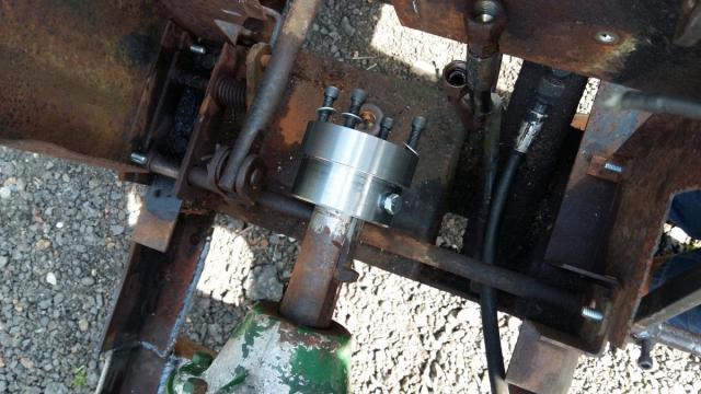

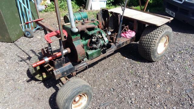

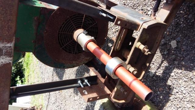

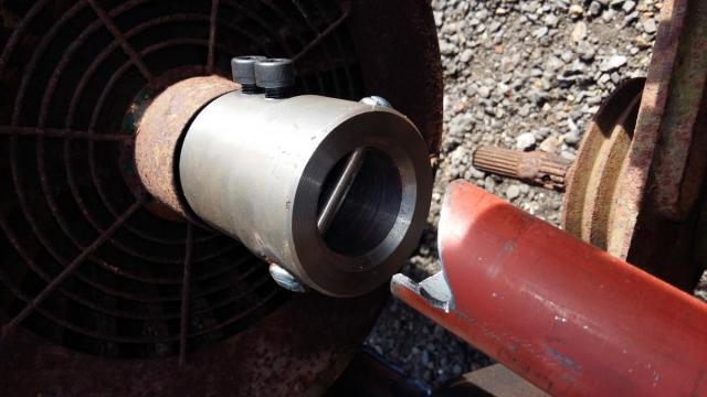

BIGBucks35X 11 #16 Posted May 15, 2015 Time for an update!! (I hope this isn't considered butchery by the puerists!!) Well, I started to look into fitting a new engine a few weeks back and this is how it is looking so far! I have extended the chassis and built a frame on the back to fit the bench seat for two people to potter round the rally field and also replaced the foot speed control with a hand operated quadrant assembly. I have machiened a boss to take a triumph herald UJ flange (and yolk) which I am using to repair the existing propshaft. I have made a dog drive for the starting handle (also homemade) so it disengages the handle when the engine starts (as opposed to the original which was on a key) and extended the handle shaft out the front of the tractor. I'm now going to start looking at the steering which will have to go down the side as there is no room with the new engine! I will post some more pictures up as progress continues!! Also I have some bolens leftovers including the old rear wheel arch/bodywork, bonnet (both in bad condition), some steering components and front PTO parts if these are worth anything to anybody as I don't partucually want to scrap them! Just let me know. Luke 5 Stormin, nigel, HeadExam and 2 others reacted to this Share this post Link to post Share on other sites

HeadExam 1,783 #18 Posted May 15, 2015 Time for an update!! (I hope this isn't considered butchery by the puerists!!) Well, I started to look into fitting a new engine a few weeks back and this is how it is looking so far! 20150515_145937.jpg I have extended the chassis and built a frame on the back to fit the bench seat for two people to potter round the rally field and also replaced the foot speed control with a hand operated quadrant assembly. I have machiened a boss to take a triumph herald UJ flange (and yolk) which I am using to repair the existing propshaft. I have made a dog drive for the starting handle (also homemade) so it disengages the handle when the engine starts (as opposed to the original which was on a key) and extended the handle shaft out the front of the tractor. 20150515_151024.jpg 20150515_151014.jpg 20150515_151056-1.jpg I'm now going to start looking at the steering which will have to go down the side as there is no room with the new engine! I will post some more pictures up as progress continues!! Also I have some bolens leftovers including the old rear wheel arch/bodywork, bonnet (both in bad condition), some steering components and front PTO parts if these are worth anything to anybody as I don't partucually want to scrap them! Just let me know. Luke Luke, I don't think many people think a HT-20 is a rare or unusual tractor that cant be altered into a serviceable machine by imaginative ways, you go there!!! Share this post Link to post Share on other sites

WeaPea 15 #20 Posted May 16, 2015 Did you really put an earthmotor to a moving machine ? Nice one! now you have missing a big alternator, or generator for housepower... im thinking to place an cars old electric startermotor to my husky, to go back and forward easier than now with the huskys own gearbox. first i place muchpowered alternator from a car to the tractor with an belt.. Share this post Link to post Share on other sites
Ian 2,417 #21 Posted May 16, 2015 Nice work Luke, we don't mind modified machines around these parts, I'm very much guilty of it myself 1 Joe the small engine man reacted to this Share this post Link to post Share on other sites
