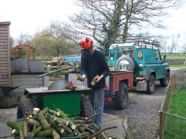

Stormin 4,458 #1 Posted January 24, 2014 Take one Liner saw bench minus engine. One Lister single cylinder diesel engine. A pair of Land Rover hubs and wheels and some scrap box section and this is what you get. And earning it's keep. 2 amcrules00 and Will-Haggle reacted to this Share this post Link to post Share on other sites
GAV694 23 #2 Posted January 24, 2014 Of course you have only removed the guard for photographic purposes Very nice Stormin, it will outlast anything bought new these days also good it earns its keep Share this post Link to post Share on other sites
meadowfield 1,901 #3 Posted January 24, 2014 I like it, nice touch with the landy wheels. I don't like big blades spinning though my old boss lost fingers on a jointer... Share this post Link to post Share on other sites
Ian 2,417 #4 Posted January 25, 2014 I like how you have built it using whatever you had knocking about the place... You can't beat recycling Share this post Link to post Share on other sites

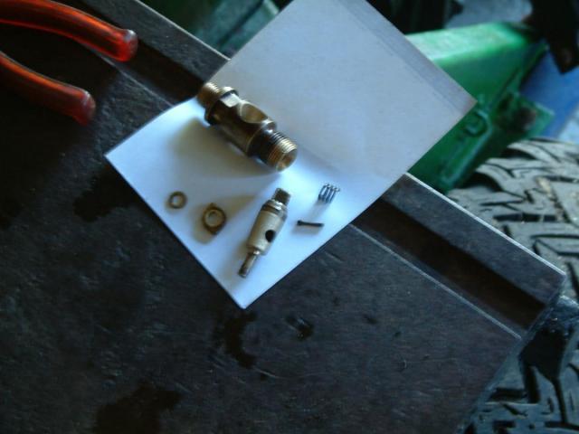

Stormin 4,458 #8 Posted August 31, 2015 After 4 years sterling service and a nice store of logs in, for this winter and beyond, I decided it was time to give the saw bench a treat. So into the now roomy workshop after a good pressure wash. Oil drained off and I just need to find out the engine oil to use. Can't remember what went in. Blade has seen slightly better days by now, so a nice re-sharpened blade fitted. Though not tungsten tipped, it will do until I get the old one to the saw doctors. Bracket for the screw jack got bent a while ago, so off with that to replace with a mk2 version. When made sometime later this week. The fuel tap has always leaked a bit, so decided to fix that. It's one of those old tapered brass type you lap in. Noticed the end of the taper protruded out of the body slightly. So into the lathe and a few thou' skimmed off. Lapped in in with some fine paste and reassembled. That took some time, as when fitting the split pin, I dropped washer, spring and cam. Spring and washer easily found. Took about half an hour to find the cam. It bounced under a wheel and was hiding in the tyre tread. Re-assembled and re-fitted to the tank. Still leaks but nothing like before. Oh well! I get red diesel for nowt. When putting my tools away, I found the pin missing from my small adjustable spanner. The one that holds the thimble in pace. More hands and knees scrating about on the floor to no avail. Gave up and carried on clearing up and that's when I found it. Not on the floor, but on one of the brackets for the draw bar and plain to see. 1 Ian reacted to this Share this post Link to post Share on other sites

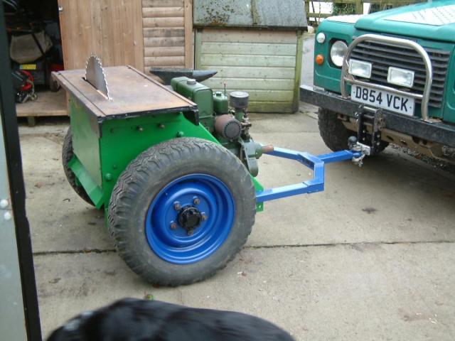

Stormin 4,458 #11 Posted September 2, 2015 Cut off the ring hitch today and fitted a ball coupling. Already to be put back to work and easy to move about with one of the horses. 5 Triumph66, meadowfield, pmackellow and 2 others reacted to this Share this post Link to post Share on other sites

Stormin 4,458 #13 Posted September 8, 2015 Had another go at the tap. This time I noticed some scoring inside the body. No amount of lapping will get rid of it. Replacement tap required. Share this post Link to post Share on other sites
Anglo Traction 1,018 #14 Posted September 8, 2015 Don't think my spares will fit Norm. Not easy to see what size it is, but look's 1/4" BSP?. Share this post Link to post Share on other sites
Stormin 4,458 #15 Posted September 8, 2015 I've located some on e-bay, Richard. I'll check thread sizes tomorrow. Share this post Link to post Share on other sites
Stormin 4,458 #16 Posted September 18, 2015 New tap procured and fitted. Already for work now. Share this post Link to post Share on other sites
