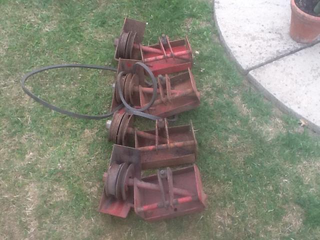

the showman 4,074 #12 Posted July 18, 2015 Found these today under the bench, there's some more somewhere ( i must store things the same in one place ) the one nearest the camera has cast pulleys the others have pressed pulleys 2 Triumph66 and nigel reacted to this Share this post Link to post Share on other sites

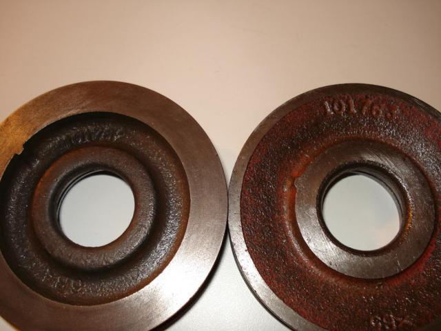

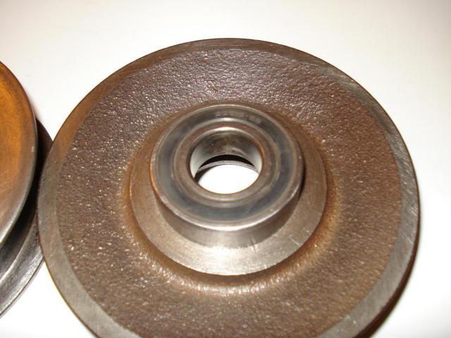

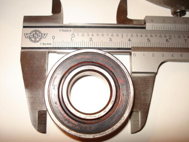

Anglo Traction 1,022 #23 Posted July 20, 2015 Real glad they fit your pulleys and hope they hold up long time ok. Still can't find any part number or dimension change anywhere. WH Bearing Part number 101480 only quotes the dims I have?. Here are my Pulleys and original Bearings. The pulley 'cast-in' part numbers are 101762/3. Maybe your assumption of Belgium producing/obtaining some pulleys with a different size metric bearing recess is possible . Share this post Link to post Share on other sites
Stormin 4,458 #24 Posted July 21, 2015 There is a difference in pulley numbers. Have PM'd you. Bearing OD is the same. 40.13mm. Share this post Link to post Share on other sites
