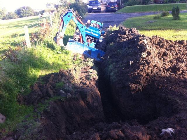

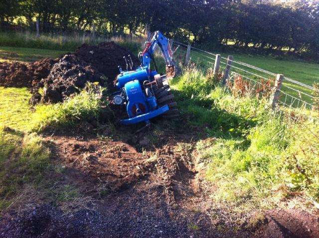

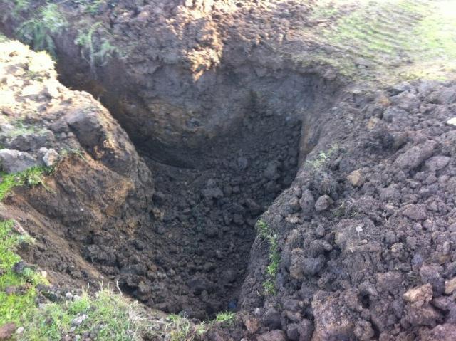

expeatfarmer 591 #1 Posted September 7, 2015 For some time I have had problems with a neighbors drain that crosses our land and so I have decided to intercept it and put in a manhole for rodding access. Good job for the digger so out it came nice hot sunny day, dug the trench, found the drains ( my wife is a dowser ) using two bits of fence wire, spot on location. made the trench much bigger for the manhole and then thought I would go back to the other end of the trench and clean it out ready to lay the pipe. I managed to straddle the trench without a problem until I came to a bit where the wall collapsed under me and pulled the track off the drive sprocket. Ho Hum! serves me right for being over ambitious, now I need to get some more crawlers out as a recovery team! 3 Alan, S1g and nigel reacted to this Share this post Link to post Share on other sites

Stormin 4,458 #9 Posted September 8, 2015 Well we got it out, didn't we. And I've STILL not driven a Ransome crawler. Share this post Link to post Share on other sites
Rocboni 257 #10 Posted September 8, 2015 How did you manage, pull it out? How come you didn't drive one, surely Jonathan would let you....he's got plenty of them.. Share this post Link to post Share on other sites
Stormin 4,458 #11 Posted September 8, 2015 Managed to carefully jack up the side on the bank just enough to get the track back on. Jacked up the front so we could just get a thick plank, (No comments thank you) under the front of the other track as a ramp and drove it out with the aid of a Fordson Dexta. He said I could drive it, but between a cup of coffee on his veranda, chatting and admiring the view, I forgot. 1 diggerjames reacted to this Share this post Link to post Share on other sites
