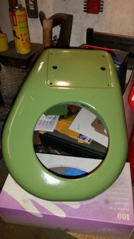

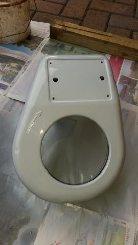

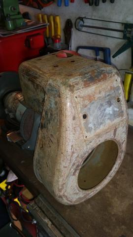

Darmic1 447 #26 Posted September 24, 2015 Also sorted the air shroud, stripped all the old paint using a heavy duty paint stripper, then a wire wheel. A couple of coats of etch, then some colour........ The "rat" look or not??? NOT! 4 S1g, nigel, Stormin and 1 other reacted to this Share this post Link to post Share on other sites

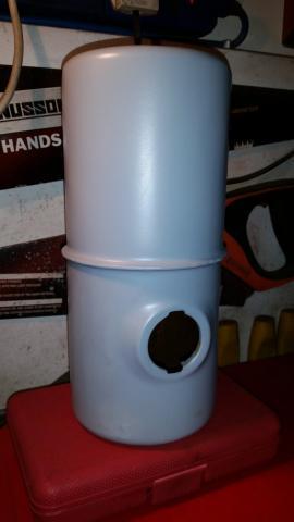

Darmic1 447 #30 Posted September 26, 2015 Refitted the cowling, then the carb........ Washed the fuel tank out. will remove all the old paint tomorrow afternoon........ 5 Stormin, S1g, Triumph66 and 2 others reacted to this Share this post Link to post Share on other sites

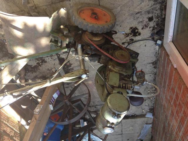

phil murrell 41 #36 Posted September 29, 2015 Here is a picture or two of mine still in its work clothes Share this post Link to post Share on other sites
phil murrell 41 #37 Posted September 29, 2015 2 S1g and Triumph66 reacted to this Share this post Link to post Share on other sites
Ian 2,417 #38 Posted September 30, 2015 That's a fantastic job with the engine, I can't wait to see the finished machine Share this post Link to post Share on other sites
the showman 4,074 #39 Posted September 30, 2015 You've got you phone upside down Phil Share this post Link to post Share on other sites

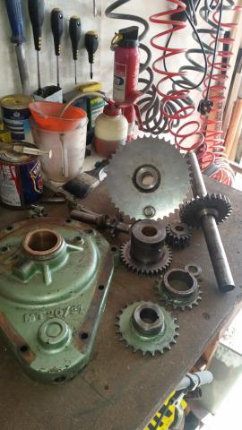

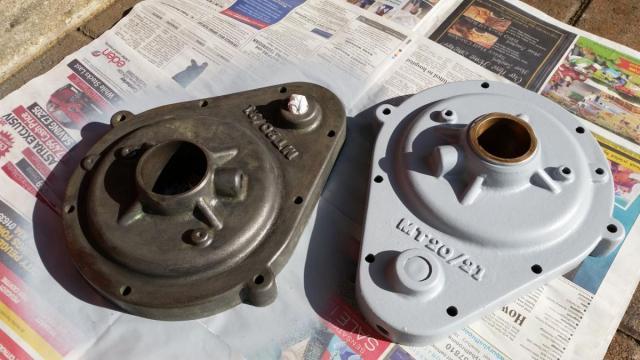

Darmic1 447 #42 Posted October 1, 2015 Not had much time this week. But have managed to move things along a bit. The fuel tank has been stripped, repaired and primed. The gearbox is now stripped down, cleaned, de-burred the gears and the outer case is now in primer ready for its top coat. The rest of metal work is at the blasters. Have even managed to order the steel tube and a decent tube bender to reproduce the 'missing' handle bars, couldn't believe what a local company were asking just to supply and bend a bit of tubing! 2 S1g and pmackellow reacted to this Share this post Link to post Share on other sites

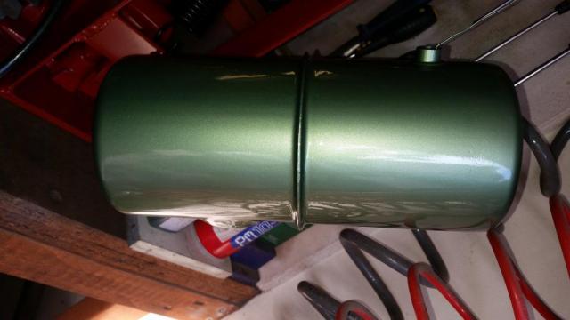

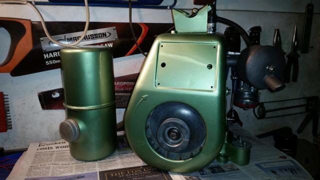

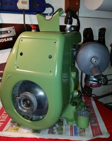

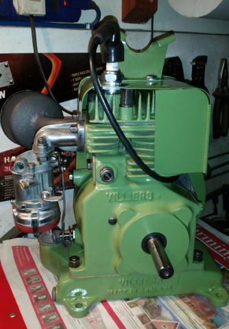

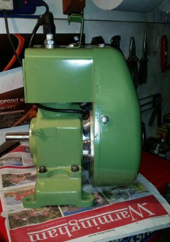

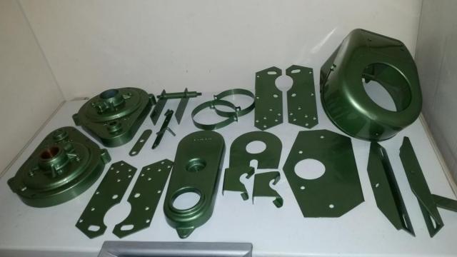

Darmic1 447 #44 Posted October 21, 2015 The Insomnia is back! So I thought i'd show you what I have done with the 1st of my days off. I haven't been happy with the flat colour supplied by the paint shop, so took some bits from the 2nd machine along and trawled through their colour chips until we found what we think is the perfect colour match to the original metallic finish. Its odd how when these machines were made they were able to mix a metallic paint which had a gloss finish to it, yet today it has to be a 2 stage, base colour and clear coat process! The bits were given several light coats of the base and left for around 2 hours to dry. I then activated the 2K clear and sprayed light coats over the base colour. . 2 pmackellow and Ian reacted to this Share this post Link to post Share on other sites

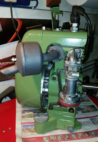

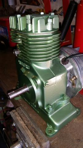

Darmic1 447 #45 Posted October 21, 2015 I then stripped the engine back to a point where I could respray it to the correct colour. Before painting and to ensure a good adhesion I lightly 'scotch bright' the surface and then began the process again. Here's the engine now in the correct colour. Fuel tank was next.......I do like the finish with these ProXL products! Refitted the cowling once dry and the various bits removed for painting back on the Villiers. 9 the showman, Bigend, Stormin and 6 others reacted to this Share this post Link to post Share on other sites
