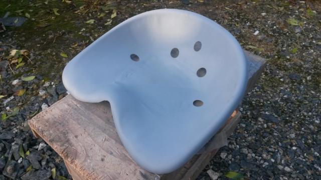

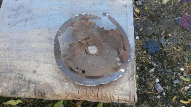

moogie 372 #26 Posted October 24, 2015 Another part ticked off the list today, think its from a Fordson Dexta. The centre of the seat was completely rotten so had to be cut out and repaired. Still need to get a centre bolt and seat spring. 3 Cub Cadet, Stormin and nigel reacted to this Share this post Link to post Share on other sites

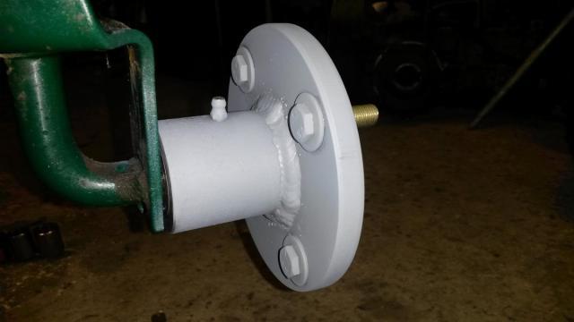

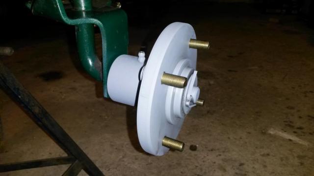

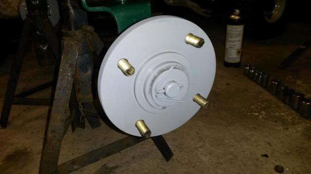

moogie 372 #28 Posted November 13, 2015 (edited) Got my front hubs today, very happy with how they turned out. Total cost of all parts and machine work £60. Now that i can measure the width of the front axle i can make a start on narrowing the rear axle. The Vitara axle has a offset diff so i need to remove 280mm from one axle tube and 320mm from the other. Once cut i will add a sleve to strengthen the tube and the half shafts will be sent out to be shortened. Need to go now and get a lend of a slide hammer to get the half shafts out and then the cutting can begin. Edited November 13, 2015 by moogie 8 Stormin, nigel, Vinnetrow and 5 others reacted to this Share this post Link to post Share on other sites
Ian 2,417 #29 Posted November 14, 2015 The hubs look good, a good "all in" price as well.. I'm looking forward to seeing the axle narrowing.. Plenty of photos please Share this post Link to post Share on other sites
