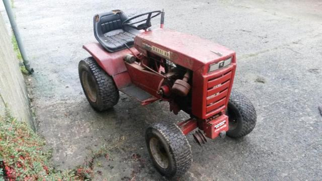

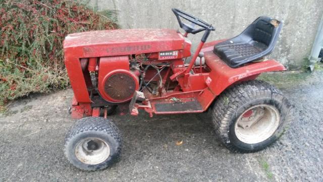

moogie 372 #1 Posted November 21, 2015 Now i've gone and done it, bought a Wheelhorse today ! Picked up a Raider 12 (well i think thats what it is) for £250. It says on the side Raider 12 but when i cross referenced the model number from the tag it says it is a 12HP 8 Speed. My info says the Raider 12 was made up untill 1972 with a different serial number, my serial number (1-0350) is for a 1973 12HP 8 Speed. So, is my info wrong or is my Wheelhorse a bitsa ? 8 Triumph66, C-101plowerpower, nigel and 5 others reacted to this Share this post Link to post Share on other sites
Anglo Traction 1,018 #2 Posted November 21, 2015 You're correct with the info . 1-0350 is technically a 12hp 8 speed. Belgium continued sticking surplus Raider Decals on them well into 1973 (the shorter Hood/Bonnet decals were from the late 60's Short frame models). So Decals are iffy for basing an I.D for WH here in Europe. The 8 Speed Transmission in it (if original) is likely to be the 5073 model, which was deemed to have a 10 pinion Limited Slip Diff. from 74 onward, they went to the 8 pinion non LSD. Good choice, User/Parts Manuals for Tractor and Tranny are available. 1 neil reacted to this Share this post Link to post Share on other sites

meadowfield 1,901 #5 Posted November 21, 2015 Nice find, Richard is right. Around 1973-1980 the Belgian models weren't always stickered as the model number indicates... Share this post Link to post Share on other sites

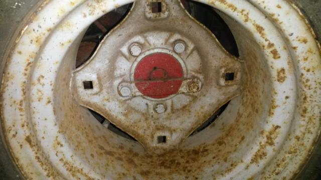

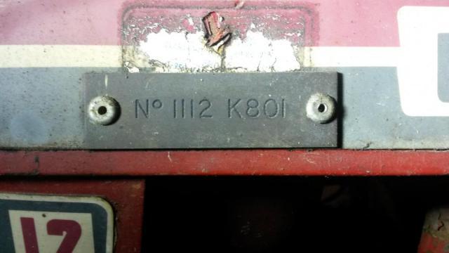

moogie 372 #7 Posted November 22, 2015 Thanks for all the information, i was getting a bit confused when the name and model number didn't tally up. Is the Raider 12 the same as a 12HP 8 speed as i cant find a manuel for the 12hp 8 speed ? There is a strap across two of the wheel studs which seems to be holding the axle in. Any ideas why it might be there ? Last question, there is a tag on the bonnet and i cant seem to find any reference to what the number means, can anyone shed some light on it ? Thanks, Noel. Share this post Link to post Share on other sites
meadowfield 1,901 #8 Posted November 22, 2015 Hi, Yes raider 12 manual is the same. The strap is home made to stop the hub sliding in, later models used two setscrews. That model no is a later style number where 11 would be 71, 12= HP, k= Kohler, 8 = 8 speed. 01 = belgium. That style was used from 77 onwards, so someone has added that later... 2 HeadExam and moogie reacted to this Share this post Link to post Share on other sites

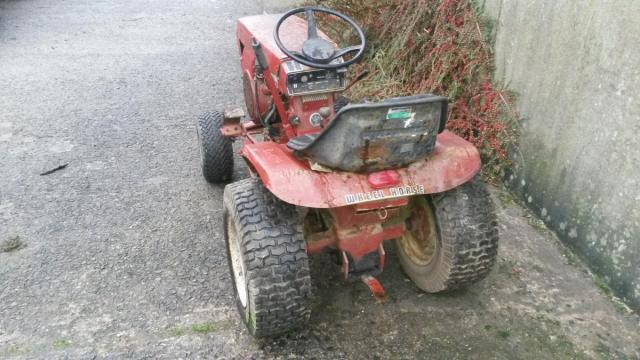

Anglo Traction 1,018 #10 Posted November 22, 2015 As Mark says, plus- There is a compromise with your Tractor. From your pictures, I can tell you that it is mainly a 1972 spec, but with 73> bits fitted (Belgium used up old stock from the U.S. I can only see a single pedal that will operate both the Clutch and the Brake (some serious adjust is required judging by the Peddle angle).....no problem. The main panels are 72, as the gear lever area is open and has the shorter Gear Shift decal plate. From 73> in U.S. They fitted Seat Springs and a slightly longer (1inch) upper Steering Shaft for Knee clearance. Also the PTO Hoop set up you have is '73'>. Dash Panel is difficult to see. A 73 wiring Loom will have a 3 position Ignition Switch, Part number 103990 . A 72 Loom was 4 position and has an Accsr'y position (101917). So best thing to do is pop over to Redsquare via this link, which will take you to the Manuals section and you can download what you need. You need Part/User Manuals for an 1-0311 (72 Raider 12) and Manuals for the 1-0350 (73 12-8psd) - http://www.wheelhorseforum.com/files/category/9-1973-1977/ Ignore what is on the riveted plate on your Hood/Bonnet, in fact I would remove it. Only thing to bear in mind is the Manuals/Parts Lists and Specs are all for the U.S. Models/Market. As far as I know, there were never any Manuals produced for Belgium Assembled variants. So you have 2 Forums to play with, if you need any help with it.... and I have both 72 Raider 12 and a 74 12hp. 1 moogie reacted to this Share this post Link to post Share on other sites

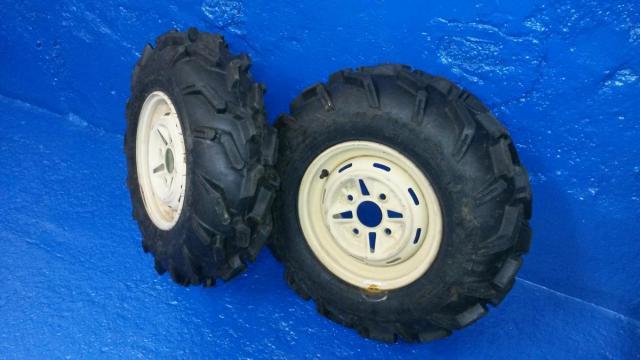

moogie 372 #14 Posted December 25, 2015 Got a great Christmas present from my friend Gary (Minky) two new Carlisle tyres, just need to find something to use the rims on. 3 meadowfield, pmackellow and Triumph66 reacted to this Share this post Link to post Share on other sites
