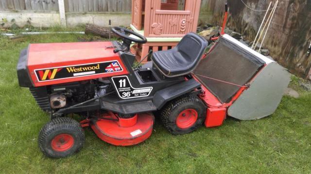

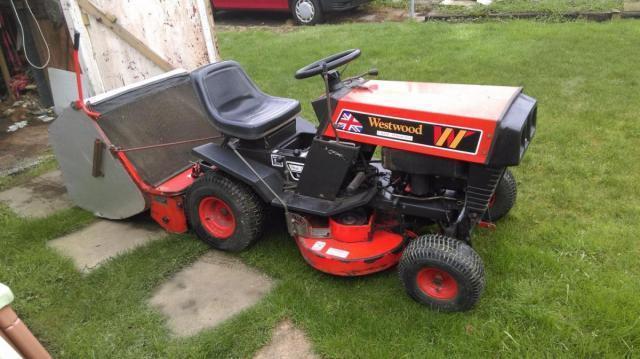

Andyp88 8 #1 Posted December 31, 2015 Hi all. New to forum. Just acquired a Westwood Gazelle W11. Seller said battery was flat but it would start with pullstart. Found out that the battery is ok but still won't start with starter. Is there a way of checking the starter motor and solenoid for faults? Thanks in advance. Andy 1 Joe the small engine man reacted to this Share this post Link to post Share on other sites

Joe the small engine man 89 #11 Posted January 1, 2016 that looks like a tidy machine, good luck with the starter testing. Regards Joe 1 Andyp88 reacted to this Share this post Link to post Share on other sites

The Fife Plooman 632 #14 Posted January 2, 2016 Hi Andy Welcome to the forum You have a nice start to your collection it looks well,give it a good clean down and paint it with Owatrol oil it is air dried and prevents further rust. When you use it a little goes a long way Frae the Fife Plooman Share this post Link to post Share on other sites
