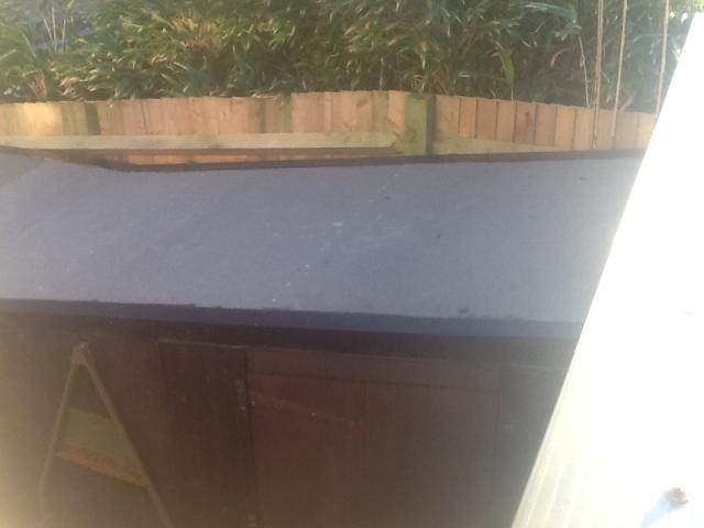

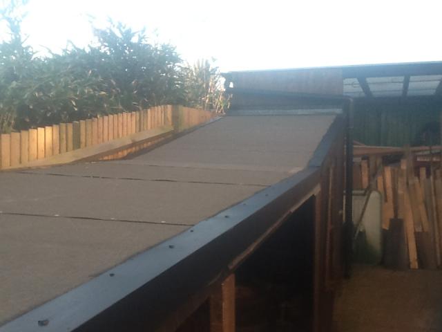

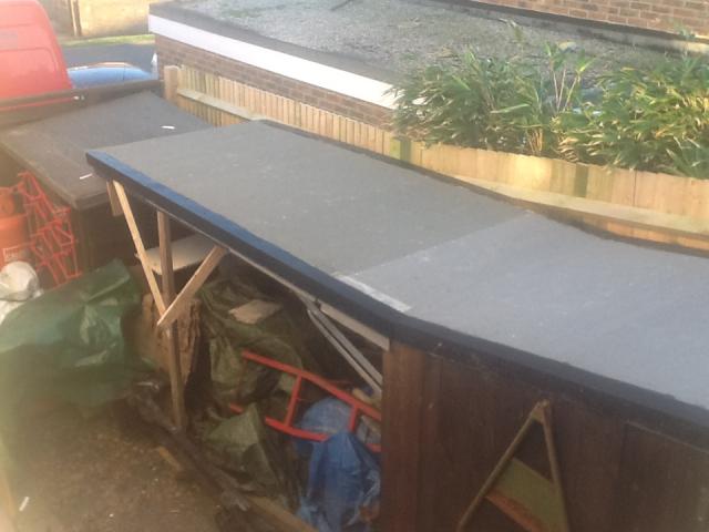

the showman 4,074 #30 Posted January 15, 2016 As its been a nice and dry day I managed to finish the roof. Its had a good coats of adhesive and 2 layers of felt I warmed up the sides and used 80x80 plastic angle siliconed and nailed on then painted black as they only do white. Its all buttoned up and watertight and should stand the high winds we have here on the Southcoast. Next job is the front lower plate and make some doors. 6 Stormin, pmackellow, Ian and 3 others reacted to this Share this post Link to post Share on other sites
Alan 1,274 #31 Posted January 15, 2016 Thought you would have painted the edges RED Chris. 1 Triumph66 reacted to this Share this post Link to post Share on other sites
pmackellow 2,738 #32 Posted January 15, 2016 Proper job Share this post Link to post Share on other sites
the showman 4,074 #33 Posted January 15, 2016 Thought you would have painted the edges RED Chris. I did think of that , but I don't Pam would have been to pleased she's already asking when it's going to be a woodstore again !!! Share this post Link to post Share on other sites
meadowfield 1,901 #34 Posted January 15, 2016 All that effort and its full already 1 the showman reacted to this Share this post Link to post Share on other sites
nigel 1,881 #35 Posted January 15, 2016 nice job chris 1 the showman reacted to this Share this post Link to post Share on other sites
diggerjames 543 #36 Posted January 15, 2016 Looking good Chris that stable Share this post Link to post Share on other sites
Triumph66 1,256 #37 Posted January 16, 2016 That's a tidy job Chris. I got to re felt a customer's shed next week and make a door as well. Share this post Link to post Share on other sites

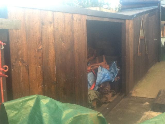

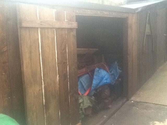

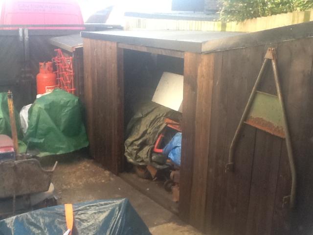

the showman 4,074 #38 Posted January 19, 2016 As it was a nice sunny day I managed to get the front wall done. First job was the bottom rail, I drilled through the concrete and fixed it down with 4 10mm x 175 mm anchor bolts then made a frame to attach the wall boards, I've put silicon in between the joints just to make it extra water tight. Just a pair of doors to make now ( when i get some more wood ). Here's a couple of pictures for Norm to look at . 3 nigel, Alan and pmackellow reacted to this Share this post Link to post Share on other sites
Stormin 4,458 #39 Posted January 19, 2016 Will you be able to get that tractor out through that door? Share this post Link to post Share on other sites
the showman 4,074 #40 Posted January 19, 2016 Hope so mate, my next move is to empty the shed and swap the tractor with another, if it doesn't come out I'll make the hole bigger before i make the doors Share this post Link to post Share on other sites
nigel 1,881 #41 Posted January 19, 2016 looking good chris Share this post Link to post Share on other sites
pmackellow 2,738 #42 Posted January 19, 2016 Very smart Chris Share this post Link to post Share on other sites
diggerjames 543 #43 Posted January 19, 2016 Wow looking good mate Share this post Link to post Share on other sites

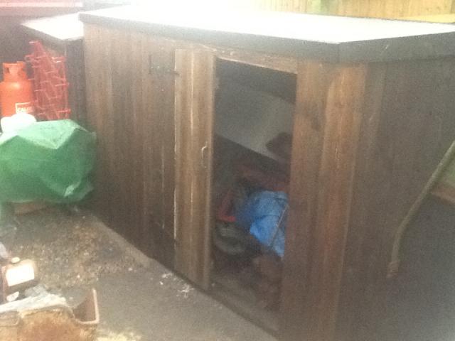

the showman 4,074 #44 Posted January 22, 2016 Small update I wasn't going to bother with but Norm wanted a photo so here's 2 4 pmackellow, Alan, nigel and 1 other reacted to this Share this post Link to post Share on other sites
Alan 1,274 #45 Posted January 22, 2016 Looks foggy in your yard Chris. Or is it from smouldering wood caused by your high speed sawing. Share this post Link to post Share on other sites
nigel 1,881 #46 Posted January 22, 2016 Looks foggy in your yard Chris. Or is it from smouldering wood caused by your high speed sawing. its the smoke from his old wheelhorses Share this post Link to post Share on other sites
the showman 4,074 #47 Posted January 22, 2016 I think its the camera on the ipad Alan or it could be smoke from the wood burner its the smoke from his old wheelhorses At least mine run ok ! 1 diggerjames reacted to this Share this post Link to post Share on other sites

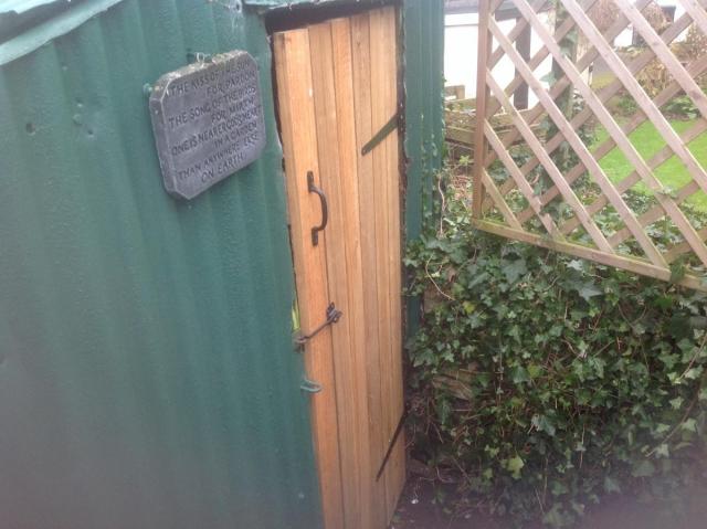

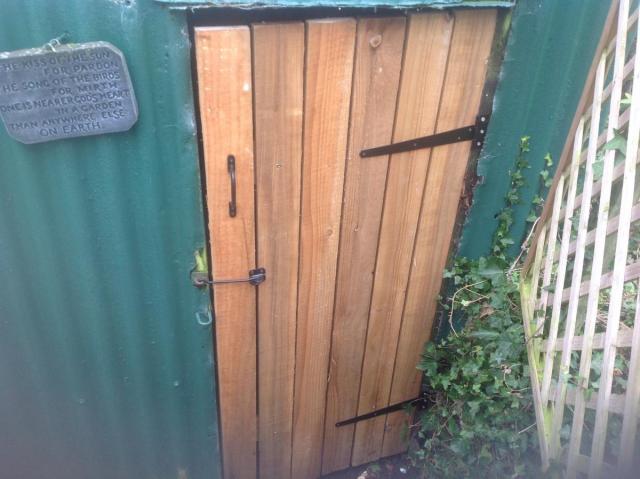

Triumph66 1,256 #48 Posted January 22, 2016 Looking good. I made and replaced a customer's shed door myself yesterday. The shed was an old air raid shelter from WWII. Actually quite pleased with how it all went together. 3 diggerjames, pmackellow and Alan reacted to this Share this post Link to post Share on other sites
the showman 4,074 #49 Posted January 23, 2016 Good job Andrew and you get paid for doing yours 1 Triumph66 reacted to this Share this post Link to post Share on other sites
Triumph66 1,256 #50 Posted January 23, 2016 It's funny how I can do these jobs when I get paid for it! Never seem to be able to get time to do these jobs around the house! Share this post Link to post Share on other sites
