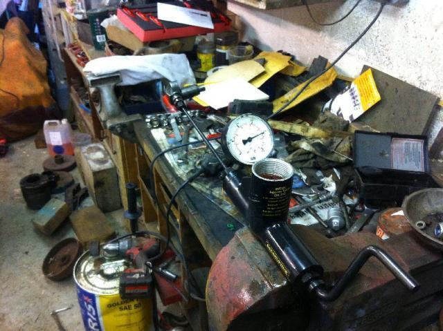

expeatfarmer 591 #51 Posted February 7, 2016 Now that was a revelation, I managed to borrow a portable injector testing rig which was a bit of a faff to set up but once sorted it showed me that one of the injectors I have was cracking off at over 4000lbs/sq inch ( nice pattern though ) the other looked like that little boy fountain cracking off at 1000 psi with a squirted stream and the dribbles. The crack pressure is adjusted by fitting schims or washers under the injector spring, I played around with one for about an hour trying to achieve 2250 psi and gave up at 2100 fitted it to the engine, it started a bit better but still smoked. I decided to closely examine the governor mechanisms and found that the one fitted had a bent spring locating shaft which was causing the rotor to be obstructed. If it was not for the time constraints I would be finding it interesting following on from previous owners trying to analyse just what they have adjusted to keep the machine running in the past as it is now it is a right pain as I really don't have enough set up information to restore factory settings as they say. Things like the rod that links the rack on the pump to the governor the one fitted has been adjusted longer than the one I have from a running engine but swapping makes no difference. Maybe if I stand and look at it long enough some crucial thing may become apparent ( I wish ) Crack pressure tester in action sitting at 4000psi !!! Share this post Link to post Share on other sites

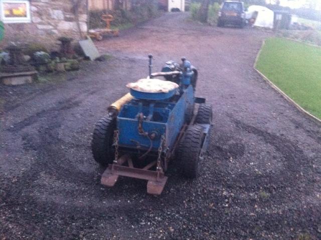

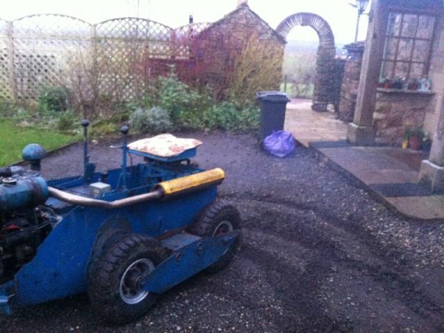

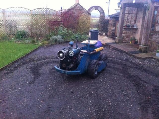

expeatfarmer 591 #73 Posted February 10, 2016 All done! Went for a ride up the road to the next farm. Starts really well from cold or hot, seems to lack power but hey who cares it moves and smoke is minimal. Steers well on grass and gravel bit sluggish to steer severely on tarmac but then new tyres etc. Throttle still a bit stiff but again newness in the governor and I am certainly not going to mess about with it. First two pictures are engine ticking over at 510 rpm, third picture is full bore at 2100 rpm. Does smoke more under load but again it is 4 degrees here. 3 nigel, hpearce and Rocboni reacted to this Share this post Link to post Share on other sites
Rocboni 257 #74 Posted February 10, 2016 Looks virtually smoke free! Mine steers exactly how you describe it, sluggish on tarmac, not great in 3rd gear unless you have a bit of momentum. Looks better without that big piece of channel welded to the back. Share this post Link to post Share on other sites
Chris 642 #75 Posted February 10, 2016 I thought 3rd was best going straight Thats a good welcome to your place Jon. Skid marks in front of your house 1 Triumph66 reacted to this Share this post Link to post Share on other sites
