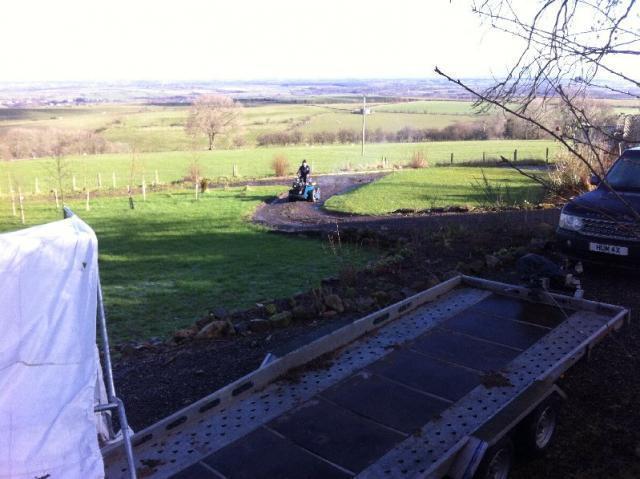

expeatfarmer 591 #77 Posted February 11, 2016 Stormin around the garden Share this post Link to post Share on other sites

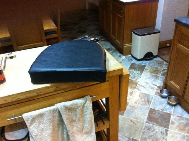

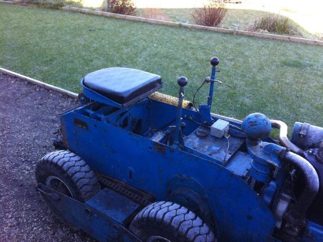

expeatfarmer 591 #81 Posted February 22, 2016 What a frustrating day today. The ITW took ages to start, the Whitlock loader has a major diesel leak behind the engine cowling ( fuel pump banjo) 137 decided to play silly beggars and not start and then to cap it all the digger dozer decided to shear the key that drives the hydraulic pump in addition to which it is running badly. Thanks to Norman who was busy washing off machines and helping to sort the keyway all back on track again but knackered my back and feeling very grumpy. Only good thing for the day is that my wife janet has stitched up a beautiful leather cloth seat cover for the ITW which I am about to staple on. had to leave the Whitlock and ITW outside as it is now freezing and I have not the energy to fanny about getting them started. With my luck it will be pouring with rain in the morning. Share this post Link to post Share on other sites

expeatfarmer 591 #83 Posted February 22, 2016 Digger is sorted just needs to clean up the carb, fuel bowl had water in it. Lovely seat fits a treat. 3 Stormin, ranger and nigel reacted to this Share this post Link to post Share on other sites
Rocboni 257 #84 Posted February 22, 2016 Very nice, I'm sure it's comfier than the cushion. Share this post Link to post Share on other sites
expeatfarmer 591 #85 Posted February 22, 2016 Certainly is ! Share this post Link to post Share on other sites

expeatfarmer 591 #92 Posted February 24, 2016 Certainly plenty of Bruno smoke over the last few weeks. ITW fired first pull on the handle this morning , instantly ran on the starter with little smoke. I would have persisted with the manual start but knackered my back yesterday so thought I would save it for Malvern. Nice seat fits a treat. 3 S1g, nigel and hpearce reacted to this Share this post Link to post Share on other sites
