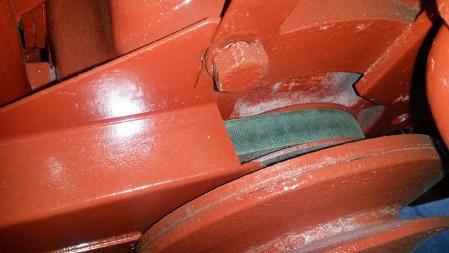

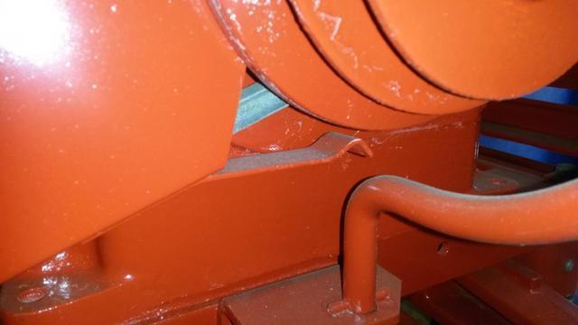

Anglo Traction 1,022 #27 Posted April 6, 2016 3 hours ago, moogie said: Would you have a picture of the part you are talking about ? Thanks, Noel. Sorry, won't let me post images any more. It has allowed me to upload Manuals, so, assuming you don't have either of these, I've posted both the Illustrated Parts List and Operators Manual for 1975 C Series. Will cover nearly all (or should do) of your Model. Part (Belt Cover) is shown in Figure 8 of parts Man. How to adjust Belt Tabs/Guides for clearance is on page 16 (fig22) of the Operators Manual. Regards. Share this post Link to post Share on other sites
moogie 372 #28 Posted April 9, 2016 On Wednesday, April 06, 2016 at 8:35 PM, Anglo Traction said: Sorry, won't let me post images any more. It has allowed me to upload Manuals, so, assuming you don't have either of these, I've posted both the Illustrated Parts List and Operators Manual for 1975 C Series. Will cover nearly all (or should do) of your Model. Part (Belt Cover) is shown in Figure 8 of parts Man. How to adjust Belt Tabs/Guides for clearance is on page 16 (fig22) of the Operators Manual. Regards. Had a look at my belt guard, the bottom one is there but the top is missing. Another job to add to the list ! Share this post Link to post Share on other sites

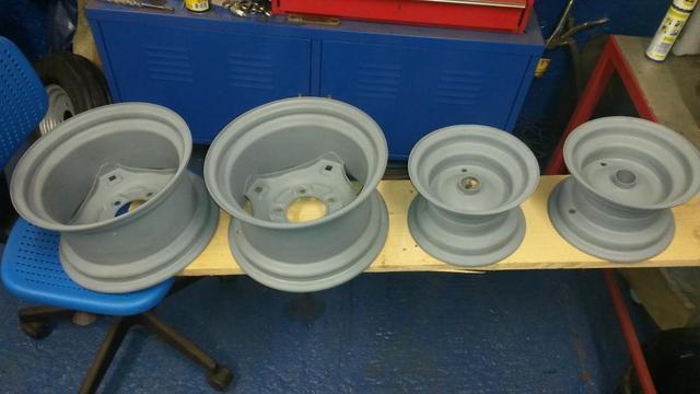

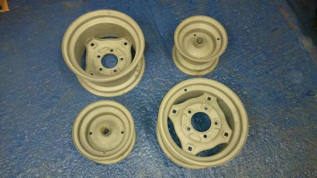

moogie 372 #29 Posted April 9, 2016 Got the rims back from the blasters today, much easier than trying to clean them up with sand paper and only cost £20. A quick dust down, knock a couple of dents out of the edge of the rim and a spot of primer to stop any rust from appearing. If it stops raining i might even get a coat or two of paint on them over the weekend. 1 minky reacted to this Share this post Link to post Share on other sites

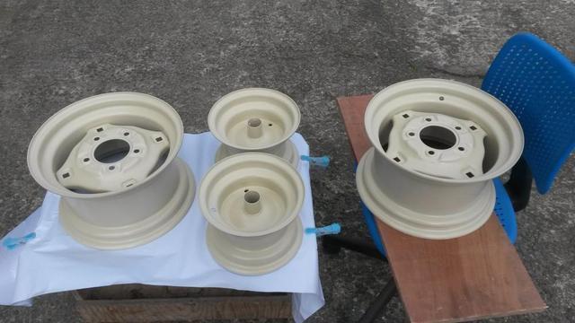

moogie 372 #30 Posted April 16, 2016 Not much of an update, managed to get one coat of antique white on the rims today before it started to snow ! 4 Triumph66, minky, nigel and 1 other reacted to this Share this post Link to post Share on other sites
diggerjames 543 #31 Posted April 17, 2016 Looking really well 1 moogie reacted to this Share this post Link to post Share on other sites

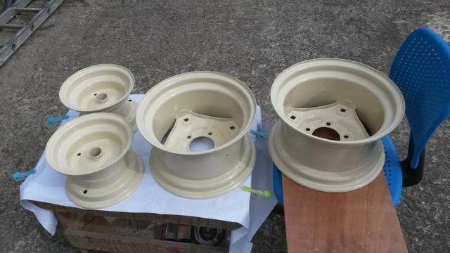

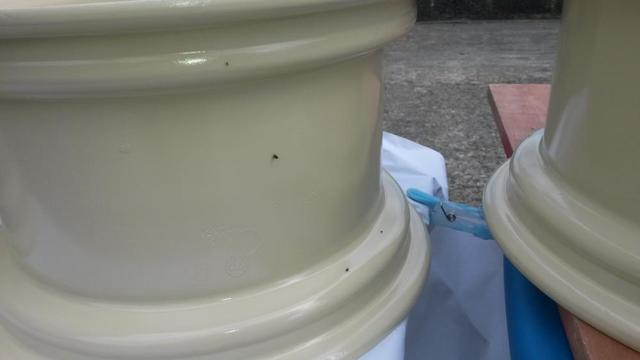

moogie 372 #32 Posted April 17, 2016 Managed to get the rest of the rims painted today. Ever notice, as soon as you set out something that is freshly painted all the flys in the country have to land on it ! WHY ? What it it about fresh paint that is so appealing ? 2 Cub Cadet and Stormin reacted to this Share this post Link to post Share on other sites

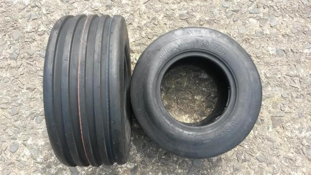

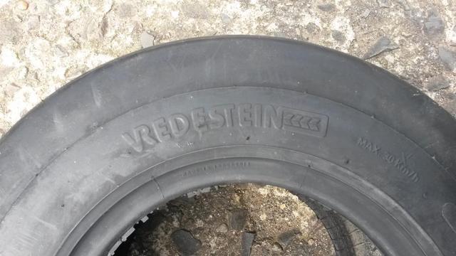

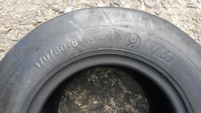

moogie 372 #34 Posted April 18, 2016 New front tyres arrived today. Would have liked three rib tyres but they were working out too expensive. Around £150 each. These cost £48 each including postage. Share this post Link to post Share on other sites
meadowfield 1,901 #35 Posted April 18, 2016 Noel, you should have said - we buy tri ribs from allterrain here in the UK. about £20 each! Share this post Link to post Share on other sites
moogie 372 #36 Posted April 18, 2016 4 minutes ago, meadowfield said: Noel, you should have said - we buy tri ribs from allterrain here in the UK. about £20 each! Seen them, only thing is they are 4 inch wide, i wanted to keep the orignal rims so needed a 6 1/2 inch wide tyre. Only ones i could find that width were Firestone ones which are silly money. Share this post Link to post Share on other sites

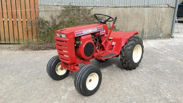

moogie 372 #38 Posted April 19, 2016 Almost there, just need a new seat. 8 C-101plowerpower, nigel, the showman and 5 others reacted to this Share this post Link to post Share on other sites
the showman 4,074 #39 Posted April 19, 2016 Looks the nuts, bet your pleased with that Share this post Link to post Share on other sites
nigel 1,881 #40 Posted April 19, 2016 Looks great noel 1 moogie reacted to this Share this post Link to post Share on other sites
Stormin 4,458 #41 Posted April 19, 2016 Nice! Be sometime before mine looks like that. That is if it ends up like that. 1 moogie reacted to this Share this post Link to post Share on other sites
moogie 372 #42 Posted April 19, 2016 1 hour ago, the showman said: Looks the nuts, bet your pleased with that It has turned out better than i had hoped. Time to find my next project i think. Share this post Link to post Share on other sites
meadowfield 1,901 #43 Posted April 19, 2016 Looking smart, if you want the original seat of closest match, look up kab p2. They are one and the same.... 1 moogie reacted to this Share this post Link to post Share on other sites
Triumph66 1,256 #44 Posted April 22, 2016 That's looking darn cool James. Actually the tyres set it off very nicely. Share this post Link to post Share on other sites
neil 524 #45 Posted April 22, 2016 Lovely job you made there, love those rear boots, what make are they & where did you aquire them ? 1 moogie reacted to this Share this post Link to post Share on other sites
moogie 372 #46 Posted April 23, 2016 9 hours ago, neil said: Lovely job you made there, love those rear boots, what make are they & where did you aquire them ? They are Carlisle Titan A.C.T (all conditions tyre) you can get them from All Terrain Tyre, although mine were a Christmas present Size is 25-8.00x12, a little tight for clearance, had to move seat pan and floor boards a little. The 23-7.00x12 might be a better size for clearance. Share this post Link to post Share on other sites
