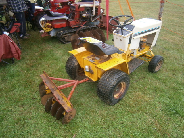

the showman 4,074 #1 Posted May 30, 2016 Last year vegikev gave me 5 disc's on an old frame and 5 spare ones they've been kicking around in my driveway so today I thought ide do something with and decided to make a usable set for my mate Paul. i have a load of steel box section of different sizes so i set to work with the electric saw and the stick welder. heres a few photos of today's effort, still a bit more to do but I'm really pleased with it so far 7 DevonianRedneck, ranger, pmackellow and 4 others reacted to this Share this post Link to post Share on other sites

the showman 4,074 #13 Posted June 1, 2016 Was wondering if it matters which way they angle, should i pull the centre forward or backward to get the angle ? Share this post Link to post Share on other sites
pmackellow 2,738 #14 Posted June 1, 2016 I'm not sure, I think your smaller set are angled backwards in the middle, like the set we borrowed at Biddenden Tractorfest last year... Share this post Link to post Share on other sites
the showman 4,074 #15 Posted June 1, 2016 My bigger wheelhorse set angle the same way 1 pmackellow reacted to this Share this post Link to post Share on other sites
Stormin 4,458 #16 Posted June 1, 2016 That's how they should be. Share this post Link to post Share on other sites
pmackellow 2,738 #17 Posted June 2, 2016 Glad we've got that sorted out then Share this post Link to post Share on other sites
the showman 4,074 #18 Posted June 2, 2016 Done a bit more today and made them to angle backwards. 5 nigel, Stormin, pmackellow and 2 others reacted to this Share this post Link to post Share on other sites

DevonianRedneck 86 #22 Posted June 2, 2016 with regards to the angle of the discs, larger agricultural sets of a modern design are adjustable for different tasks, the sharper the angle the more aggressive the action, this is caused by the vibrating action of the discs, faster you go the better they work, this is for gaining a fine tilth. Setting the discs to no angle so they are straight is used for primary cultivations to chop fibrous matter up. Reversing the angle of the discs on a smaller set you can use them as a very basic bed former to throw soil into ridges, on dual sets you have the front set pointing forward and the rear set pointing backwards, this means the front set throws the soil out and the rear set pulls it back in resulting in a level fine seed bed. 5 Stormin, the showman, pmackellow and 2 others reacted to this Share this post Link to post Share on other sites

the showman 4,074 #24 Posted June 3, 2016 Thanks for the info, i can angle them back further just by drilling 2 more holes 1 pmackellow reacted to this Share this post Link to post Share on other sites
