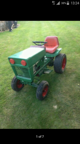

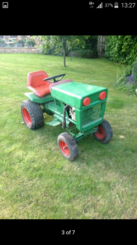

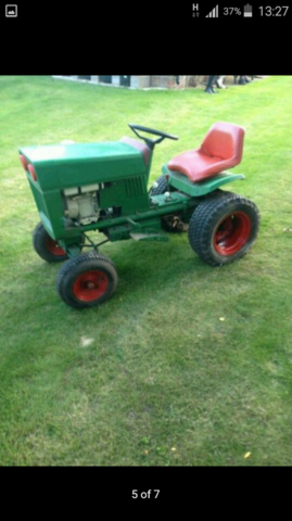

madmatt01 107 #1 Posted July 8, 2016 Going to collect this Tonight. Unsure what model it is. Apparently has a briggs and stratton engine Something for little man to grow into... Any info on one off these? And will wheel horse rear wheels fit? 6 the showman, C-101plowerpower, expeatfarmer and 3 others reacted to this Share this post Link to post Share on other sites
the showman 4,074 #2 Posted July 8, 2016 That looks a nice little tractor, is it a John deere, the little fella will be well pleased with that. Share this post Link to post Share on other sites
madmatt01 107 #3 Posted July 8, 2016 Said bolens in the add... but the chap wasn't sure on year or model. Iv narrowed it down to a bolens husky? But nothing further than that... and I don't think any off them came with briggs and stratton 1 Triumph66 reacted to this Share this post Link to post Share on other sites
Triumph66 1,256 #4 Posted July 8, 2016 Definitely a Bolens and a damn good price too! It's a Tube Frame model with a Briggs engine. Be good to see a photo of the engine to identify it. Nice find! By by the way, one Bolens ain't enough! Share this post Link to post Share on other sites
Triumph66 1,256 #5 Posted July 8, 2016 Matt, some Bolens did come with Briggs and Stratton..... Share this post Link to post Share on other sites

nigel 1,881 #7 Posted July 8, 2016 Mat it looks like a 700 or 750 they did have Briggs engines in if you look in downloads ime sure I put the parts and operators manuals on here also have a look in my posts ime sure I did one on these a couple of years ago 1 Triumph66 reacted to this Share this post Link to post Share on other sites

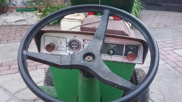

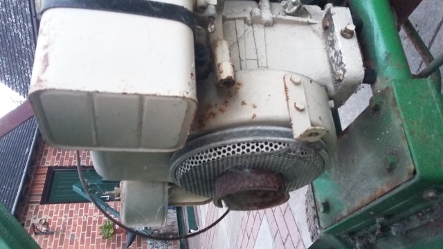

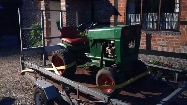

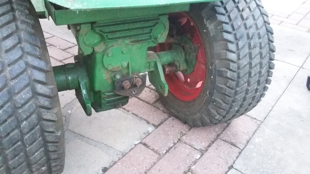

madmatt01 107 #9 Posted July 8, 2016 Woukd be interested in some pics.he has just emailed me. Update. .. here now and the old boy got all sorts 3 Triumph66, minky and Stormin reacted to this Share this post Link to post Share on other sites
Triumph66 1,256 #10 Posted July 8, 2016 Look like you got the original B&S engine in there or at least an age related one. Could be a 650 or a 750 which were made in the mid '60s. The engine should have a serial number on it which will hope date it and also give you the HP as well. Share this post Link to post Share on other sites
madmatt01 107 #11 Posted July 8, 2016 That will probably wait til tomorrow... chuffed as nuts though! What sort off age we thinking it may be? Also pressume the green isn't standard? Share this post Link to post Share on other sites
pmackellow 2,738 #12 Posted July 8, 2016 Nice find Matt Should be white I reckon Share this post Link to post Share on other sites
Triumph66 1,256 #13 Posted July 8, 2016 Bodywork should be white with red wheels. Mid 1960s approximately. Are you interested in the Bolens tyres? They are in Sturminster Newton, Dorset. I have bumped up the post in the For Sale section here. Share this post Link to post Share on other sites

madmatt01 107 #16 Posted July 8, 2016 1 hour ago, Stormin said: Very nice shepherds hut. The hut and the log splitter he made himself put off old odds and sods. Very talented man. 1 hour ago, Triumph66 said: Bodywork should be white with red wheels. Mid 1960s approximately. Are you interested in the Bolens tyres? They are in Sturminster Newton, Dorset. I have bumped up the post in the For Sale section here. Yes interested in the tyres. Will message you. I quite like the way this has been done... the paintwork is generally very good. Has been well stored for 15 years and I think it looks 'just right' Few question.... where would I find engine number and chassis number? Also there is no spark? Where should my first port off call be to look for Thanks all 1 minky reacted to this Share this post Link to post Share on other sites
madmatt01 107 #17 Posted July 8, 2016 What woukd it's value be aswell? As a running driving tractor. Just out off curiosity as no plans to sell Share this post Link to post Share on other sites
DevonianRedneck 86 #18 Posted July 8, 2016 if threres no spark its most likely just gonna be a case of cleaning and re-gapping the points, check the plug is functioning of course, if that fails, move on to checking coil and condenser, its also really easy to convert a briggs to electronic ignition if you want to go down that route. Share this post Link to post Share on other sites
madmatt01 107 #19 Posted July 9, 2016 11 minutes ago, DevonianRedneck said: if threres no spark its most likely just gonna be a case of cleaning and re-gapping the points, check the plug is functioning of course, if that fails, move on to checking coil and condenser, its also really easy to convert a briggs to electronic ignition if you want to go down that route. I pressume all this is behind flywheel ? Havent really looked.yet... bet easy enough to check? What's the best way to do it Share this post Link to post Share on other sites
Stormin 4,458 #20 Posted July 9, 2016 Points are behind the flywheel. From memory, remove the bolt from flywheel centre. Not sure if I fitted a bolt into the flywheel or used a puller. Give the bolt/puller a smack and it should come off. Don't try to prise it off. As Henry said, you can fit electronic ignition. Easy and cheap to do. Share this post Link to post Share on other sites

Triumph66 1,256 #22 Posted July 9, 2016 Matt, I think around £200, possibly £275 as there are no attachments with it and it been painted in the wrong colour (even though it been done well). Still a good looking GT though. With the right rear tyres it will fetch more.... Share this post Link to post Share on other sites
