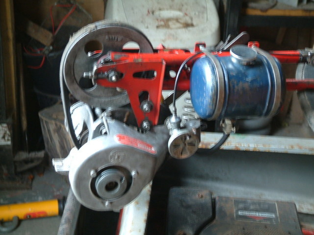

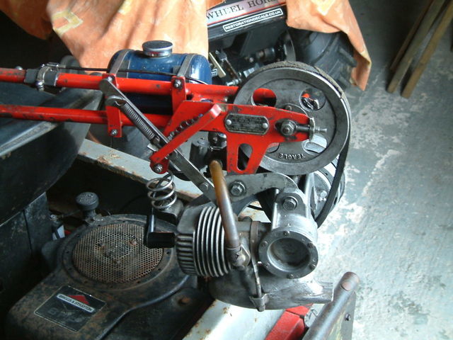

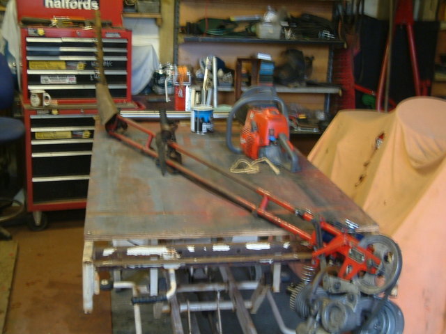

Stormin 4,458 #11 Posted November 3, 2016 Couple of photo's of the beast. Apologies for the slightly out of focus. 1 S1g reacted to this Share this post Link to post Share on other sites
Alan 1,274 #12 Posted November 3, 2016 Nice little motors Norm. I should have grabbed those at John's before someone nicked them. Not sure what they were attached too. Could only see the motors peering out from the bushes. Share this post Link to post Share on other sites
Stormin 4,458 #13 Posted November 3, 2016 They are indeed, Alan. Nice simple design. You don't get things like that anymore. Share this post Link to post Share on other sites
