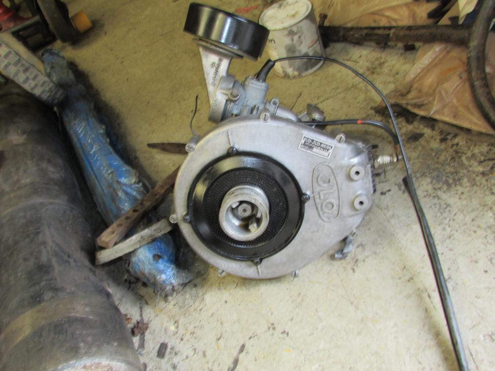

S1g 579 #2 Posted February 19, 2017 The engine on these machines are a JLO two stroke. As ive said before on here this engine design was purchased by the construction company Wacker, so a good friend of mine, who is a retired Wacker service engineer said he would rebuild it for me. I took this plus another old short motor I had lying around up to him. Even though the seller claimed it was running when put away in the shed (where have we heard that before?) it still needed a crankcase half, piston rings, seals, bearings and a set of points, all courtesy of Wackers scrap bin many years ago when they decided to make the engine obsolete! It has now had a full clean up. Ive also dug through my sheds and found an as new cylinder head so will be fitting this over the next few days. 3 pmackellow, Darmic1 and Stormin reacted to this Share this post Link to post Share on other sites

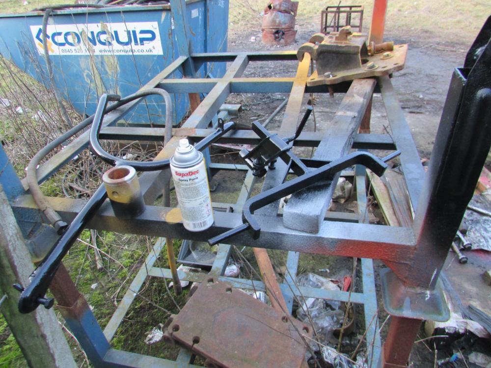

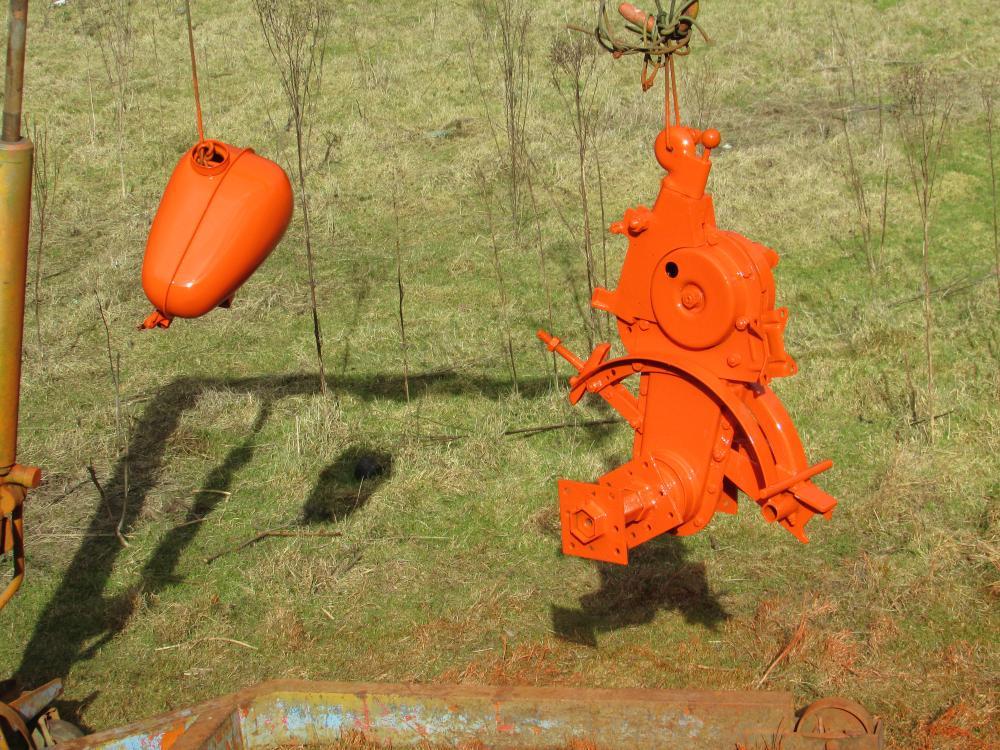

S1g 579 #3 Posted February 19, 2017 The basic machine with the engine removed looked pretty grotty, but after a hot wash this came up surprisingly well. Next several applications of paint stripper followed. Then I applied a few coats of a new primmer (as stated above I wanted to see how it worked with the Howard Orange.) 3 Stormin, Darmic1 and pmackellow reacted to this Share this post Link to post Share on other sites

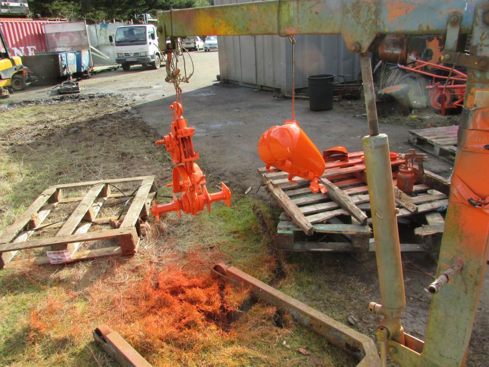

S1g 579 #4 Posted February 19, 2017 This morning after checking the forecast for the coming week I went to my worked and sprayed the top coat. This will be left to dry for a few days. In the meantime I will start painting all the black bits. I purposely am not going to go over the top, as I would like to put this machine to work, once its finished. 5 Stormin, Darmic1, Alan and 2 others reacted to this Share this post Link to post Share on other sites

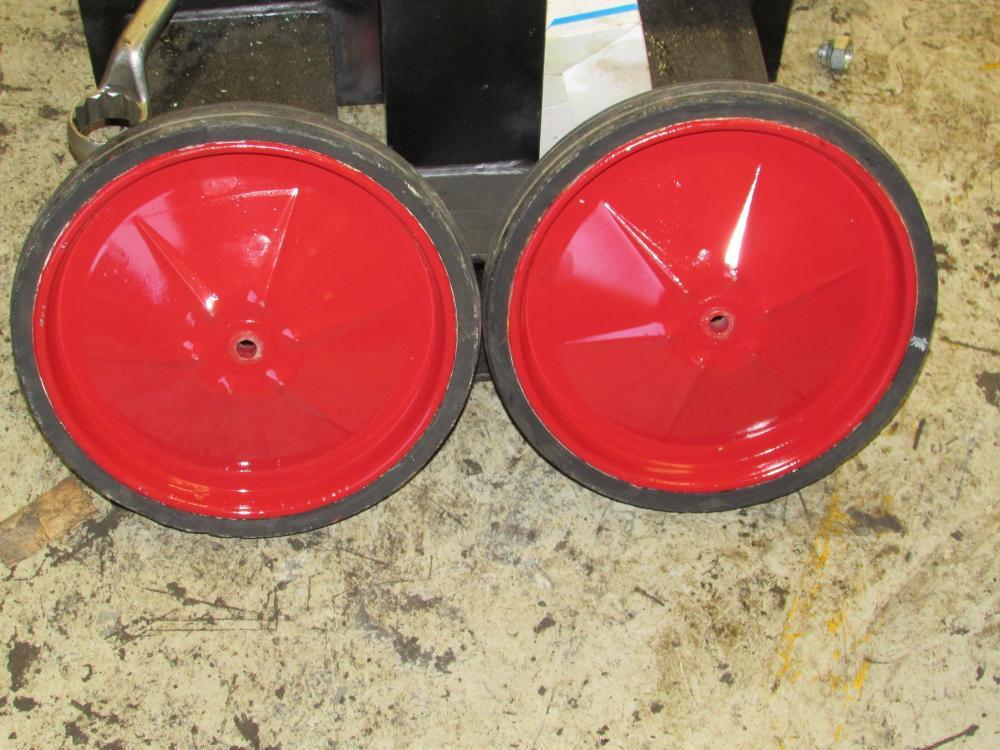

S1g 579 #13 Posted February 20, 2017 Made a bit more progress today. You may of noticed that the rear wheels look like they are off a golf trolley or similar. Looking at the brochure I noticed that they looked very similar to Landmaster Wheels so I purchased a set off ebay and painted them up. They have been in store for a few years, so today I dug them out and am going to have to give the tyres a clean up, but apart from that they are nearly ready to fit. Share this post Link to post Share on other sites

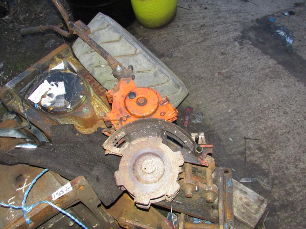

S1g 579 #15 Posted February 20, 2017 As stated above, I managed to a couple of years ago obtain a scrap machine. This has donated the front wheel, depth foot and a slightly better fuel top. Also on it was a narrow set of blades and a set of side shields. These will be kept to one side for a while until I have time to restore them as well. Share this post Link to post Share on other sites

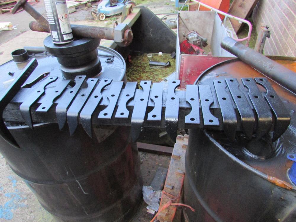

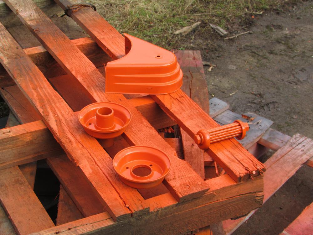

S1g 579 #16 Posted February 20, 2017 After work today I painted the 16 separate blades , handles and depth foot etc. 1 Stormin reacted to this Share this post Link to post Share on other sites

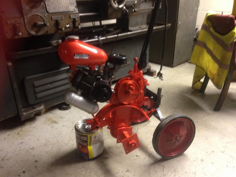

S1g 579 #17 Posted February 20, 2017 Engine has now been trial fitted and the exhaust has had a coat of VHT silver. 4 nigel, pmackellow, Cub Cadet and 1 other reacted to this Share this post Link to post Share on other sites

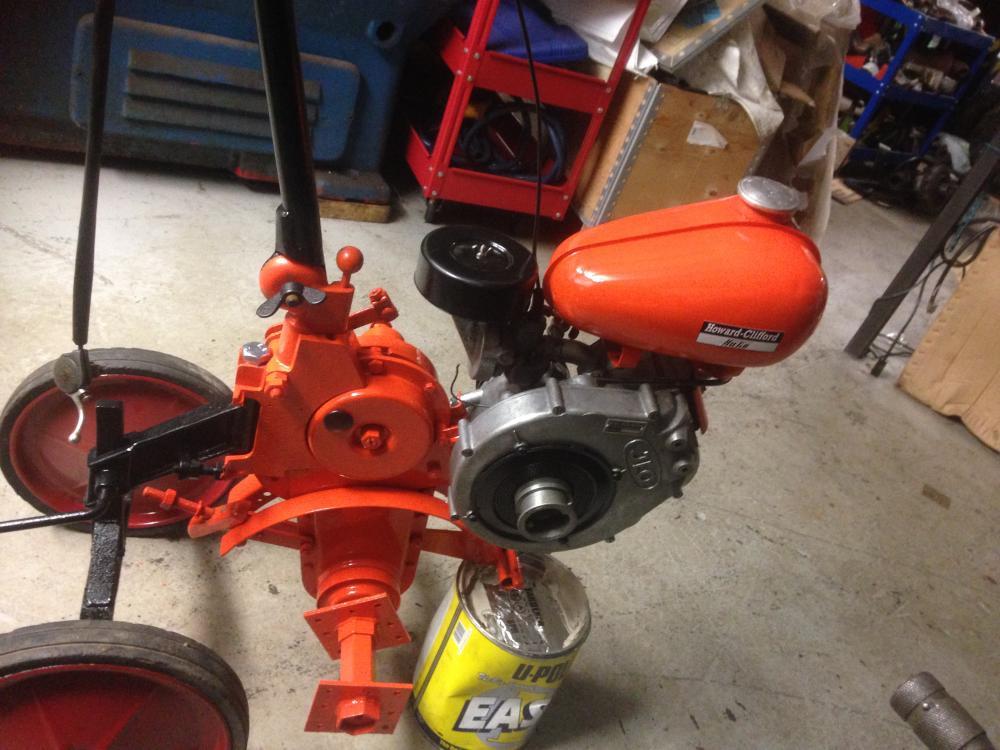

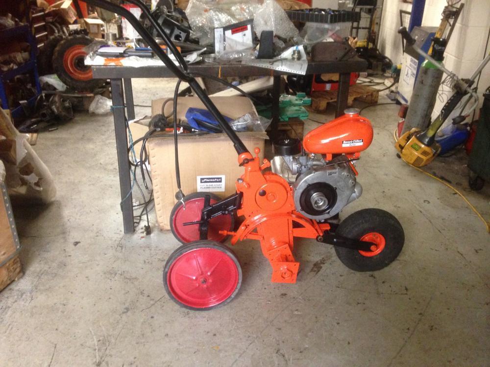

S1g 579 #18 Posted February 28, 2017 Managed to make a bit more progress today, sorry for the poor quality photos, as I only had my phone with me. 5 nigel, Stormin, Cub Cadet and 2 others reacted to this Share this post Link to post Share on other sites

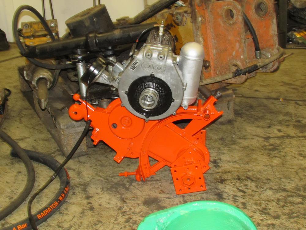

S1g 579 #23 Posted March 1, 2017 Went to work early this morning and fiered the engine up. Started on only the second pull after being rebuilt about three years ago and not touched since. Was going to upload a video but my internet is so slow. It gave an estimated time of 18 hours for a video just over a minute in length. Share this post Link to post Share on other sites
S1g 579 #24 Posted March 1, 2017 heres a photo. 4 Alan, Cub Cadet, Stormin and 1 other reacted to this Share this post Link to post Share on other sites
